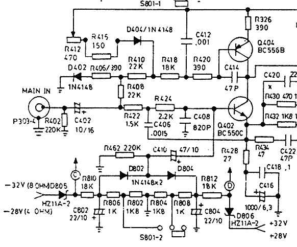

lumanauw said:The input differential pair is pair of Q201-Q202.
There are 2 sets of back to back diodes, one set is between the bases and another set is between the collectors.
Are these 2 sets = "soft clipping"?
It decreases gain of the differential stage affecting feedback, when overload protection starts working. Far from soft clipping.
is this soft clipping? If the voltage is 28V (4ohm). Switch S801 is on (connected). Anode of D802 will be sitting at about -0V9 and katode of D804 sitting at +0V9.
If the dioda D802-D804 conduction is 0V6, then there is limit of -1V5 to +1V5
If the input signal at base of Q402 more positive than +1V5 or more negative than -1V5, then it will be "absorbed" by C410, signal bigger than +1V5 and smaller than -1V5 will not enter the Q402's base.
Is this soft clipping?
It is kind of compressor, it adds distortions after output of the amp shows some voltage close to the certain level.
lumanauw said:is this soft clipping? If the voltage is 28V (4ohm). Switch S801 is on (connected). Anode of D802 will be sitting at about -0V9 and katode of D804 sitting at +0V9.

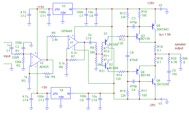

I like your input limiter with indicator. However I think it would be a nice idea as for any clipping indicator to add some kind of monostable at the op-amp output. It would make the LED lighting last longer than the clipping (say 1/10 s) and would show how we can often be unaware of short clipping. Without monostable, the LEDs may flash so shortly that it remains almost invisible.

forr said:Hi Wavebourn,
I did before, but later found that it's practically enough without any capacitors/latches/monostables. Short flashes of high intensity red LEDs are well visible.

Passive Adaptive Soft Clip Circuit
I don't have a drawing right now. This circuit employs diodes in both directions shunting the input signal after it has passed through a 1 K resistor. Each diode is returned to a source of reverse bias of the appropriate polarity. The magnitude of the reverse bias is arrived at by filtering the power supply rail quite well, scaling it down to an appropriate level (with a calibration adjustment), and subtracting off a diode drop. This results in purely passive clipping action, the onset of which adapts to the available rail voltage. This results in soft clipping that does not compromize significantly the dynamic headroom of the amplifier.
The diodes are realized with the collector-base junction of a 2n3904 transistor (base and emitter shorted).
In practice, the calibration pot is first set to provide a fairly high clip threshold. The amplifier is then driven just barely into clipping into an 8 ohm load. The pot is then adjusted so that the soft clip circuit just starts clipping before the amplifier itself, as seen on an oscilloscope.
Bob
lumanauw said:
Hi, Bob Cordell,
Thanks for the info 😀
What is a soft clip cct in input of feedback amp looks like? Do you have a drawing of this?
Bob
