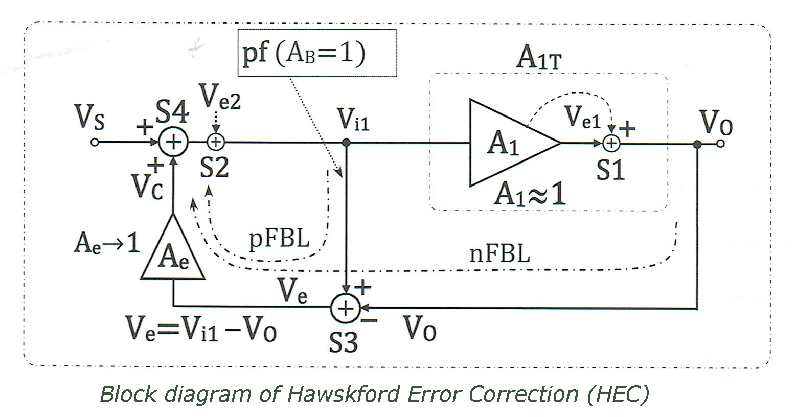

Coming in very, very late, I just wondered whether Edmond has finished his amp to compare it against the Cordell solution.
Reason to post is that the circuit used by Edmond IMO is far superior from a practical point of view, because there is no need for any trimming and because of no thermal sensitivity.
Bob Cordell used Hawksford Error Correction (HEC) as a solution to reduce THD, while Edmond Stuart used Active Error Feedback (AEF).
See the first figures below for the difference between the two.
For the HEC version you have to meticulously tune low tempco resistors to get exactly a compound gain of 0dB for the circuitry around Amplifier A1, but result can be quite good.
THD distortion reduction drops very rapidly when not tuning very secure, not the easiest thing to do.

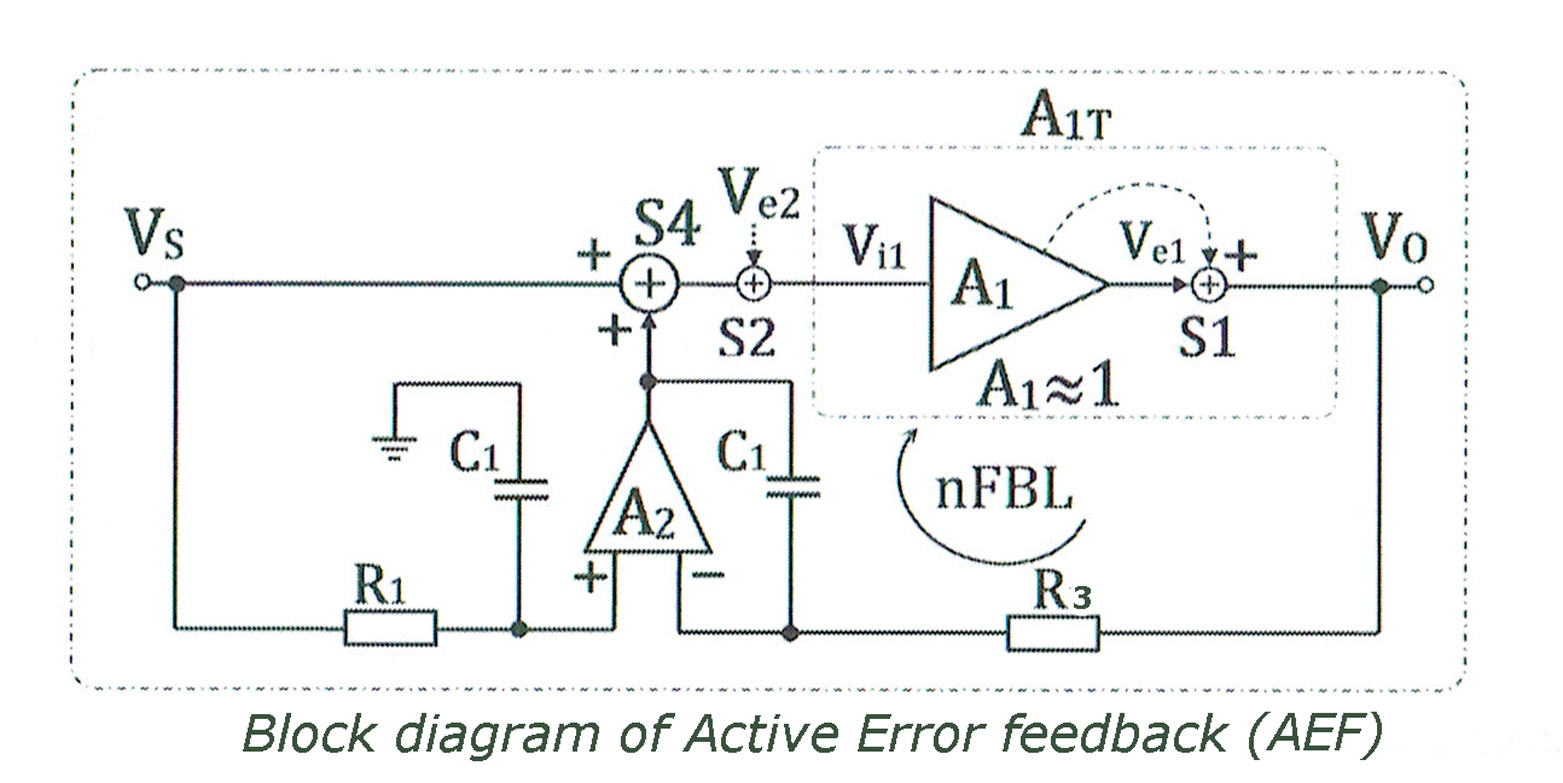

An AEF on the other hand needs no tuning at all and relies on high gain stage, in the figure below represented by amp A2.
Only the BW of A2 has to be taken care of, to prevent a bulge at the high end of the FR.
In Edmonds circuit diagram this was t3=R3*C1
And also t2=R2*C2 should roughly be equal to t1=R1*C1, where C2 in the effective input capacity of the Mosfet and R2 the gate resistor.
But this is not critical, a match of 10% is more than enough.
When inserting a pot between the junction of R3 and R13 and Out, the bulge could be trimmed depending on the gain of the output transistors, but this is also not critical at all.
See the sim below for a gain of 0.85, where 500R should be used for R3 and for a gain of 0.95 where 1k7 should be used to get a bulge-less FR.
But in case of 0.95 gain and 500R, the bulge at 4Mhz is still below 1dB, that's how low the sensitivity is.
Without any trimming at all, results in the audio range should be fully comparable to an optimally tuned HEC.

Hi Hans,
This is a very good question, and I wish Edmond was still on DIYaudio. I don't recall much of the detail that distinguished Edmond's AAF, but the diagram you posted looks pretty much like the technique that has been around for a very long time, where it turns out that extra conventional NFB loop gain is put around the output stage. Interestingly, if one analyzes HEC in a particular way, it also just adds more NFB around the output stage, just in a somewhat different way.
For all such schemes, it comes down to implementation in the real world and stability. I don't recall if Edmond actually built and measured his amplifier.
It is also important to realize that for situations where the distortion of a power amplifier is 0.001% and under, simulations become less accurate in predicting distortion, due to imperfect transistor models and the absence of many parasitic elements in a real implementation.
One thing that many people do not understand about HEC and the way I implemented it is that it really does not need trimming to realize most of its effectiveness in the real world. It is nice to have the trimmer ability, but in most cases that setting will be found in development and the trimmer replaced with a 1% resistor.
If you have not, I urge you to read my JAES paper, "A MOSFET Power Amplifier with Error Correction", a PDF of which is available on my web site at cordellaudio.com.

Hi Bob,
What a nice surprise hearing from you.
I don't want to go in the sort of hectic discussions as seen in this thread, but I have two reactions:
1) Hec MUST by definition have a gain of 1.
The fact that your amp works fine with 1% resistors is most likely because you did all the work in advance to find out the perfect values, but I remember a posting from Syn08 who had to use different values for optimal results, possibly because he used different trannies. With AEF this will have no impact.
2) Simulations are as reliable as the models of the used components as you are well aware of.
But building various amps, sim and build always came remarkably close in my case, as long as THD is above -120dB.
It is easy to simulate a 0.01ppm Amp but almost wishful thinking to realise.

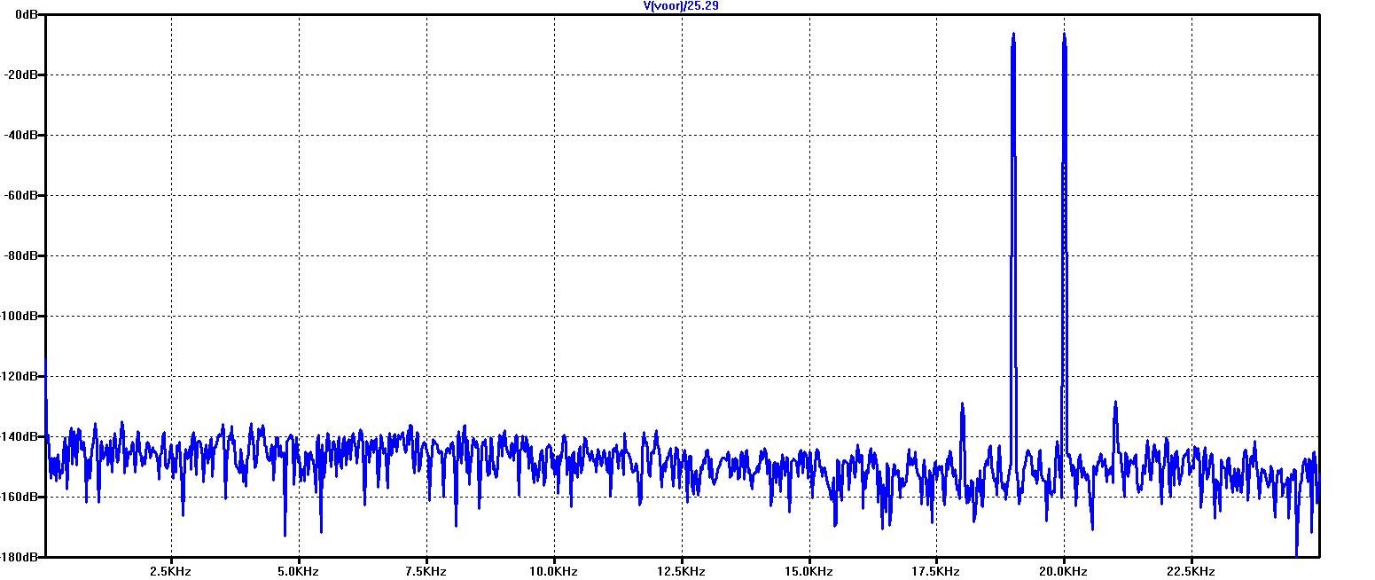

As an example I show an IMD Measurement at the left and Sim at the right of my 100W@8R Main Amp, equipped with AEF, both images at 80W@8R.
White noise was added in the LTSpice Sim simulating the input noise to get a result as close to reality as possible.
Remarkably close, true ?

HEC has the additional handicap that the correction element needs to have a very accurate gain, which is the ultimate limit to the correction that can be attained. Plus that the correction element needs a bandwidth (much) larger than the correction bandwidth. Been there, done it, got a patent, been laughed at ;-)
Jan
Hi Jan,
Small correction, with Hec the loop gain is only 1. That you don’t need gain is the beauty of it, but with Aef loop gain is very large. Look at the two images in my previous posting.
That’s why Hec needs meticulous trimming to get 0dB, but with Aef no trimming is needed at all.
Hans

Bob
Hi Jan,
Hans
I would definitely not use the word "meticulous" to describe the trimming.
In fact, as I mentioned earlier, once the correct value is found from trimming, one still achieves great results without the trim as long as the design still uses the same circuit and components. The 30:1 reduction I got suggests that one only needs to get within about 3% anyway.
The trim is trivial to do as long as you have equipment good enough to see the low distortion that results. Back in 1983, it was quite a challenge for me to see 0.0006% THD+N in a 200 kHz measurement bandwidth. I would love to have had a spectrum analyzer that could go to 200 kHz with good dynamic range back then. I used the essence of the Distortion Magnifier back then to do the measurements.
Bob
Hi Bob,
Hans
Excellent work, Hans!
