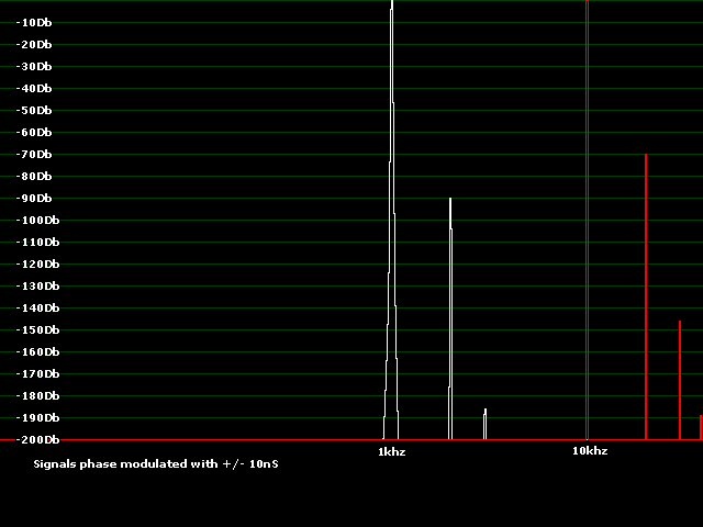

A closer look to phase modulation
I coded a small program applying phasemodulation of +/-10ns to a single sine wave signal and fft'ing the result. 10ns sounded so small ! But look at the reality what 10ns phase modulation does to a signal...
(I doublechecked, it's really only 10ns)
I find it very interesting that this looks very much like typical harmonic distortions from a poweramp.
Is it possible that this kind of distortion is simply part of normal THD ?
The difference to normal harmonic distortion is that these harmonics are phase shifted 90°. This means 2nd harmonic has phaseshift of +/- 180° instead of +/-90°.
In theory, this distortion can easily be measured with a single sinewave, instead of looking only at the amplitude of the harmonics, you need to look at the phaseshift of these, seperating normal unlinearity and phase modulation.
The next interesting question would be: Can the ear tell the difference between harmonics generated by unlinearity and phase modulation ? (Or, is the phasehift of harmonics audible ?)
If yes, we have a problem, if no, this kind of distortion is just distortion, and will be compensated by enough NFB. (Or, is just part of the normal THD)
But, at least one thing seems for sure, 10ns phase modulation has to be taken serious.

Re: A closer look to phase modulation
Good work, Mike
I'd add also: as every distortion should be minimized in open loop

Mike,
Nice work with coding the PIM simulation and showing the spectral result. It looks like 20 ns p-p PIM resulted in a spectral line down about 70 dB, for a distortion magnitude of about 0.03%. Is that right?
Keep in mind that +/- 10 ns is a LOT of PIM. If you look at the measurements I reported in my PIM paper, a 741 op amp at a gain of -10 had PIM of about 4 ns rms. Also, an old 1970's vintage power amp with 20 kHz THD of several tenths of a percent had PIM on the order of 6 ns rms.
At the other extreme, my MOSFET power amp had PIM on the order of 0.1 ns rms, with 0.001% THD-20. Although I'm not trying to suggest a correlation between THD-20 and PIM, one might guess that modern amplifiers with about 0.01% THD-20 would come in at maybe on the order of 1 ns rms PIM. Scaling your results to that would roughly get us PIM-only spectral lines on the order of 0.003%. So maginitude-wise, with admittedly a lot of hand-waiving, the PIM numbers expressed as spectral line amplitudes might be on the order of about 1/3 those of the THD-20.
