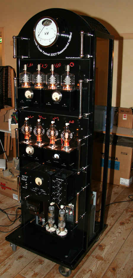

What is it? It looks like a piece of furniture. Very pretty. Perfect for a cold winters evening.
Couple of 100 watts / channel, class A. Uses transmitter tubes. Supply voltage around 5kV. It's an audio power amp. More pictures at www.triodefestival.net

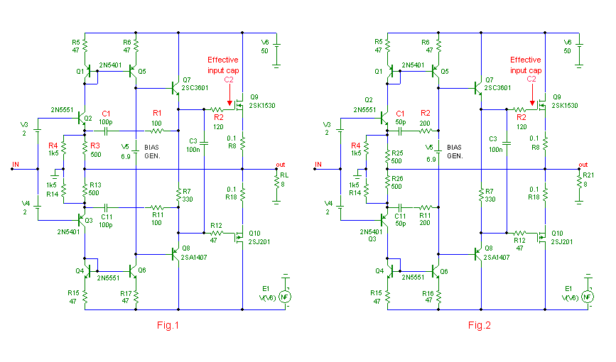

It seems that some people have not clearly understood how my NFB output stages works. To let them gain more insight, I've put here the transfer functions.
There are two versions (see fig. 1 and 2), which differ only in the way of compensation, but perform identically.
It's also possible to give both versions some gain by adding R4 and R14 (see also R47 and R48 in post 2965)

Clearly these functions represent a second order system, which also explains why under certain circumstances there exists a small gain bubble of 0.5...1dB at around 3MHz. But if a < ~0.85 or, more realistic, if the close loop gain is > ~1.2 (depending on the actual component values), this bubble has completely gone as well the accompanying overshoot. It should be noticed that the gain bubble in a complete amp is masked by other roll off mechanisms.
For best performance, set t1 = t2. This compensates for the pole created by the source resistors by a corresponding zero of the Miller compensation.

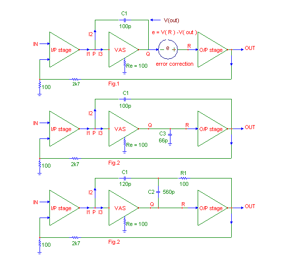

It’s getting quiet here, so it is time to stir the pot again with further reflections on HEC.
For a long time I considered HEC (and my own NFB variant too) as a hoax and an obsolete kludge. Meanwhile, I’ve changed my mind, but first let me explain why I think it’s a kludge and next why I think it is still a valuable an useful technique.
Looking at fig. 1 we have a typical amp, consisting of an input stage, VAS plus Miller compensation, EC unit and an output stage. The EC stage is supposed to correct the distortion of the output stage in such a way that the voltage at point Q, the VAS output, is exactly equal to the output voltage, V(out), right?
In other words, the right leg of the Miller cap (C1) sees the same voltage as V(out). So, why not tie C1 directly to the output (as Cherry did)? Shouldn’t such an arrangement have the same performance, because the only difference is that the VAS output is exposed to Vout plus a tiny error voltage (Ve), in stead of Vout alone.
If we ignore stability issues for the moment, and assume a sufficiently high gain of the VAS or a high enough output impedance, this error voltage has a minuscule effect on the VAS input currents, in particular I1, as this one is dominated by I2. So, theoretically, one might expect the same performance.
In real life the VAS has not only a limited current gain, but more importantly, also a limited voltage gain, mainly caused by the emitter degeneration resistor Re. Furthermore, as recommended by Cherry, the VAS output is loaded with additional ‘stopper’ caps between the base and the collector of the drivers. These are the main contributors to a less than perfect performance. But to what extent?
Let the impedance seen at the VAS output be Zo, at 20kHz, mainly determined by C3, as the output impedance of a decent VAS and input impedance of an OPS are considerably higher. Let’s further suppose that the current gain of the VAS is high enough so that we can ignore I3 and the current delivered by the input stage (I1) equals I2, which is Vout*2*pi*f*C1, btw.
Now, the error voltage at point Q create an error current Ve/Zo, which also appears as an error voltage across Re with an amplitude of Ve*Re/Zo, which on his turn is subtracted from voltage across C1, so I2 = (Vout-Ve*Re/Zo)*2*pi*f*C1. As a result, not all distortion has disappeared, but is reduced by a factor of Re/Zo.
Here are some numbers from an amp with vertical MOSFETs and an ideal VAS (current gain = 10000) and an ideal input stage (gm = 20mS). The conventional Miller compensated amp (fig. 1 without EC) gives a THD20 of 173ppm, with a 3rd harmonic as main component.
Fig.2 gives a THD20 of 0.55ppm, with 5th harmonic as main components and an overall THD reduction of 314. Is this reduction in accordance with the ratio Re/Zo as predicted? That’s a nasty job to calculate exactly, but let’s set the mean frequency of the harmonics between the 3rd and 5th, i.e 80kHz, then Zo is roughly equal to the impedance of C3 = 30kOhm, so Zo/Re = 300. Hmm… not bad compared to 314, and, compared to HEC, ten times better.
These figures are of course to good to be true. Mainly because this compensation scheme is highly prone to oscillations. However, the same applies to HEC, unless we use a kind of compensation, i.e. to let the correction roll off above a safe frequency, in practice at about 3MHz.
We can apply the same kind of roll off to Cherry’s scheme, called TMC, see fig. 3. Opposed to fig.2, this arrangement is stable, also in terms of driving a capacitive load, in the order of 20nF. According to my simulations, it is just as stable as HEC, or, compared to a conventional compensated amp, the stability is reduced to the same amount as with HEC.
In this example the transition frequency is set to 2.5MHz, giving an THD20 of 10ppm, but if C2 is connected to the emitter of the driver, the distortion drops to 5.3ppm, close to the performance of Bob’s HEC amp.
If this is the end of the story, then certainly one might conclude that HEC, and of course its my NFB nephew too, is a kludge, as about the same performance can be achieved by just one additional R and C.
BUT this isn’t the end of the story because we can apply both of these techniques at the same time to get an even lower distortion or if sub ppm figures are not the main target, we can lower the transition frequencies of HEC and TMC to get more stability.
The astute reader will notice that in the past I had a different opinion about combining these techniques, but that was based on the assumption that one cannot correct an output stage which is already corrected. While theoretically true, in practice not all distortion is removed by either HEC or TMC (due to the bandwidth limitation), so what is left over as distortion from HEC can be further reduced by TMC.

To summarize, Edmond,
You started out wanting to show that deriving the VAS feedback directly from the o/p (rather than prior to the o/s stage in a conventional VAS) will produce as good as or better distortion performance than a conventional VAS combined with localized NFB around the o/p stage. This was what you meant by "HEC hoax" - that HEC is an inferior topology.
Now you have concluded that using a nested FB arrangement with localized NFB around the o/s stage contained within the VAS FB loop is even better.
Is that right?

Hi Brian,
Yes, except that (in a previous post) I meant by "HEC hoax" something different, i.e. HEC is equivalent to NFB.
This time, I was wondering in how far HEC and the NFB variant is a kludge as both can be replaced by TMC.
Indeed, I have concluded that using a nested FB arrangement with localized NFB (or HEC) around the o/s stage contained within the VAS FB loop is even better.
That's right.
Cheers, Edmond.
Edmond,
Ok, I concur with your original hoax opinion as you know. Looking at your nested FB idea, there may be a generalization to it that might or might not be useful. Your latest idea has the the o/p node as the NFB sense point for the localized o/s NFB, and the VAS stage NFB and the global NFB. So, might you be starting to test a hypothesis that all NFB should be derived from the o/p node? Just something for academic interest.

Hi Brian,
That's right, that is, as long as AF is concerned. At HF it is a different story. Looking at TMC for example, above the transition frequency, the compensation reverts to the traditional Miller scheme.
The same principle applies to my NFB-OPS. At AF, the feedback is directly taken from the output, while at HF it is more or less overruled by feedback from the emitters of the drivers.

analog_guy said:See my latest post under "Power Amp Under Development" for photos and more details.
The amps utilize a single point EC topology in which the VAS stage drives a low power follower to provide a reference voltage that is then compared against the amp's output. The use of a 100+ MHz opamp as the EC amplifier stage guarantees sufficient BW to accurately compute the EC voltage. A simple resistive divider serves as the summing junction to feed the output stage. The output stage consists of a pair of VBE multipliers driven at their center point. The offset voltages formed thereby set the bias voltage and idle current for the succeeding pseudo darlington consisting of lateral FET devices.
With +/- 70V rails and a 650 va transformer, I have been able to obtain in excess of 400W/ch into a 4 ohm load.
I plan to write up the design in detail and publish it in the "Audio Express".
Sounds interesting! I did not see a schematic over on the other thread. Can you post one here, at least of the EC output stage, so we can discuss it?
Thanks,
Bob
I think this is the simplied schematic:
http://www.diyaudio.com/forums/showthread.php?postid=1230139#post1230139
The discussion start a few pages earlier in this monster thread😀
Klaus
Klaus
