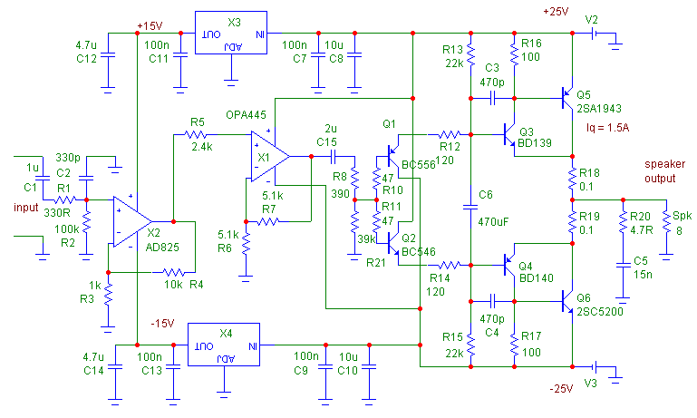

feedback - no feedback test
With regards to the feedback / no feedback PIM test, the following can be done.
Assume the amplifier under test – no feedback – has a transfer function A(s) with a DC gain A(0) = Ao. Now we put in front an ideal stage of gain Aa (we assume it independent of frequency in the range of interest) and close the feedback loop with a factor B. System gain is now:
G(s) = A(s).Aa/(1 +A(s).Aa.B)
We want to make G(0) = Ao so system gain matches the original bare amplifier gain. Given an arbitrary selected value for Aa, then we can solve for B:
B = (Aa –1 )/Ao.Aa
And substituting:
G(s) = A(s).Aa/(1+(A(s)/Ao ).(Aa-1))
It may be easily verified that G(0) = A(0) as required.
In this conditions, the output level will be exactly the same for equal input levels, both for the bare amplifier and for the compound amplifier with feedback, implying internal signal levels for the amplifier under test will also be the same, the only difference being its actual input signal is not the original test signal alone but the composite of the test signal and a correction term.
Due to feedback, system frequency response will change as poles are moved around as expected, and transfer error will be attenuated by an amount approximately equal to A(s).Aa.B as noted in the previous post .
But the amplifier will be operating essentially under the same stress as if alone, and the distortion mechanisms will be the same.
Rodolfo

Re: feedback - no feedback test
B = (Aa –1 )/Ao.Aa
And substituting:
Rodolfo
Rodolfo,
This was what I had in mind, although you explain it much more concise than my feeble attempts. I presently am experimenting with a non-global feedback amp with 30dB gain, so one of the building blocks I have available.
Something to try out for me!
Jan Didden

Hi Jan,
This could be an interesting experiment. The "ideal" front amplifier could be an OPA 134 or LM4562 in an Aa=40 dB gain configuration for example, to have a meaningful increase in gain yet not introducing too much additional auxiliar amplifier distortion. Layout should be tricky with regards to stability etc.
As results I place my bets in a lower overall distortion level with a different spectral structure because of the added correction term, in comparison with the test amplifier alone.
Rodolfo
