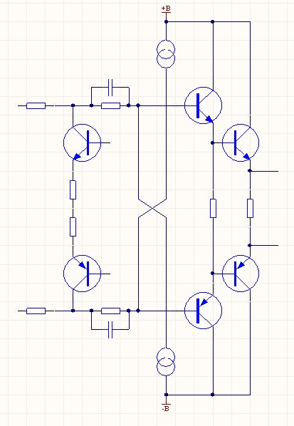

andy_c said:
Yes, I agree - which is why I put the MOSFET disclaimer in there 🙂. I guess the tradeoff here is that with BJTs it looks like you need supply-referenced EC circuitry like what you have on your pages. Otherwise, it seems you could run into a problem with "Vce crowding" of the EC diff amps.
True, but Hawksford’s “figure 5” circuit (from his EC paper) as modified slightly by Bob for his vertical MOSFET output stage can be easily modified to avoid this problem when used with BJT outputs.
The circuit modification I came up with puts an additional pair of resistors in series with the existing pair of collector resistors for the EC circuit, with the EC BJT collectors connected in between. The resistors on the output stage side are each bypassed for HF with capacitor and a constant current is forced through them by returning the base of each EF driver transistor to the opposite supply rail via a constant current source. Now the collectors of each EC transistor idle at +/-5V with respect to the output with no load current.
Glen
G.Kleinschmidt said:True, but Hawksford’s “figure 5” circuit (from his EC paper) as modified slightly by Bob for his vertical MOSFET output stage can be easily modified to avoid this problem when used with BJT outputs.
This sounds interesting. I'd like to see the schematic when available, as it seems like you may have changed it since the last time I saw it. I'm currently getting a "not found" error on your web link button.
Oh no, I actually went with the supply rail referenced circuit in the end as you recall. This was done out of a preference to keep the temperature compensation circuirty independant of the EC circuitry.
Ah, I see. I remember looking at your supply-referenced circuit and noticing that it also eliminated another concern I had relative to EC with BJTs - namely keeping the output stage bias current from being affected by possible drifts in the bias currents of the EC transistors. Of course, MOSFETs have this concern also, but somewhat less so due to the smaller gm.
If you can't fix it - feature it! 🙂 (that is, the low gm of MOSFETs).
G.Kleinschmidt said:Hey, here is a quick drawing of the mod I described.
Thanks for posting that. Now I see why you went with the supply-referenced EC. Bias current stability of the output stage will be much better with your latest supply-referenced EC.
I ended up going with MOSFETs because I couldn't figure out the output stage bias current stability and Vce crowding problems of the EC, both of which you've solved with your most recent circuits.
Actually I think that this circuit still would have been OK, since I am applying the EC to a class A output stage, which is inherently much more thermally stable than a class B stage due to the relatively high voltage developed across the emitter ballast resistors, but I still didn’t like it anyway 🙂
Glen

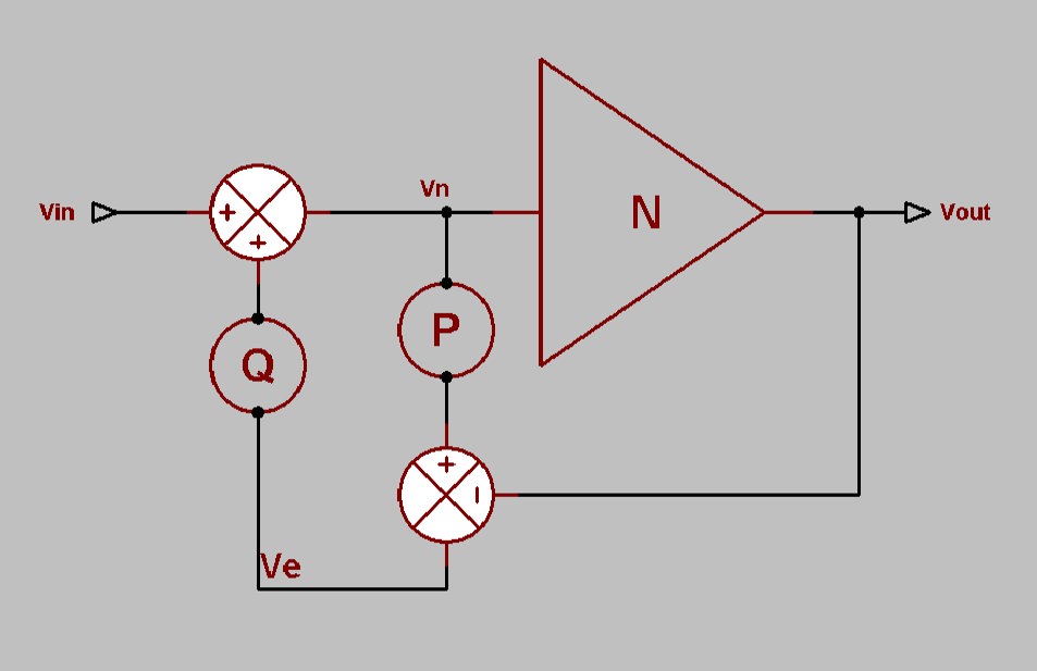

andy_c said:
Hi Jan,
In my present design, I do pick off the input signal of the output stage at the driver input (they are MOSFET drivers). In this way, the EC compensates for the distortion of the drivers as well as the output stage. But without EC, the gain from the driver gates to the output is still very much a function of the load. This is unavoidable.
[snip]
Yes indeed, agreed. The 'only' advantage is to include (pre) drivers in the ec loop.
andy_c said:[snip]This forms a voltage divider network which compensates for the output stage gain being less than 1. Then it's necessary to scale the EC diff amp gain up by the reciprocal of the voltage divider ratio in order to provide the best error cancellation. In other words, optimum EC occurs when the product of the voltage divider ratio and the diff amp gain is 1. If the voltage divider ratio exactly matches the combined driver and output stage gain at some particular load impedance and output signal level, the error signal consists of only distortion, with no fundamental component.
[snip]
Andy,
This is something I have also been looking at. While tuning the attenuator and the compensation gain you can indeed get a distortion minimum, this minimum will most probably not be as deep as when you leave out the attenuator and the compensation gain. In theory, you actually lose the distortion null, but in practise the difference may not be that large.
I guess the attached is the concept of what you propose. If you now work out Vout/Vin you get:
Vout/Vin = N/(1-P.Q+N.Q), with N the non-lin gain block you want to compensate, P the attenuator and Q the compensation gain.
It's obvious that N drops out only if Q=1 AND Q.P=1, so both the attenuator and the compensation gain should always be 1 for distortion cancellation.
Jan Didden
Glen
Also, so as to not compromise the bias thermal stability in a class B or AB design this circuit modification could be used, but with the two bypassed resistors I added replaced with a pair of voltage reference IC's such as LM336-5 or similar.
Glen
