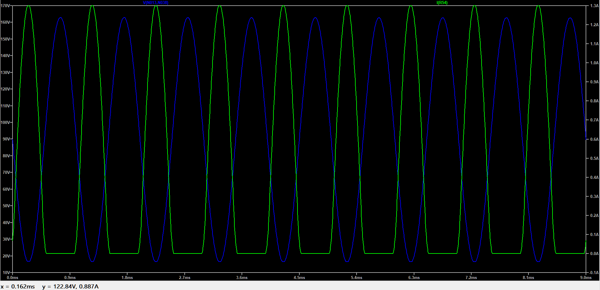

Nice scope dadod!This is my 100W CFA OITPC (OPS serial combination of ClassA and ClassB) clipping, simulated and real amp clipping.
Damir
Just one channel's working, can't find time to repair.Nice scope dadod!

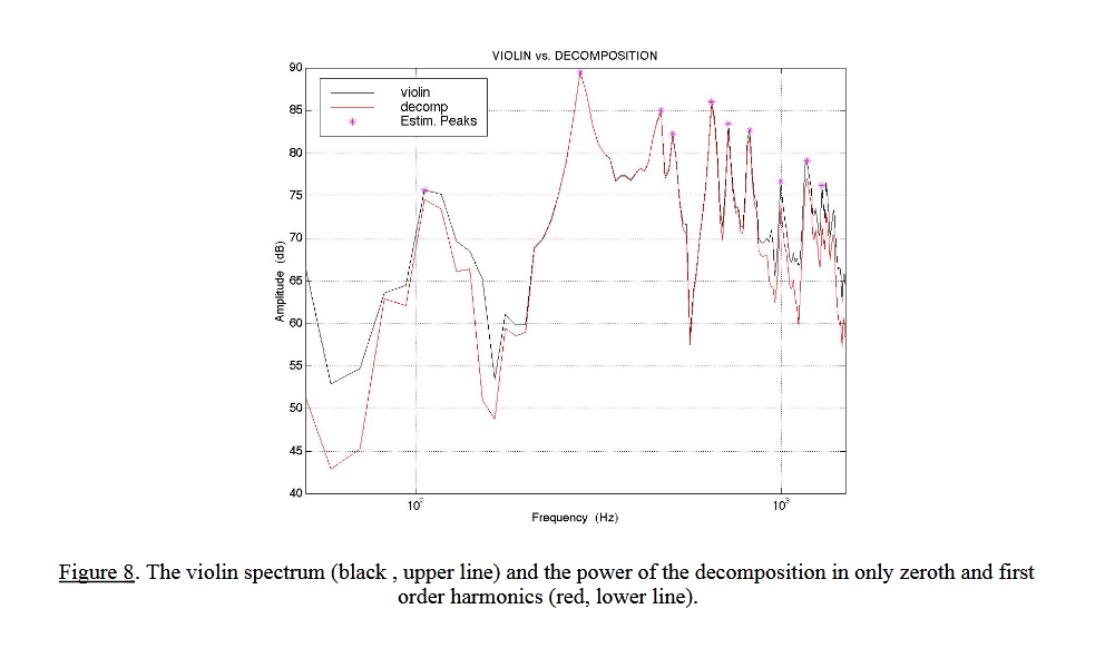

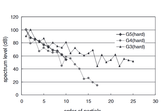

A class A amp usually sound pleasing because of monotonic harmonic profile. But not all class A amp can reproduce good stereo imaging or sound stage. It also not all class A amp can sound good at high frequency, airy sound is hard to reproduce. THD and the harmonic profile of the distortion is not the only thing that affect the sound.
So a monotonic harmonic profile with H2 at -80dB is supposed to sound better than a non decreasing harmonic
profile that has all harmonics being at -100 dB if not at -110dB.?
All while listening to this on speakers having distorsion, both THD and IMD, at something like -46 dB at best..?.
And of course with a musical signal knowing that all instruments produce huge amounts of both even and odd
harmonics that are present with their fundamentals notes and wich are the cause of their specific sonic signatures.
There s something in this "logic" that doesnt sound right at all, actually all people doing such claims have not
the slightest idea of what is the spectrum of a musical instrument, they would know that harmonics have
an amplitude that is so high that it s impossible that say 0.1% THD could change the sound even infinitesimaly,
because harmonics can have an amplitude that is comparable to the fundamental.

FI here the harmonic spectrum of a piano in function of the hardness of the finger touch and the one of a violin
wich produce much higher levels of harmonics than a piano.
