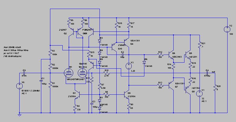

my quick sim of similar sized VAS and follower Qs shows the 1st few distortion harmonics are indistinguishable in the VAS collector vs follower connection of the Ccomp, but at higher frequencies the follower connection has lower harmonics
at all frequencies the IMD from a relatively prime frequency test Isource on the output of the follower are lower with the outer feedback connection
the buffered Ccomp connection reduces the influence of the “feedthru zero” and as Bob has pointed out allows more aggressive 2-pole or “T-compensation” to give greater loop gain in the audio band which hugely reduces slew rate considerations over the audio bandwidth as well as reducing the distortion at the amplifier output caused by nonlinearities of the other global feedback enclosed stages by a greater amount
if your special case is using high input C follower transistors to "buffer" the VAS I'm surprised Miller comp is required at all - doesn't the follower Cin*VAS_gm give enough roll off?
I think most designers would seek out lower Cin VAS buffer/follower Qs for reduced distortion

And here is a quick sim of a relatively basic 10W into 8 ohms class A design (playing The Frayed Ends Of Sanity by Metallica ATM).
THD-20 with the Miller cap connected to the VAS collector:
0.006575%
THD-20 with the Miller cap connected to the driver output:
0.007298%
Interestingly, even if I use high Cin drivers instead of the >100MHz fT ultra low Cob BJT's, the overall THD predicably increases slighty, but the HF THD is still lower with the Miller compensation cap connected to the VAS collector.

You know that in some cases, my sims also reveal that tying the Miller cap directly to the VAS output gives lower distortion. Nevertheless, it sounds counterintuitive to me. Of course, the simulator didn't tell me why, but I think, as there are more sources of distortion involved, that they are partly compensating each other. What about that?

Hi Edmond.
I think that in applications such a VAS driving a double EF where the driver input capacitance approaches or exceeds the value of the Miller compensation cap, the negligible or even negative returns are mostly due to the loss in bandwidth and miller loop gain when the pole-splitting effect is removed by disconnecting the comp cap from the VAS collector.
However, the way the performance swings isn’t 100% predictable even with low Cob driver or pre-drivers, so probably something as you suggest is going on.

Hi Glenn,
I was also a little surprized to see the distortion increase by about 10% when you used the outer connection, but there does seem to be a lot going on that could make the changed connection go either way. In any case, I think that taking your simulation and that of jcx together suggests that either connection tends to make little difference in distortion, which was my only point.
If you are suggesting that the outer connection causes the pole-splitting effect to be removed, I think you may be wrong, as least insofar as the frequency response behavior of the circuitry that includes the EF subsequent to the VAS. We still get an overall dominant pole with a much higher frequency pole.

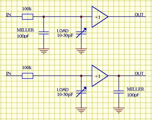

Re: Re: Re: Re: Re: Re: Re: Re: Re: Re: Re: Re: Re: Re: Re: Miller compensation
🙄 Nonsense!
The non-linear input capacitance of the EF certainly does not have the same effect on the open loop frequency response of the stage(s) enclosed within the Miller compensation loop when the Miller compensation capacitor is connected to the collector of the VAS as it does when the Miller compensation capacitor is connected to the emitter of the EF.
Glen

I've attached a circuit diagram of two circuits below.
With regards to the frequency response, IN through to OUT, which one (as a ratio of corner frequencies fH/fL) will suffer the greatest variation when the variable capacitor marked LOAD is varied over its specified range?
