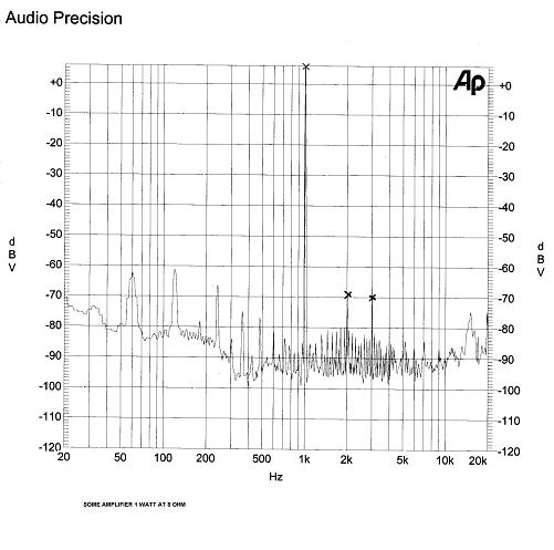

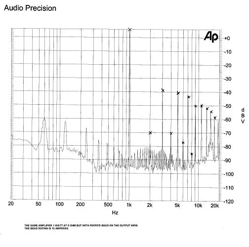

I do wonder if there are some out there who would be concerned about the sound of a ferrite bead in the signal path.
Never ever put it in the sigal path
For those who like to put them - here is the distortion of some amplifier. Output power 1W at 8 Ohms.
It looks like an FFT for square wave or heavily clipped signal. What is the ferrite bead doing?
Hi Dimitri
That is quite a different situation, isn't it?
At mosfet's gate dynamic current should not exceed, say 5mA at normal operation, what's more, in your example ferrite bead is not within feedback loop, so this -50dB harmonics are not so scary.
It is like comparing a bjt emitter follower, which centainly consists of a b-e diode in signal path, to a rectifier.
Hey man, this is 350mA current through 15A rated bead.
Speaking about 5mA, which is 40dB lower, do you need this extra -90dB garbage? Use precious loop gain in optimal way
Is there more data available on that specific bead, preferably a link to a datasheet?dimitri said:Hey man, this is 350mA current through 15A rated bead.

Re: Ferrite Bead in Spkr Line
@Dimitri:
Thanks, lesson learned: Don't use "inductors" with varying inductance vs. current, which is exactly what seems to happen with lossy ferrites, in the audio band. AF is DC current bias from the ferrite's POV. To shield RF from the amp one should only consider common mode type of lossy/nonlinear filters, and even those might be compromised.
- Klaus
@Dimitri:
- Klaus
I haven't found lossy ferrite to measure that bad - I guess there are many formulations and geometries that affect saturation distortion in lossy ferrite parts - you do have to test
My TPA6120 based headphone amp uses a ferrite smt bead core to isolate the cable C, as I recall the distortion at 8 Vrms into 32 Ohms wasn't obvious with my Juli@ card using RMAA
further, even using Dimitri's example the distortion is odd harmonic so it should scale with at least the square of the current -40 dB less current should give -80 dB less distortion for -130 dB and that is inside the feedback loop in a gate stopper application
That is correct. When I put 15 A rated common mode choke (two wires through the same bead) in the same amp I found the same distortion signature but 20-30dB less. Please be aware about the symmetry of common mode choke.
That is correct, jcx. But what will be the peak gate current? Will it cause IMD inside audio band? My point was to warn those of you, who trust measurements. BTW in A/B comparison, golden ears preferred bead. 😀the distortion is odd harmonic so it should scale with at least the square of the current -40 dB less current should give -80 dB less distortion
