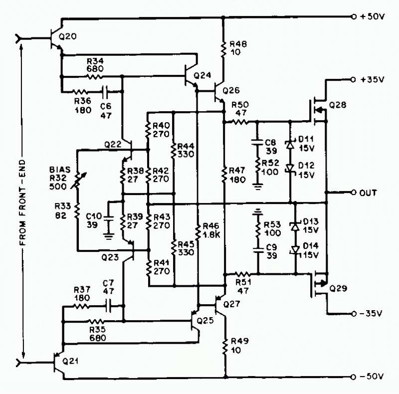

This arrangement is used by Mr. Cordell. Imagine the output transistors are Bipolars, not mosfets. R50-R51 are base stoppers (47ohm). Then after these 47ohms, there are C8+R52 and C9+R53 to ground.
Incase of not using output inductor and not using too big base stoppers, is this R+C to ground after 47ohm helps to overcome negative impedance (when bipolar output stage is headed with capacitive load)?

Charles, when I made my first RET amplifier back in 1980 or so, I first left out the 10 ohm resistors. Then, John Iverson gave me the suggestion to use them, because I was getting random problems. It worked and I was able to get over 500V/us per side, so I never thought much of the value as being too much and it DOES add a positive R which cancels the negative R is being generated by the cap load and the transistor. However, in analysis of beta balance, I found that 10 ohms to be problematic. I would be happy with 4-5 ohms. That would help me, and probably still keep me safe. After all, like you, I don't use an output coil, but I do use a significant amount of negative feedback, so I have to be more careful.
