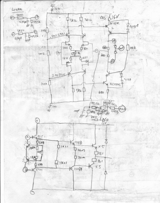

Hi, Mr. Hansen,
This is a non-feedback amp (at least it is what in the brochure said ), but it has servo (TL071) around VBE multiplier to maintain 0Vdc offset. The output stage is biased about 20mV accross the 0.1R/5W resistors. The outputs are 2SC5200/2SA1943, 5pairs.
What is improve-able from this design?
