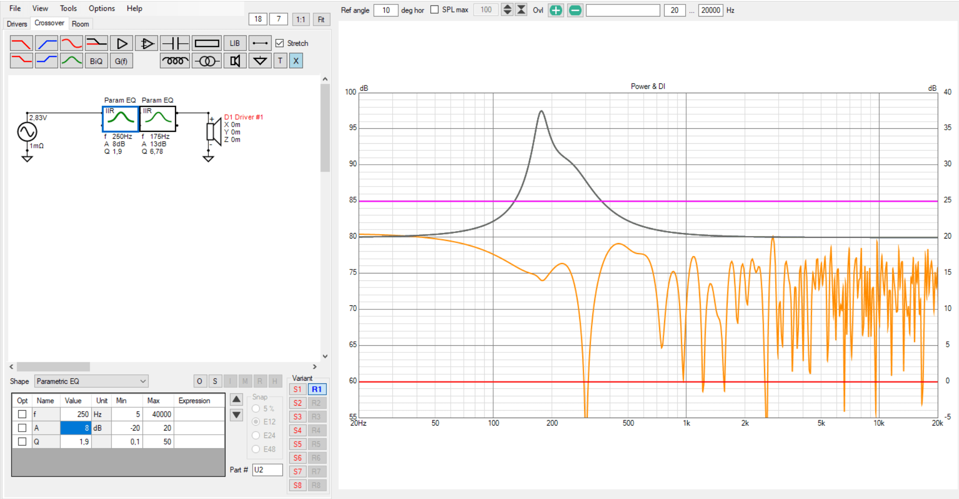

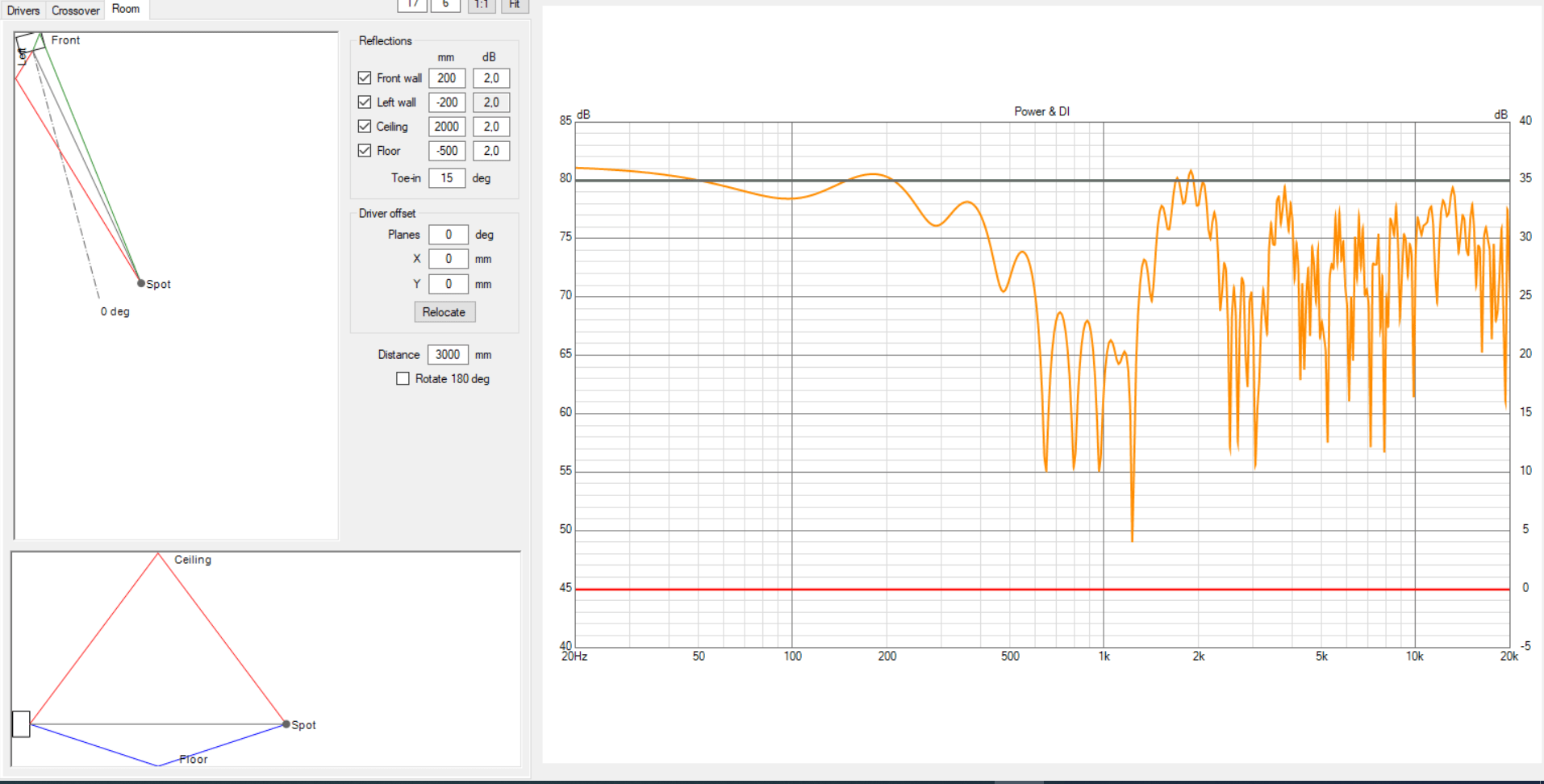

Here is what motivated to post about warmth / relation to boundaries. Its extremely difficult to have as system and then position it so that the whole low mid range is not gone due to boundary interference. This is simulation of ideal point source (omni of course) near one room corner showing some bad interference, flat anechoic frequency response (black) but the whole low midrange is down significantly (orange). Basically the low mids come back only when the source is near boundaries (small speaker), or limits sound towards boundaries (big speaker) so that less of destructive interference happens, or both. Due to physical size of speakers and rooms practical speaker positions tend to accumulate all dips on the low mids, say 150Hz - 1kHz is quite bad no matter what. This is someting EQ does not fix, only building speaker with acoustic output suitable for position it has would.

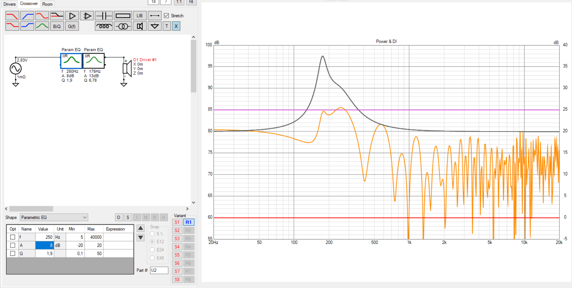

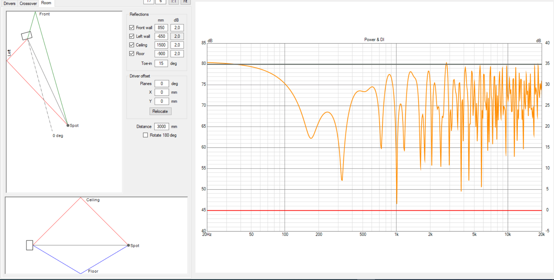

For completeness here is the first above, with some boost EQ added to fill in some of the lost low mids. Then with changing refrence angle a bit, moving a bit in the room, and now the response is wonky again. Point being EQ can't fix issues that depend on location, like position of speaker related to boundary.
