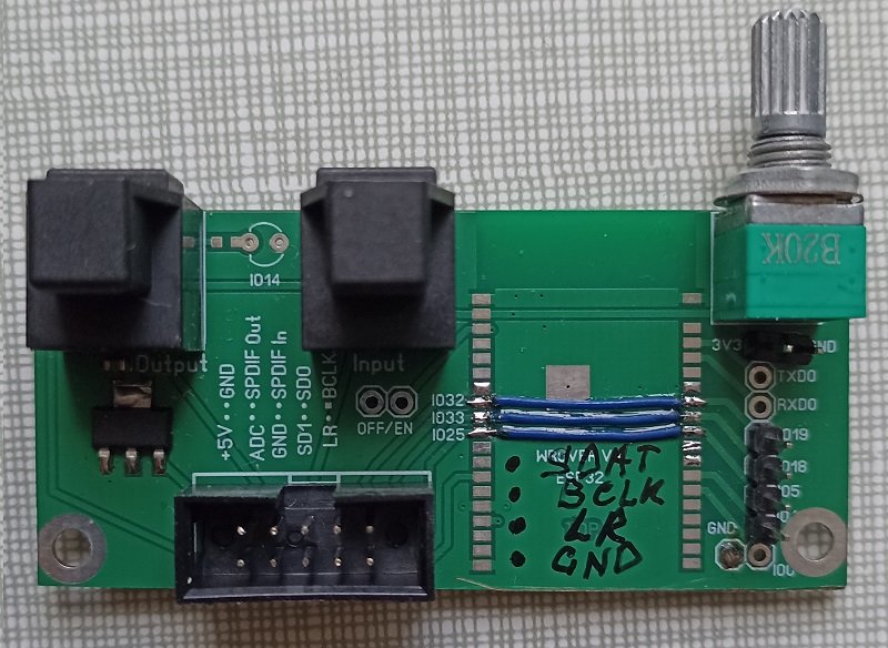

Yes, it is possible and it will work if we combine the grounds of both boards very well and they are located in close proximity in one case.could one use one external ESP32, running Squeezelite-ESP32, and connect the I2S output pins to two of your amp boards? I've never tried to connect one GPIO to two separate input pins.
The thing is that when implementing active three-way speakers, it is optimal to place the boards as close to the speakers as possible. Therefore, when placing the board on (or in) the speaker case, we will have to pull very long conductors to transmit the I2S stream from the I2S source, which requires a good shielded cable, which may still not help and catch EMI. Therefore, to transmit a signal from one speaker to another speaker, an optical channel is used, which is immune to electromagnetic interference. See post number 7.Seems like this would eliminate the latency issues when syncing two WROVER chips using LMS???
Synchronization of channels with a DSP on the board is not a problem at all, the DSP delay is constant and easily eliminated.
I know that some people are wary of the optical channel, believing that it has a lot of jitter, but the ADAU1452 has a very good ASRC that successfully restores the signal frequency, and I do not see a single manifestation of jitter in my measurements. I have the same measured values at the DAC output with both the I2S input and the optical input.
Yes, it is possible if the boards are in the same case and have one power source and good common contact with the case. If the boards are in different places, then you need to use optics from the ESP32 to the boards, or use an isolation transformer to transmit SPDIF to the boards, but if you use a direct signal from the ESP32 to the boards without galvanic isolation over long distances, then there will be problems with EMI and cross currents between the boards and their power supplies, up to a breakdown of the SPDIF input in the ADAU1452.I could also configure the ESP32's digital output as S/PDIF and do the same thing???
So in each specific case, different options for solving a particular problem are possible, if the boards are in the same case and have a common power source with the ESP32, then yes, you can supply one I2S stream to the input of the boards and they will work stably. If they are spread out in different directions and powered from different power sources, then it is highly desirable to use galvanic isolation to supply a signal to two boards installed in different places.

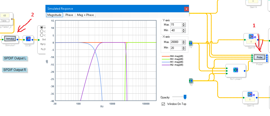

Very Interesting. Does I support FIR filters? If so how large? My primary 3 way system is currently tethered to a pc, I'd love to set it free
Yes, ADAU1452 supports FIR filters both in tabular form and in the library form of sigmastudio. The maximum length of the FIR filter is 10,000 taps.Does I support FIR filters? If so how large?
In this topic, in the first post, there is a folder with files for sigma studio, there is a project called - I2S 3Way FIR 48kHz, there is a library FIR filter used to organize a phase-linear crossover, each filter is 512 taps.
https://www.diyaudio.com/community/threads/3-way-dsp-amp.415065/#post-7734899
By the way, Sigma Studio allows you to simulate filter settings without connecting to ADAU1452. So you can open a project and press two buttons of the stimulus and probe and see the result of the filters.

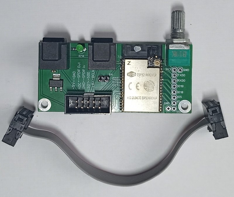

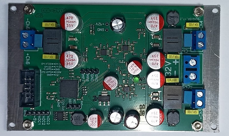

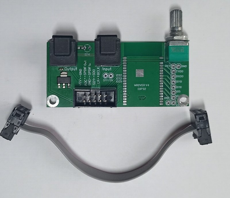

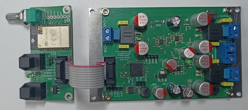

The PDAC and input board look like this.

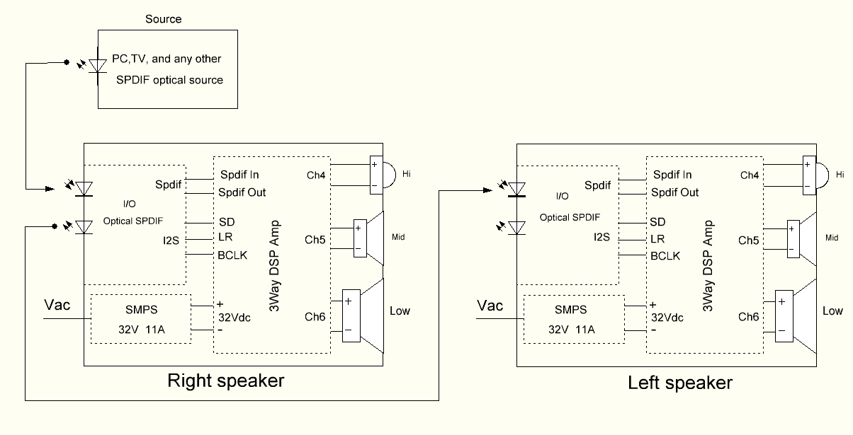

I take it this would require a daisy chain between the 2 speakers?
If we are talking about a stereo three-band speaker system, then the input-output board provides the transit of the SPDIF signal. Therefore, one optical SPDIF output is needed from the computer.I take it this would require a daisy chain between the 2 speakers?
Here is a structural diagram of such a solution.
If you want two independent stereo speakers with an optical input, then you need an optical splitter, which is not expensive. And requires minor modernization to switch the input to the desired output.

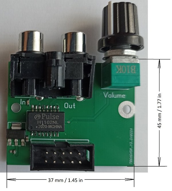

There is also an input/output board with I2S pins for connecting an external I2S source. Price: $10.
