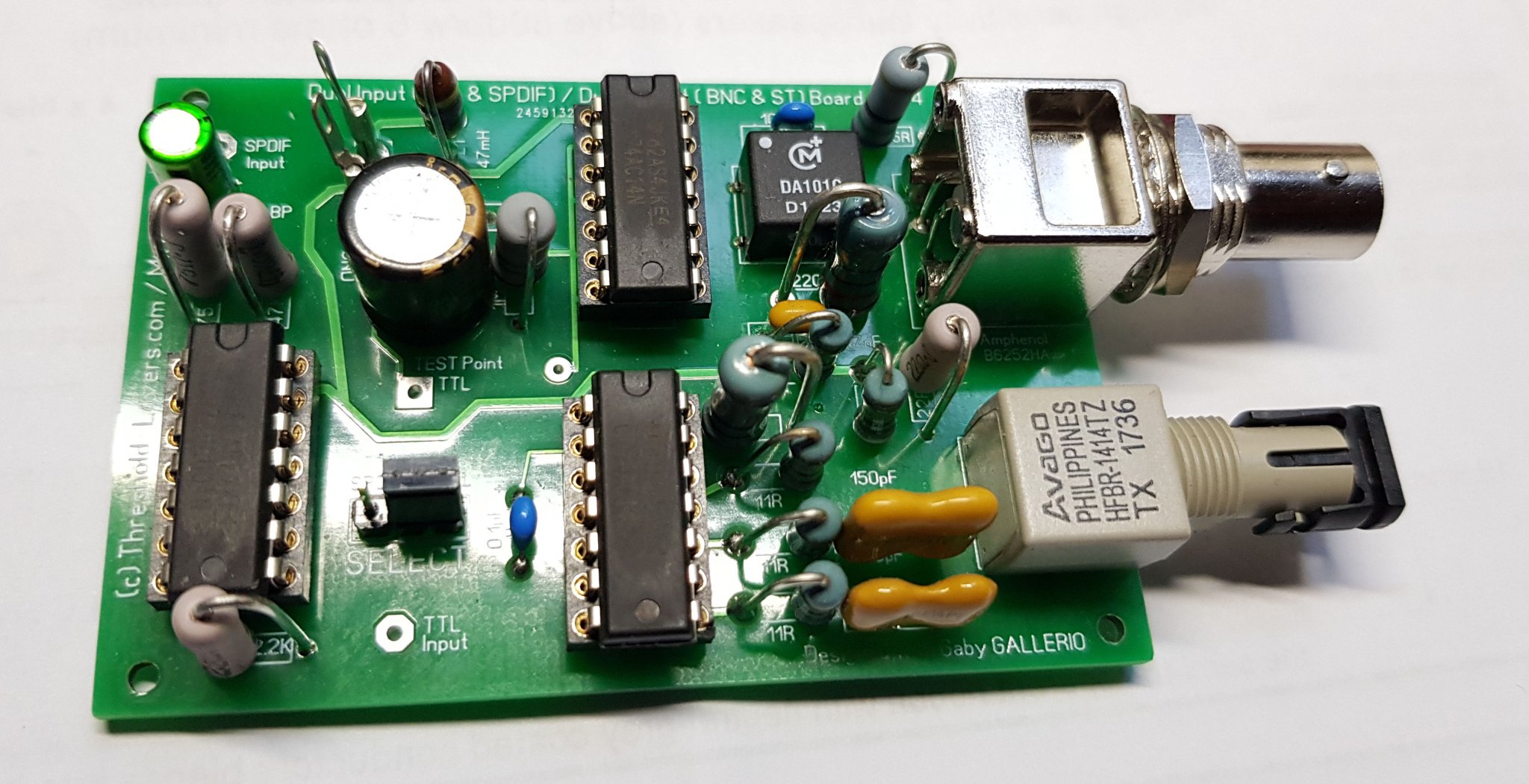

Well, you won't believe it ... but I have found yesterday that I had developed, a few years ago, a board with:
-TTL and SPDIF inputs
-BNC and ST outputs
see the attached photo !...
I still have to find the schematics and PCB in my files, but it is there...
It uses an AVAGO HFBR-1414TZ emitter, because I intended to use it on the modified input of the Wadia (the input having an Avago receiver).
I still have to test my board because I do not remember if my engineer or myself (a friend of mine) had tested it ...
Assuming that this board works OK, my project would be to:
  • have a BNC + Toslink inputs
  • if not too complex, have also an AES/EBU input
  • I will use the existing BNC and ST outputs in a first time, and will try to add a Toslink output when everything else works.
So my first question is:
-suppose that I have a BNC source, can I connect the BNC signal directly to the SPDIF input, or should I add some specific parts between the BNC source and the SPDIF input of my board (or any other board supposed to undertake SPDIF signals) ? I ask this because I am not 100% sure that a BNC input signal is a SPDIF signal ...

If the board has SPDIF in that works, and the objective is to connect it to a CD transport via BNC cable, then I would initially go about it as follows

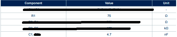

1. Get a 75ohm BNC connector
2. Build the extremely simple circuit from post 22 above (75R resistor, 4.7nF capacitor - cap value can be different if you don't have 4.7nf to hand)
3. Wire BNC in > circuit from post 22 (75R & 4.7nf) > SPDIF in on your board
4. Connect a CD player/transport digital out see if it works
Assuming that your board works that should be all required... If your board already has the circuit from post 22 at the input then don't add it again.
to test your board (which has s/pdif input and BNC output);
set scope input channels to DC coupling, High-impedance mode (1-10 Meg Ohms OK if using 10x probe), turn bandwidth BW limiter off, set triggering to auto level, etc.
set signal generator to square wave, 6MHz (or as close to this as possible, ~1 MHz OK) 50% duty cycle, 600mVpp, 0 DC offset (waveform should cross 0V symmetrically)
connect signal generator to input of your board directly (no rc network needed)
your board's BNC output should be same square wave waveform, but with 1.0Vpp amplitude (or possibly 2.0Vpp depending on implementation) when driving the scope's hi-impedance load.
you may need to increase the signal generator amplitude to 1.0Vpp if no signal at the BNC output
if this works, then board is probably OK, so connect CD player s/pdif digital output to your board, and board ST output to the Wadia ST input.

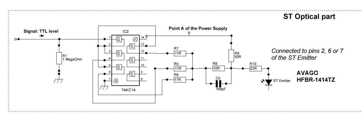

Well, I have spent a few hours to draw back the ST output part: see attached file.
The way the HFBR 1414TZ is connected differs from the official Avago diagram, but I know that this diagram had been optimized to use the 74AC14 circuit.
I have not found more information for the time being.
Have you already seen this diagram with these parts' value ?
I know that it had been published in specialized websites a decade ago, but I have not managed to find it again.
for your circuit using the 74AC schmitt trigger hex inverters, unused inputs (pins 9 & 11) should not be left floating but should be tied to pin 7 (ground).
while both your ckt and the Broadcom reference should work, note that absolute polarity on the broadcom reference schematic is inverted vs yours (broadcom ckt logic "1" input turns IR emitter off). shouldn't make a difference with an NRZ signal, which s/pdif is. Rough calculations show about 80mA steady-state "LED on" current for each circuit.
more interesting to me is the remainder of the circuit, which hopefully will be able to convert a BNC s/pdif signal (1.0Vpp, 0 DC average level) into a TTL level to drive the 74AC portion shown.
Parts of your drawing are reminiscent of the TX circuit in the datasheet but it's not the same
Yes you are right, I know that, and as far as I remember, this circuit was an "upgraded" version of the Avago circuit: but I cannot find where I got it at the time...
If you have reason to think it's a good design that has been optimised then what is stopping you trying it?
Mainly because the board has no regular input connectors for SPDIF and/or TTL: so I will be obliged to solder some wires directly onto the board holes, that is not very clean..
And secondly because I try to verify as many details as possible before proceeding with a test...
you are totally right ! I have checked both the schematics and the board itself:
  • the pins 9 &11 are not linked to GND on the schematics,
  • but they are connected to the ground on the board,
so the physical onboard connections should be OK.
What could be the impact if these pins would be floating ?
you are right again, but I remember that I had been told that it was the best way to engineer it.
Let's say 200mA, so one of my high-end power supply should be a perfect match: they are theoretically able to deliver up to 1A.

So I currently design a new PCB that will have all the standard input connectors (2xBNC, 1xToslink, 1xAES/EBU, maybe an I2S input if I have time to understand it, and a ST input but not required for my own usage) and the standard outputs connectors (1xBNC and 1xST) already present on the existing board.
This new PCB re-use the existing board we are talking about, and will have the abovementionned inputs with the proper onboard connectors.
I have already built the 5V power supply to feed all these folks.
The priority remains to test the existing board, which sadly does not have the clean input connectors.....
there are two other IC's plus other parts, what IC's and how are they connected? I recommend testing that circuit as-is by soldering some wires from the pcb holes to an off-board connector to verify the functionality of the circuit, then after its debugged, design another board with pcb-mount thru-hole connectors.
