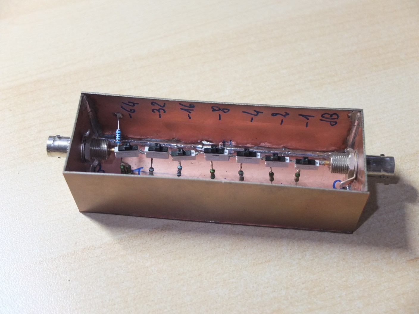

Hello Andrew,
Maybe, the most multi-purpose solution is a stepped attenuator as Elevee show.
I've made a DIY one, for nearly nothing. The full enclosure is made with some
epoxy copper clad soldered together.
I use it very often with my instruments.
It looks like this :
The range is 0 to -120 dB in 1dB step with 7 switches.
I used only standard MRS25 resistors, so the HF response is not so good than real RF attenuator.
Anyway, even with 120db attenuation, the error at 100kHz is very low. Sufficient for my use.
(I would love to build a better one, many idea about that, but already too busy by others projects!).
The Zin is 1k constant and Zo is between 0 to 470 Ohms.
You can compute all value and choose Zin or Zout constant using this
very good on-line calculator HERE.
Hope that will help you 🙂
