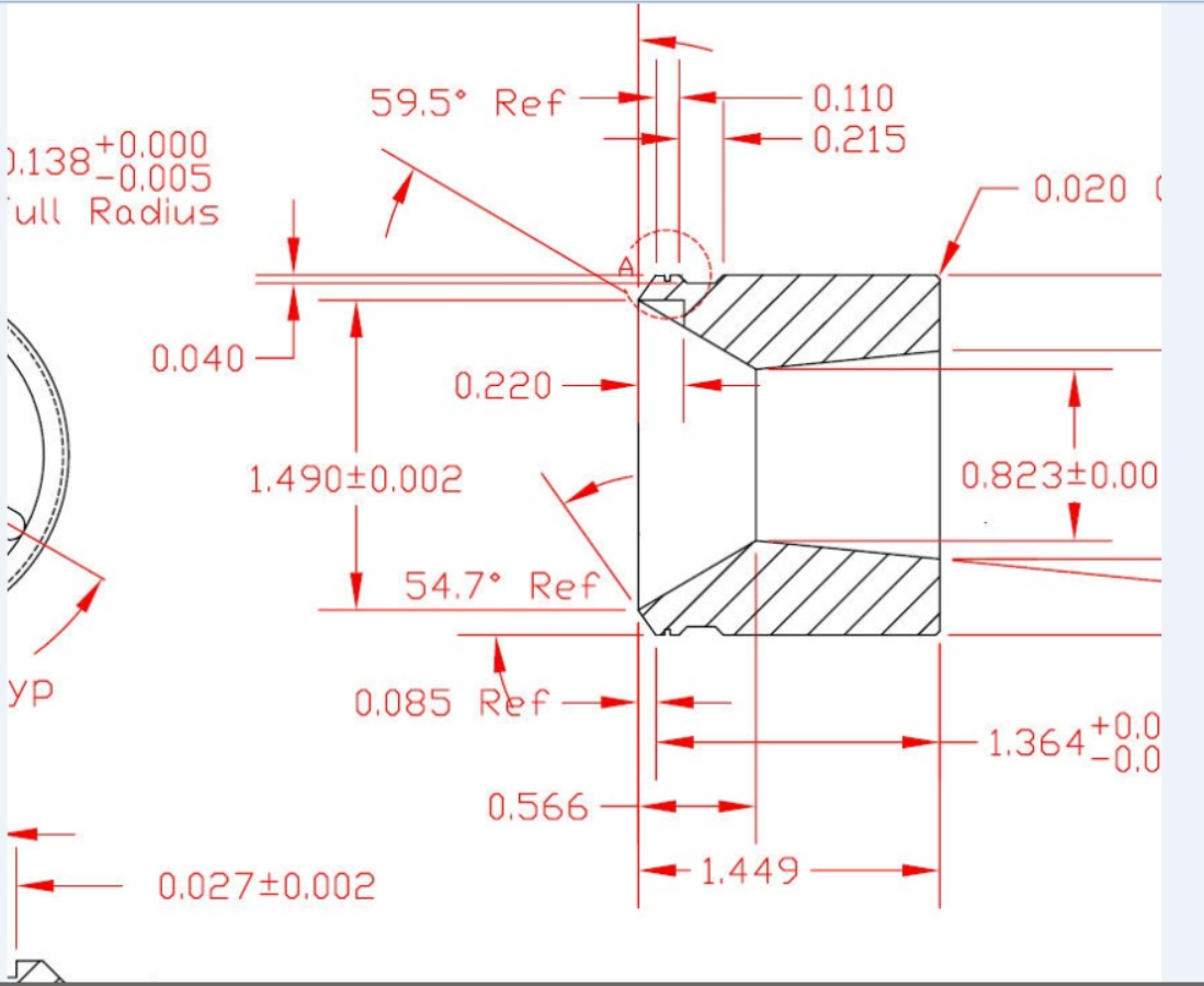

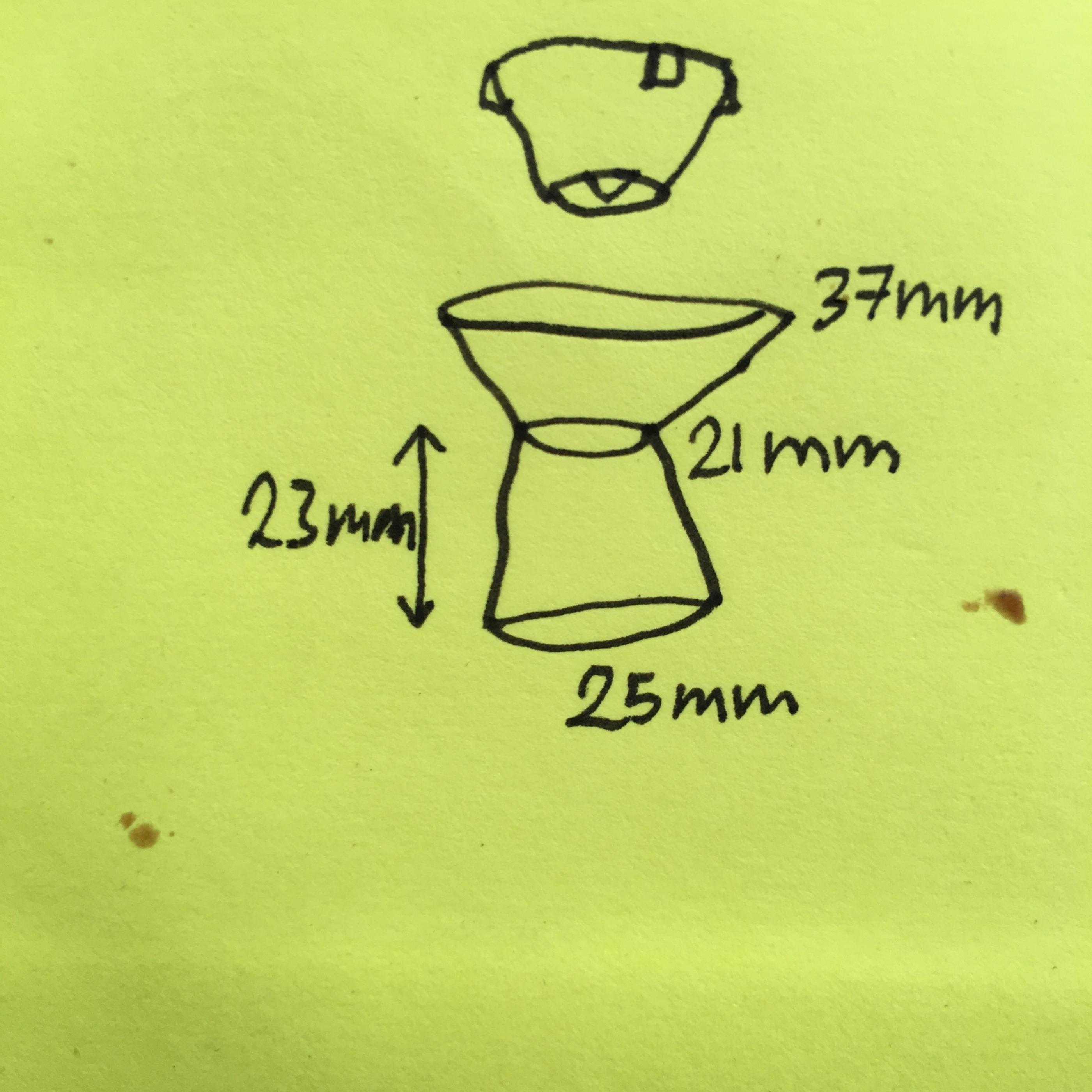

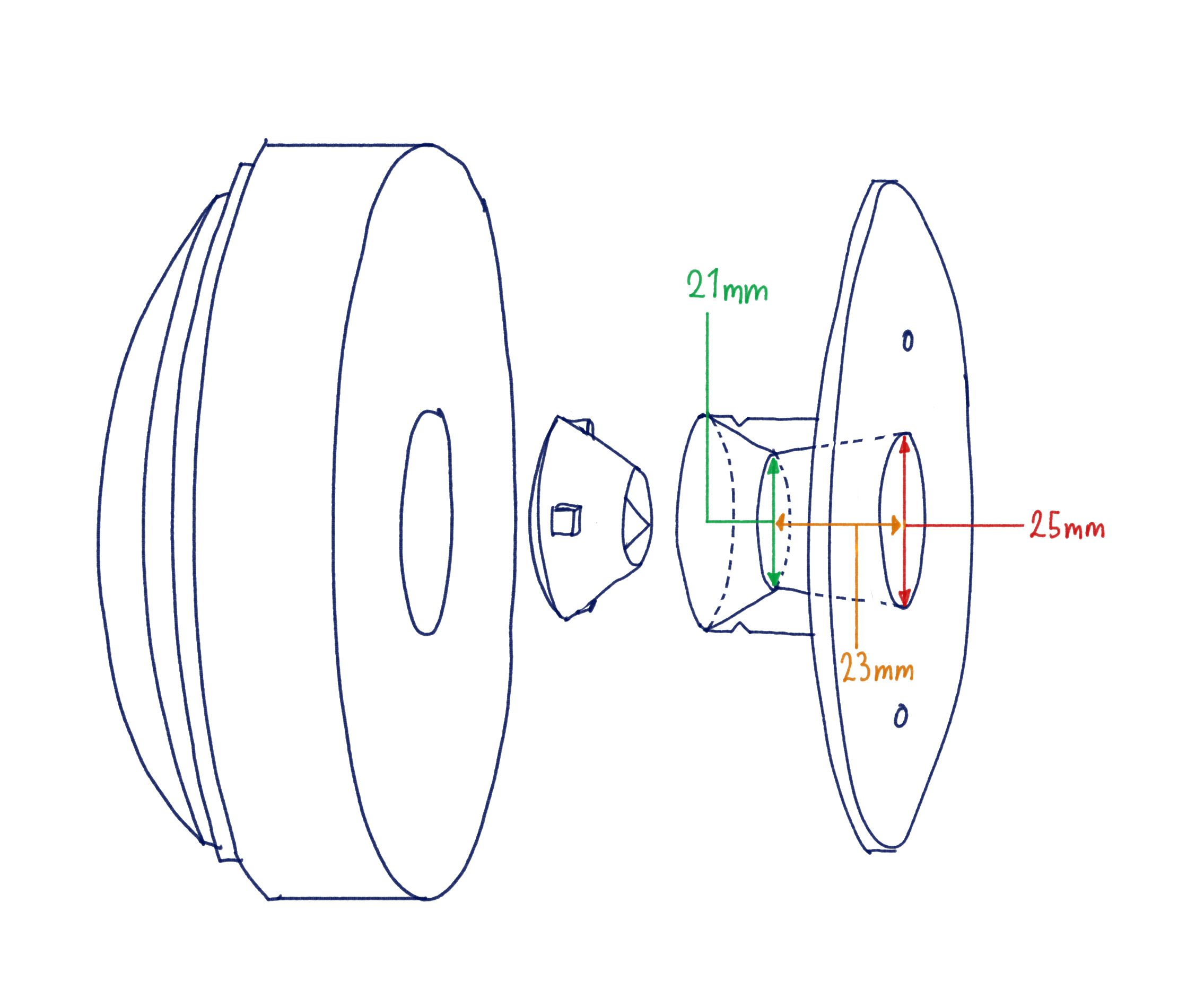

I know this is an old thread but after I bought Radian 475 Beryllium compression drivers from us speaker, I tried 5 times with e-mail for support and never got any response to my requests to know the exit angle of the driver and to see response graphs. Nothing was supplied with the drivers themselves as far as this basic and very needed information.Hey All, I am Dennis with Radian Audio. <snip>
I got the include angel for that driver from Radian some years ago. Will check my emails tomorrow.
Googling "Radian 745 Exit angle" leads to:
https://www.parts-express.com/pedoc...pb-1.4-inch-compression-driver-data sheet.pdf

There appears to be a slight, almost minute difference between the 745 and 475 drivers though 😉
but seriously, unless the "online taper degree calculator" is messing with me, the exit angle is 5°
Ouch, sorry for that !!!
I would say the Exit angle is also 10 degrees on that one from your measurements:
2 x arcsin (2/23) = 9.97
Regards
Charles
