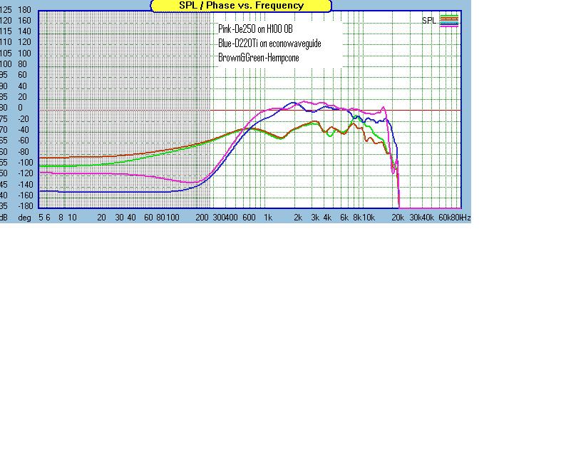

I understand this is a BMS 4540ND thread, those who intending to buy new compression driver and matching horn should consider this combo,
DE250($110) and RCF horn, model:H100($28), taken with no baffle and no equalization. I believe this combo offers good value and sounds excellent. Horizontal and vertical FR curves not taken.
see Attachment for on-axis measurement.
The RCF H100 is a real horn, not a waveguide. With real horns you do not get the decreasing response towards higher frequencies because they provide a boost in this area. That's the major difference between horns and waveguides. With horns you don't need a correction network and they are therefore much easier to implement.
