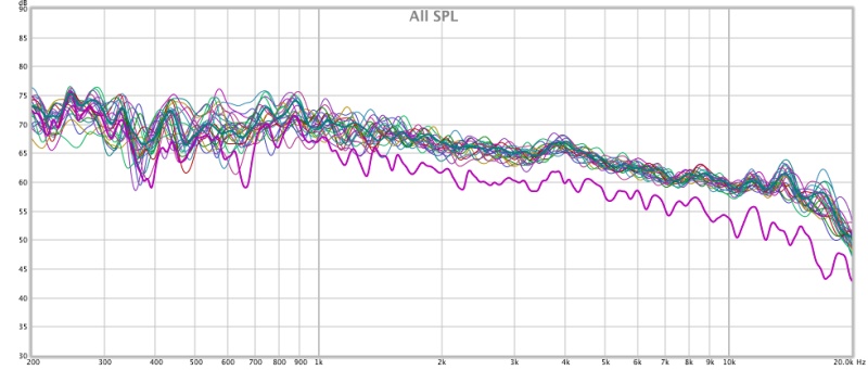

Maybe this graph of mine will demonstrate. This is 22 separate measurements across my couch 1.4m end to end and 30cm front to back. Above 2K there is not that much variation this is raw no eq or correction. In room 2.8m no room treatment of any kind. The thicker trace is the impulse average so the room contribution has been reduced and that reduces the level in line with the RT60 of the room.
A short line of 10 will also behave very differently to a full line of 36 so I don't think that will be a worthwhile test.

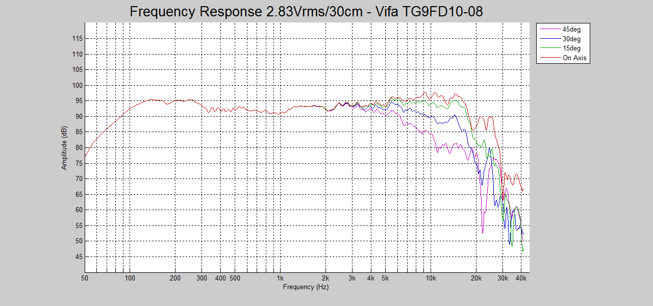

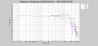

Wesayso perfectly surmised my thoughts - with dispersion behavior at higher frequencies acting as frequency dependant shading. This is what I was clumsily trying to express.
If I had to gamble it 'could' kind of work between 0 and about 30 degree with the TC9 beyond that the output is too irregular. (Best out till 20 degree) It may still help.

My no. 1 requirement was a clean IR, no ringing. Next on my list was a slightly rising top end with similarities in it's off axis behaviour. Meaning the focus was on a driver with fixable faults. You can't fix a ringing top end.
I would value those things in a driver. There are a lot of drivers that fall outside the above scope.
Which makes the TC9 an easy and save choice.
Looking at 20 - 0 - 20 dispersion angle was my focus as the plan from the start was to absorb the first wall reflection (where needed).
Within the array that still just about covers the top and bottom driver in an array just over 2 meters tall compared to the listening distance (shading).
I guess smaller drivers would provide less of this shading .
I looked at many drivers and if I had to start over I wouldn't pick any other.
The TG9 could be a nice choise if you can stand it's appearance. But I'm a paper guy .
I must say I was deeply impressed by the Scan Speak 10F I got from Byrtt and that isn't paper. More akin to the TG.
But I still doubt the 10F would do as well on the bottom end. It is very well behaved and a step up in almost everything else. And as a result you pay for it as it isn't cheap...
The TG has a slight advantage in the bottom end due to its TS parameters.
