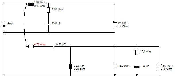

You want to measure the response that is at each speaker terminal now, so you can duplicate this in a new crossover. This is the same passive or active.
Or you can forget that and measure with a microphone and start on a new one, but this is not really making it easier for you.
Or you can guess at some component values and experiment to get something that works. The results might be OK in time.

Do you think the transfer function is only important for one and not the other?With all due respect, it is not "the same passive or active".
Using an active solution you have means to modify response etc
which are not possible with a passive crossover - sure you know?
Simple case, some additional filtering or equalization, quite common in active amps ..
I can not do it passively (in the same efficient way). If you can, it deserves a
dedicated thread. However, I have no intention to get in conflict with a moderator.
We can talk as members, I don't have my hat on.. but yes, I have learned to do all I need with either passive or active or other. It is important to know exactly what to do though.
Yes, and in this context will you claim it is possible/useful to convert the item to passive, even probably incorporating a "rumble" filter, responce equalization and everything ?
Possible? Yes. Useful? This is the difficult question, it depends on the patience and/or the skill of the person doing it.
@ OP, replacing the board(s) is obviously a good option, if money is not an issue. Maybe DIY has something to do with it? A person also has to appreciate that electronics and acoustics can be easy or difficult depending on what you do.
