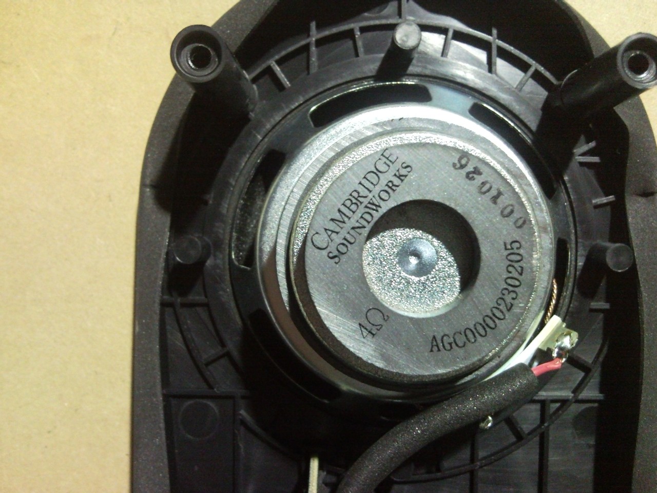

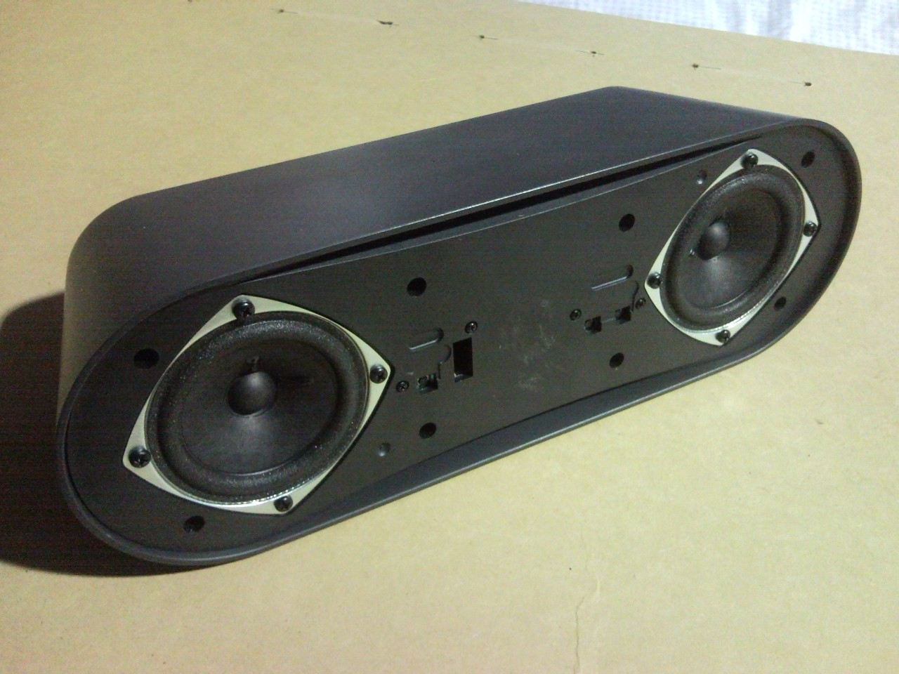

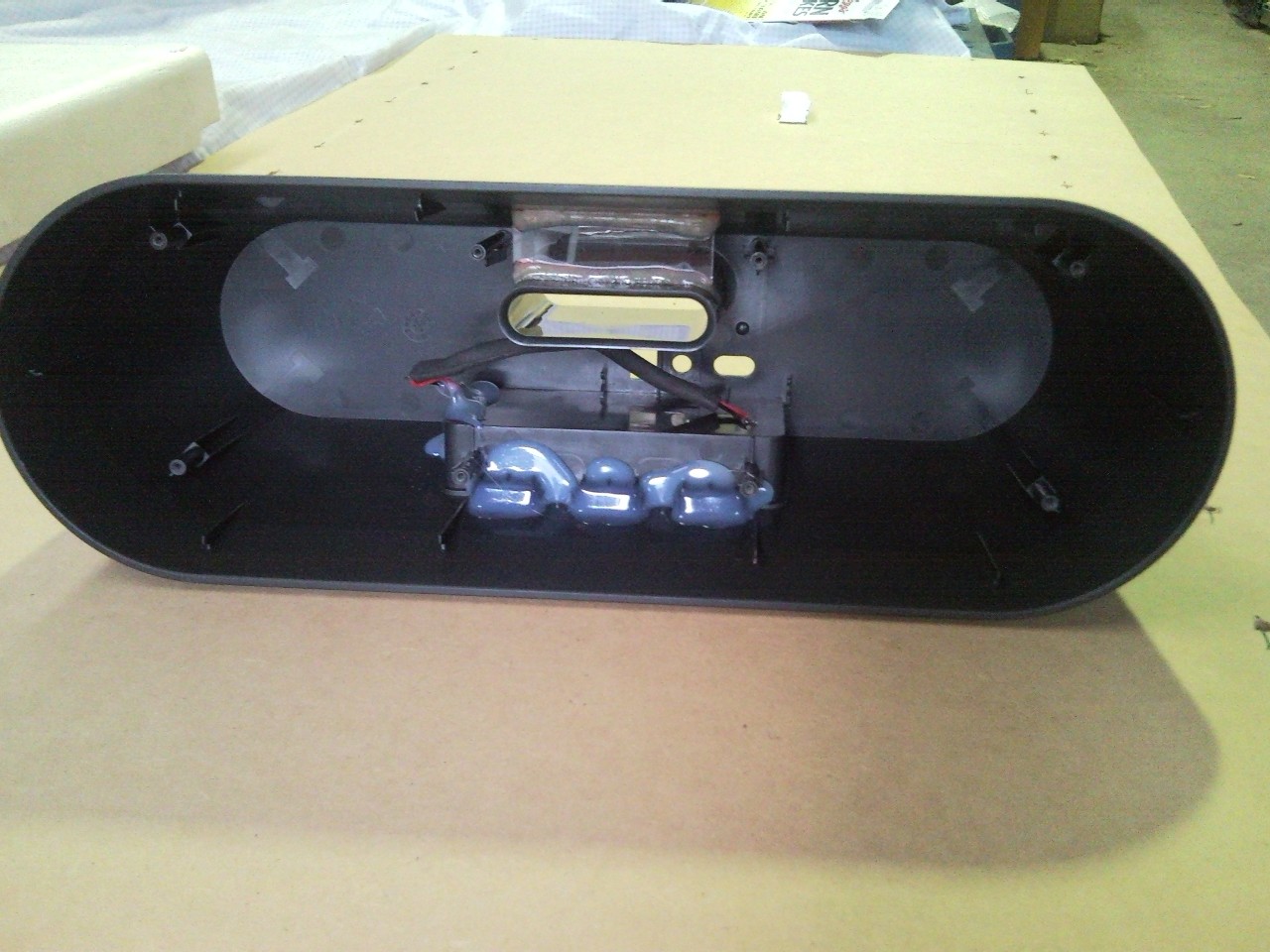

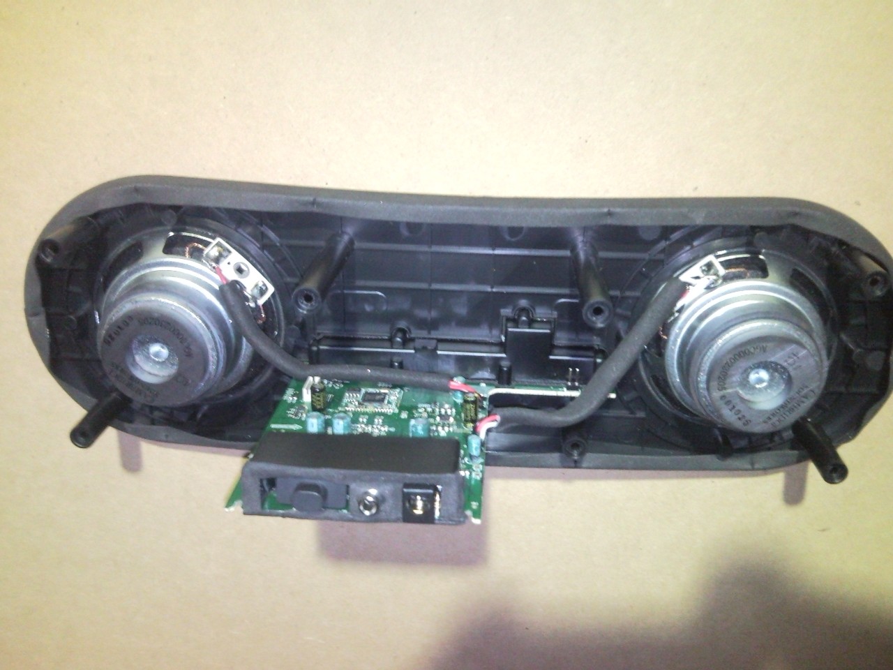

As promised, some pictures of the internals of Creative D100 speaker.
It’s ported enclosure with 3-inch wide-range speakers driven by TI class D amplifier TPA2012D2. Amazing fact (for me, anyway) is that there is no heatsink for 2x2W amplifier.
All electronics runs off 4XAA cells or external 5V power pack. Bluetooth receiver module is based on 57F68 chip made by CSR – perhaps, some BlueCore family.
The enclosure is sealed pretty well with some kind of foam everywhere, but there is neither sound absorbent padding (or whatever you, pros, call it) nor vibration damping coating. The sound is pretty ugly, therefore. The upper flat surface of the case vibrates a lot. If I press on it with my hand, the sound becomes a bit better. The bottom surface does not noticeably vibrate, because of rigid battery housing.
Any suggestions on improving the acoustical properties of this plastic box? Or maybe I am barking at the wrong tree? I have almost zero experience with audio design.

There are some things you can do to improve the box.
IME you will improve the sound, but it will leave you hungry for more.
So treat this as a learning adventure.
If I was going to keep the box as is, here's what I would do:
1. Buy 6-8 packets of Blu Tac and line the inside of the box with it.
Then listen to the sound.
2. Cut some 4 mm x 2 mm rectangles of duct tape and stick them
on the back of the box around the port opening in the EnABL pattern.
Listen again.
3. Add a very small amount of stuffing being careful not to obscure
the port. Listen again and add or remove stuffing until it sounds right.
There is plenty more, but start with these.
Alex

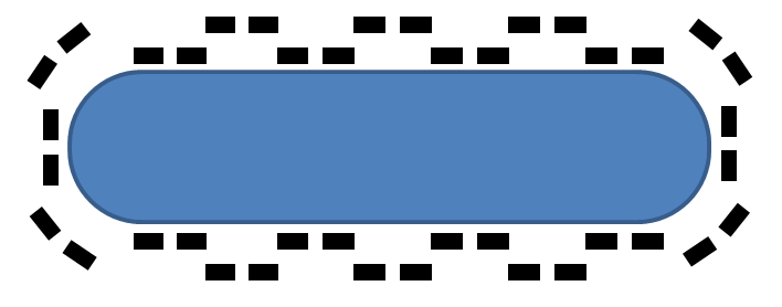

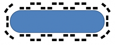

I guesstimated the port size from your picture and have drawn up a very
rough pattern to give you an idea of how to do it. The blocks closest to the
port should be about 1mm from the edge. Refer the attached pic.
BTW, Norton All Weather Tape (Bunnings has this) would be even better than
duct tape but it costs nearly three times as much.
Alex
