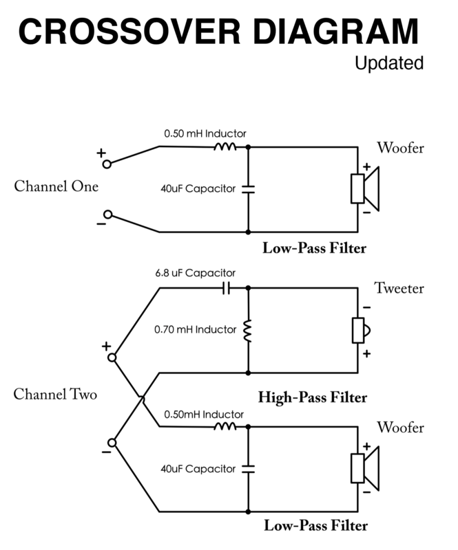

Hi All, I hope I'm in the right forum. I got a Cambridge Soundworks Center channel speaker for free, and I thought it would be fun to make it a built-in stand-alone bluetooth speaker. Most of the chip amps I've seen have two channels, a left and a right speaker. This center channel has two midrange, apparently wired in series, and one tweeter and they connect to a crossover (I guess?). How do I wire the speakers to the 2-channel amp with one tweeter? Do I use the crossover somehow, or eliminate it? Any other advice you can give me? Thanks all!

Your idea is no good.
Many D-amps do not like to be connected to a capacitive load like your tweeter shows. So the tweeter channel will run hot or even fail.
Your mono/stereo theorie does not work. One speaker mono, two (or more) stereo, that is the world. Sorry.
At last, there is no way to do a decent passive x-over without a lot of practical measuring. So just choosing some part´s values will not sound any good. No way just to take some formula and you are done. Sorry again. Read about constructing passive x-overs and then you might understand.
You have one speaker with a good x-over, so fit a mono amp to it and you are done. Will be the best you can get.

Ok, thanks Turbowatch2! Great info. A mono amp it is. Regarding stereo vs mono, if I'm using a mono amp, is that like listening to either the right channel or left channel in a stereo setup? Thus, could I be missing audio that's for the 'other' channel? If there's a trumpet in the left channel source, and I'm using a mono amp, would I potentially not hear that trumpet? Or is Mono a combination of both channels together?

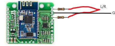

I have tried one bluetooth mono amp, and I was surprised that it actually played only one channel sound, not L and R. It can be quite annoying to listen with some music 😀 at that point I decided never ever again use those.
I've had good results with this bt-board: CSR8645 APT-X HIFI Bluetooth 4.0 12V Receiver Board for Car Amplifier Speaker | eBay
You can simply combine the L and R channels with one (1k I think?) resistor in each channel, and then the other ends can be connected together.

You're proposing I connect a 1000 Ohm resistor on both L and R, and then I can combine them together like the attached pic? So I guess L/R would go to INPUT+(square) and G to INPUT- (round) on the amp board? If that's the case then I'm all set!!

Did I describe how to implement the resistors and combining the L&R signals correctly?

Yes, that diagram is correct.
