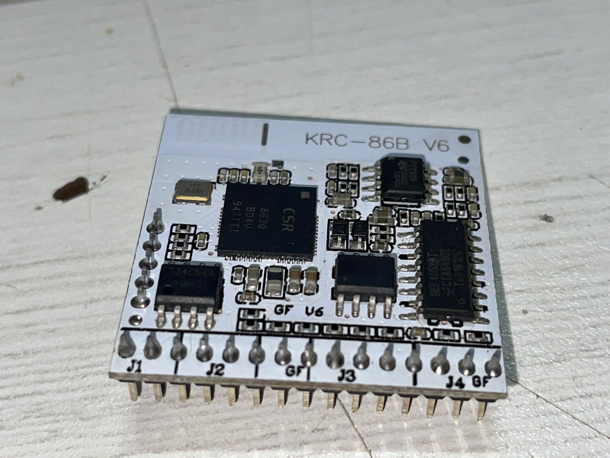

well, I have bought this module, KRC-86B V6. It is similar or rather the same as the one shown in the below video. The only difference is that what I bought from the micro center is from Dayton audio and its 2.1 with TPA3118 ( 2 ) chips

the reason I bought this Bluetooth board is that it has a voltage regulator, Opamp for Differential to single-ended on one board with Analog Gnd and Digital Ground.

Hi! Thanks for the info in this thread, I have found it helpful in my current project. I have a KRC-86B module, but it is V4. 0. I would like to know where you got your V6 module. I know your post says micro center but I can only find the board soldered on to an amp at that retailer. Do you know of a vendor that sells the KRC-86B V6 on its own?

Thank you, I have seen this. I am also fortunate enough to have a micro center close by! I was hoping to find just the current (v6?) version of the Bluetooth module, the KRC-86b. I have a couple of the V4.0 but can't seem to find the v6 on its own. The V4.0 boards go for much less than the 28 dollars from micro center. For what it's worth, they are fine, I just wanted to compare. I appreciate your reply!

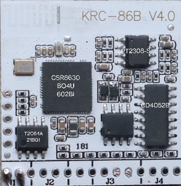

I took a nice close up image and labeled any components I was able to read for you. There is one small IC with no markings, the rest are labeled as best I could, though my eyes are struggling.

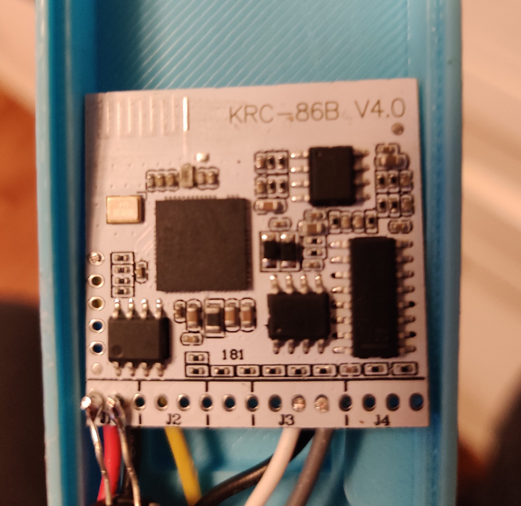

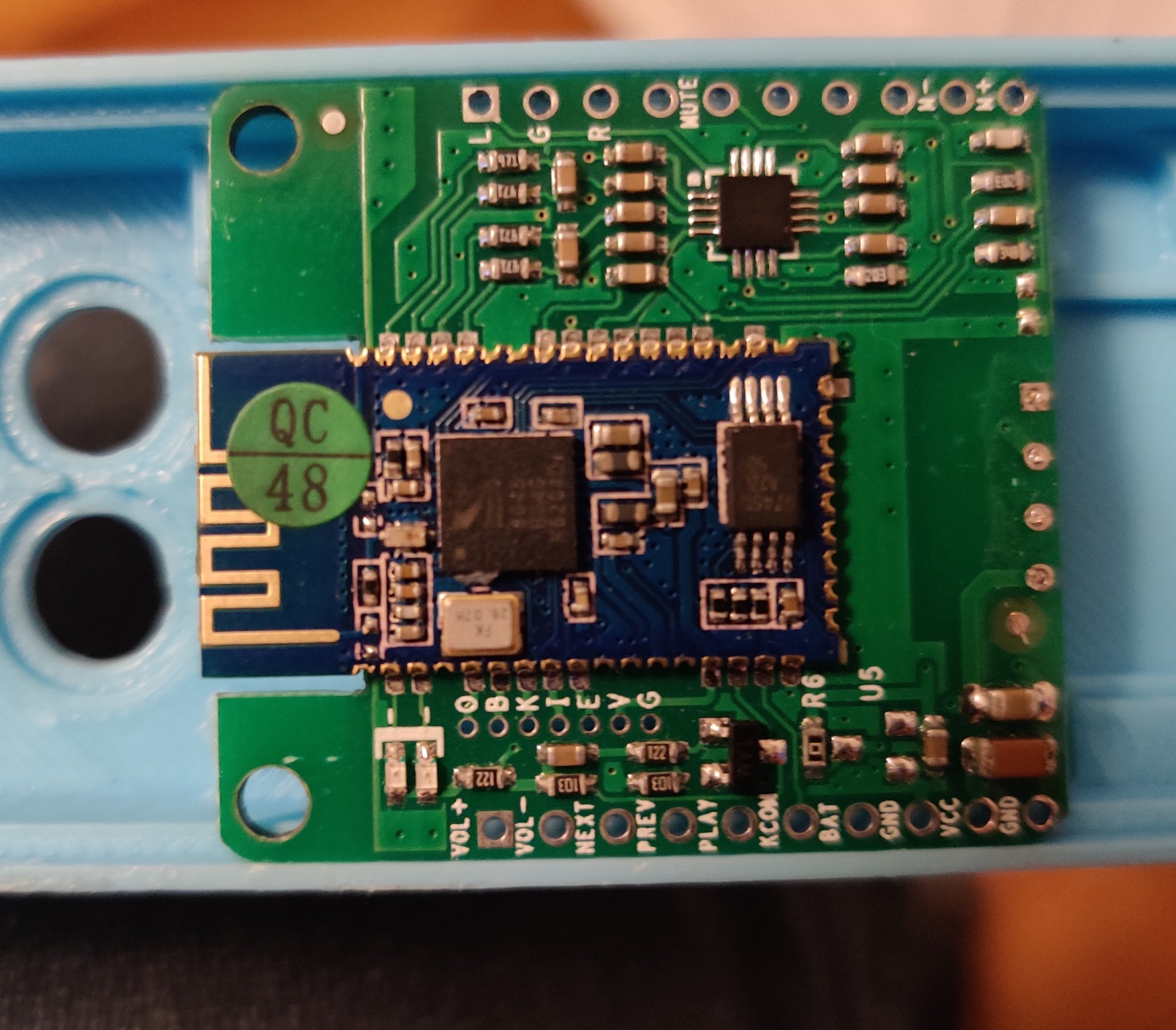

All of that sounds great to me, and I'm glad you chimed in as OP, I don't want to hijack your thread! However I am working in a pretty tight spot and all of the newer modules I've found are just slightly too large. The KRC module fits well and the way the pins are broken out is better suited than the (also dated) CSR8645 board that I have. I am still able to get the Krc86b cheaply and easily. My project is going in an old truck with a V8 and no doors, so High fidelity is not a primary concern. have a USB Spi on order to see what customization I can get to on this module.
All that being said, if you know of a newer/better QC board that is 30mmx30mm with pause/play, next track, previous track controls I would love to hear about it!

do you know what the input voltage range is on this IC (The L1117)? I see a wide input range specified for the L1117 itself but the KRC -86b specs seem to want 5v going in to VCC. Maybe the KRC specs are incorrect? I am currently powering mine from 12v via an external regulator, but would love to ditch that if possible.
@Amfw
Sorry the L1117 could have managed with 12 volts but since the numbers are removed from 8pin chip. Difficult to say.
It could be 78xx in a SO-8 package. They do exist but again only is to try one but it is. Not risk free.
Let me check my board what’s going on it. It’s night here will check how they have connected on the board and get back
