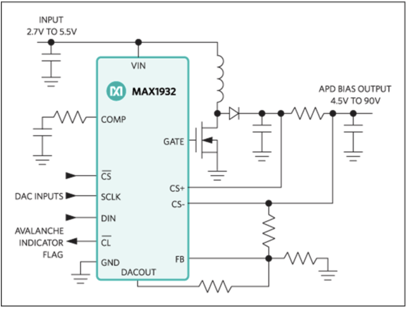

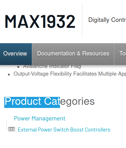

As a matter of fact, it is not possible to get 20Watts audio output from a 3.7v source without an extra power supply, in your case a Buck Regulator. See photo showing the choke and switching regulator required to increase the voltage before it will work.

@JonSnell Electronic I think you mean a Boost regulator, right?
The correct name is a Buck Regulator or Convertor as it can be used to boost or reduce by the use of a switching component and recovery diode that will either add or reduce the output voltage.
Here is a typical schematic;

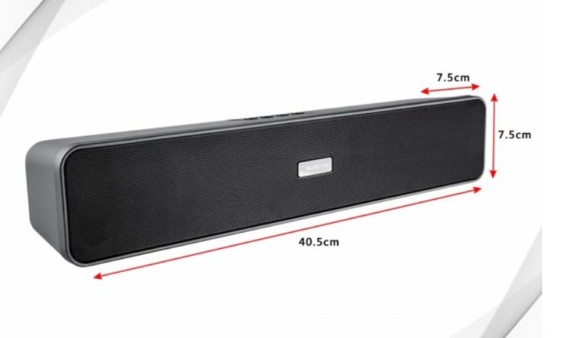

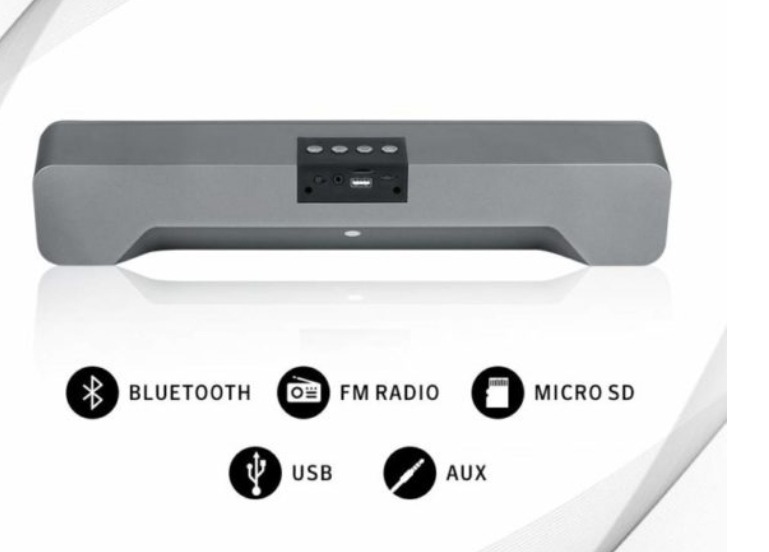

About my sound bar it has speakers of 2.5 inch good quality, per speaker 10w rms, it has two bass radiators in front
Adding a pic of my soundbar
