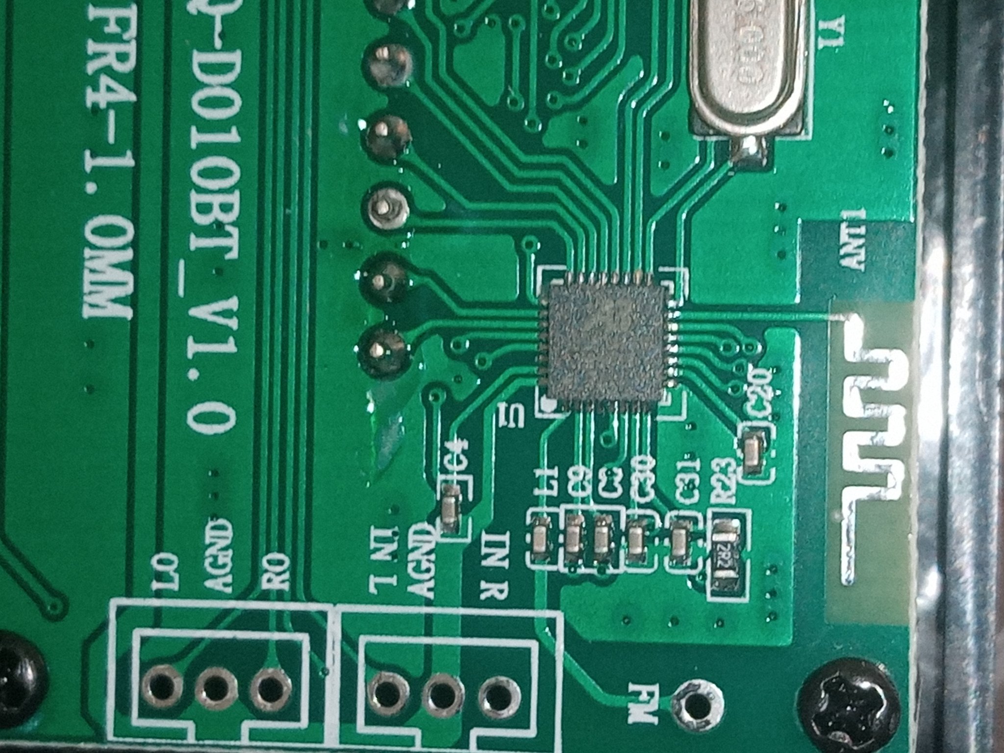

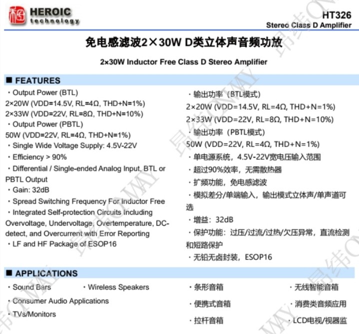

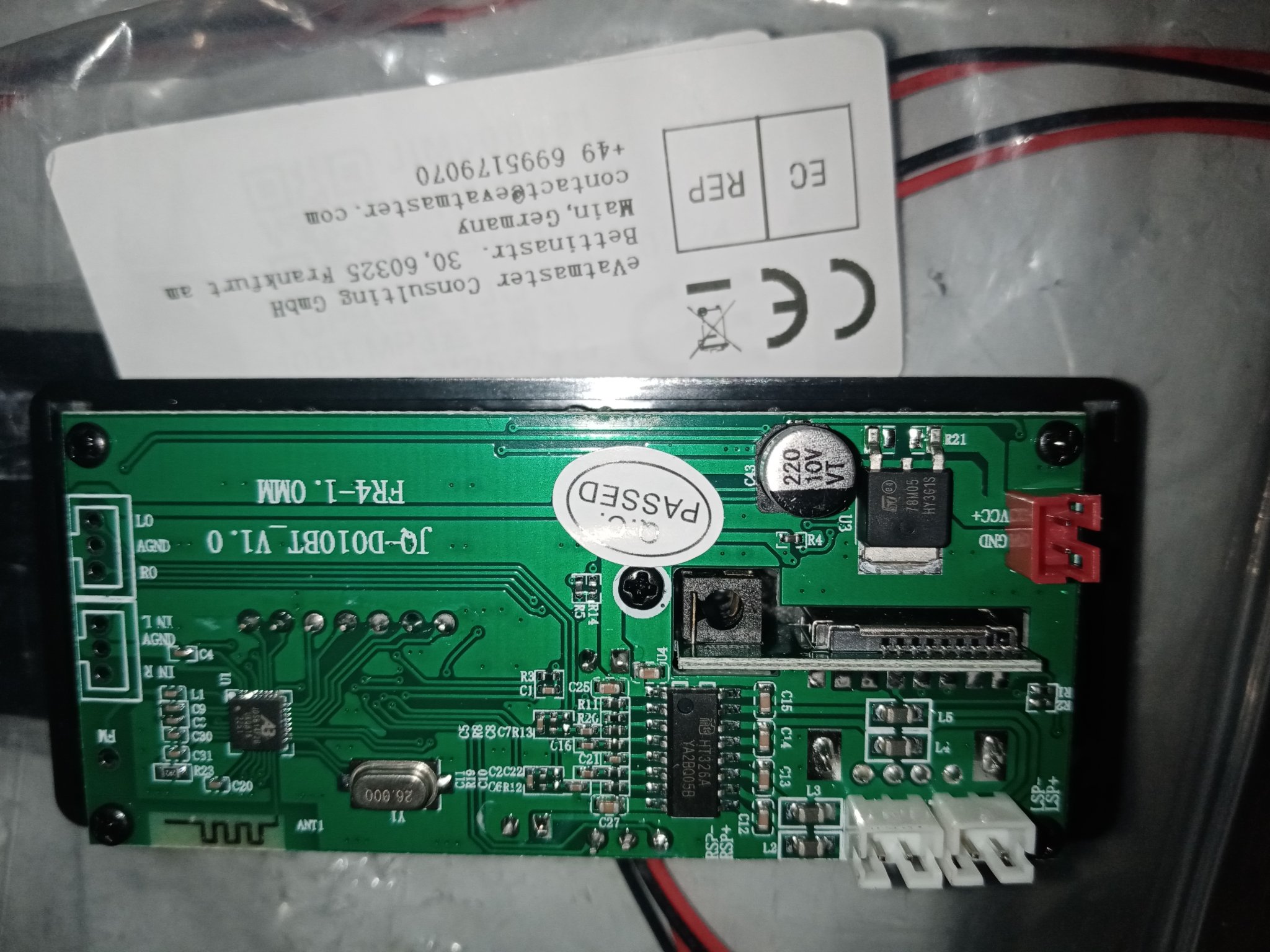

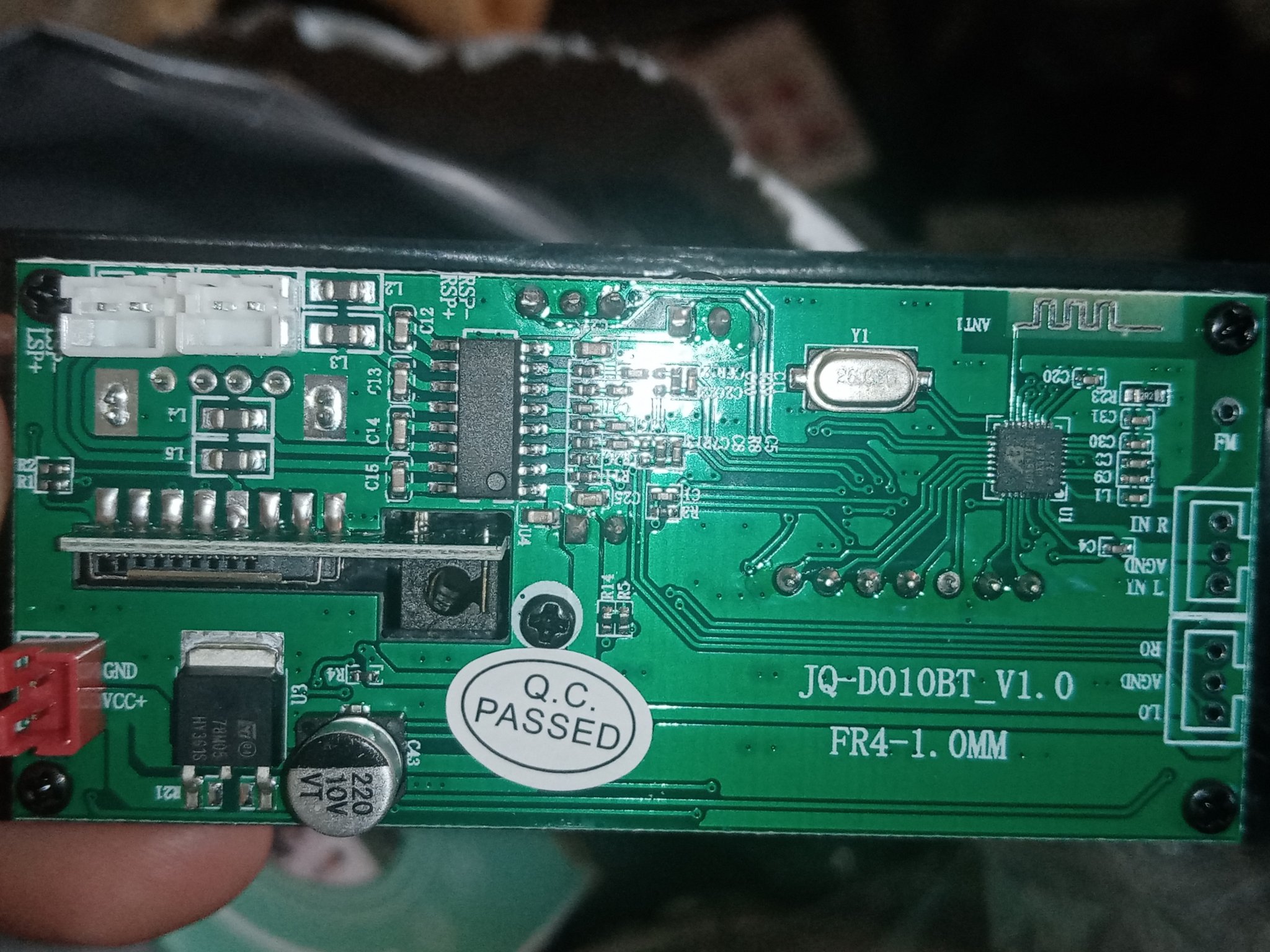

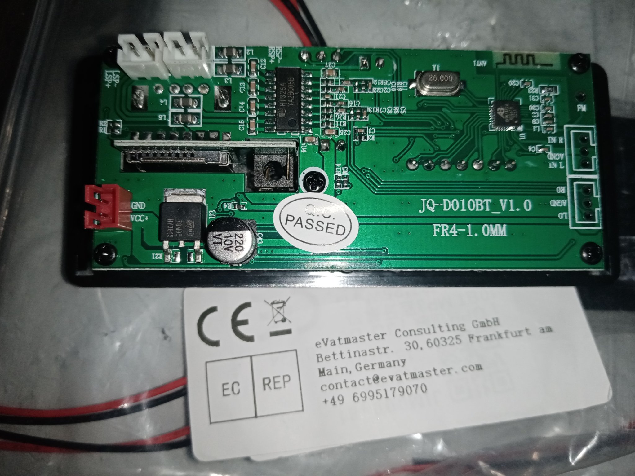

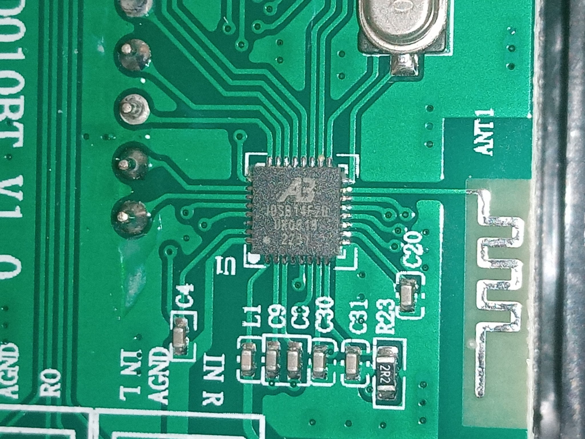

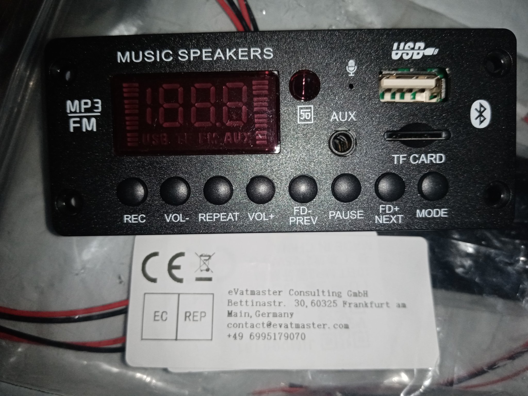

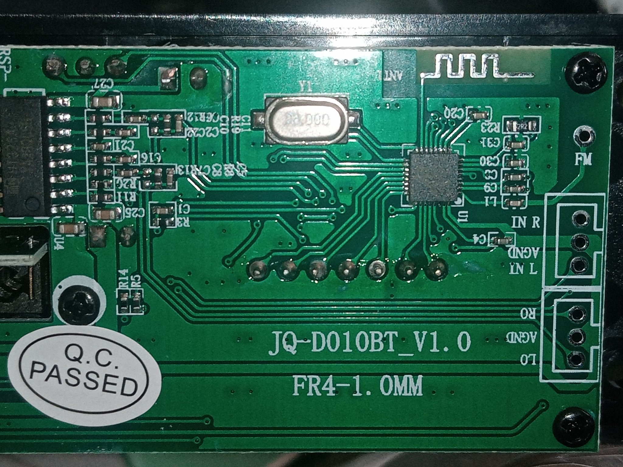

Little amplifier with HT326A class D chip. Chip can take up to 22 Volts.
It's for 12 volt up to 16 volt power supply specified.
Electrolytics on the board have 35volt. I wonder if this mini plate amp could be used up to 22 volts. Maybe the 5 volt 7805 would get too hot with this voltage.
