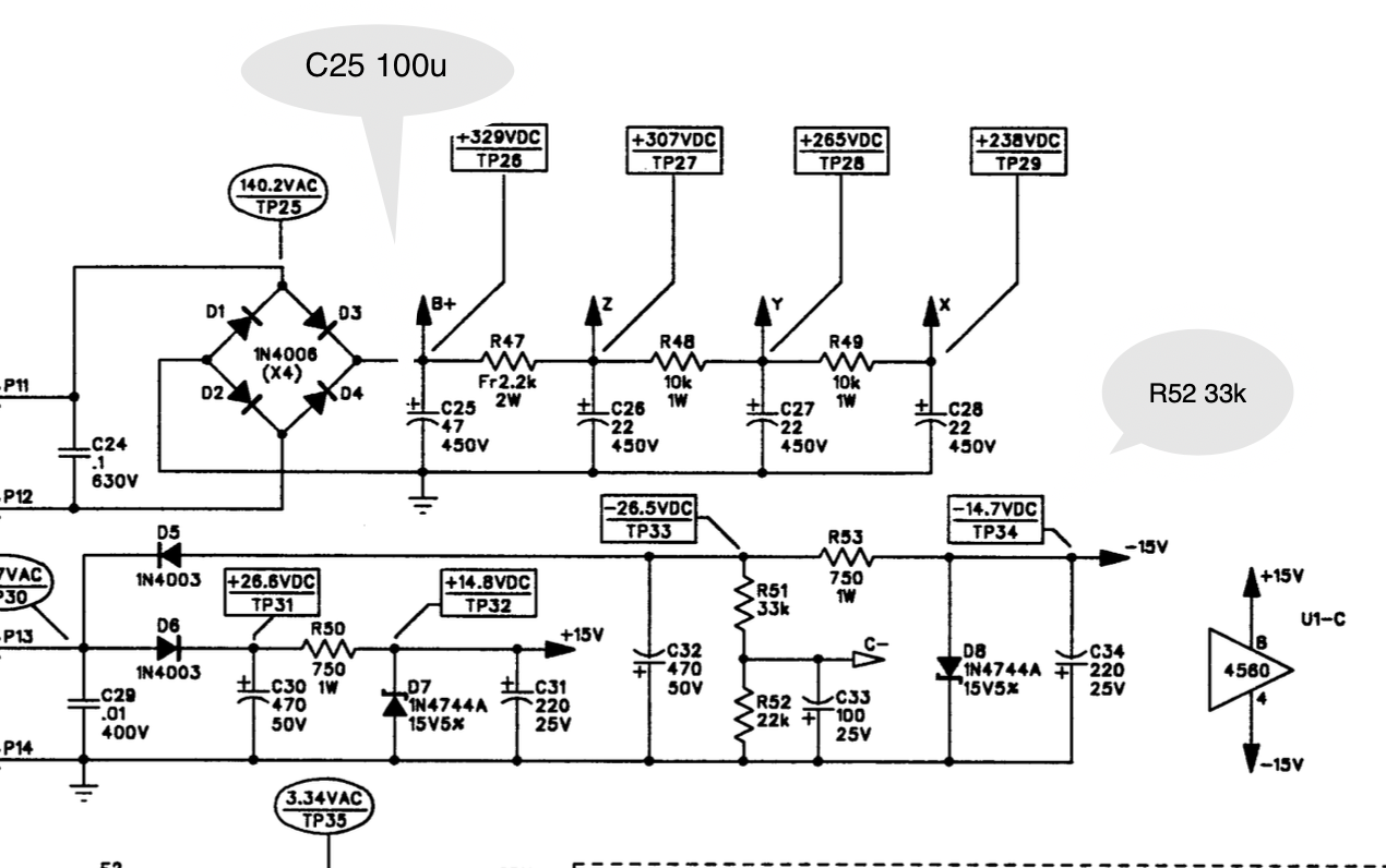

Hi, I'm new to diyaudio. Could some one please help me with a BillM style Bias Trim Pot installation for my 1995 (Green Board) Blues Junior? I've located my (vertical) R-37 and my (horizontal) R-31. I'm not sure as to placement & orientation. do I only replace the R-31? Should there be a link to R-37? Thanks, j.f.
??? horizontal , ??? vertical....not sure what you mean there... i can supply you with a link to the Telecaster forum that has instructions for installing the mod if you like.
You don't need to fit a pot, there is no advantage.
Depending on the model;
The 100u (C25) will give a better attack and the R52 change gets the valves to the correct opperating dissipation.
