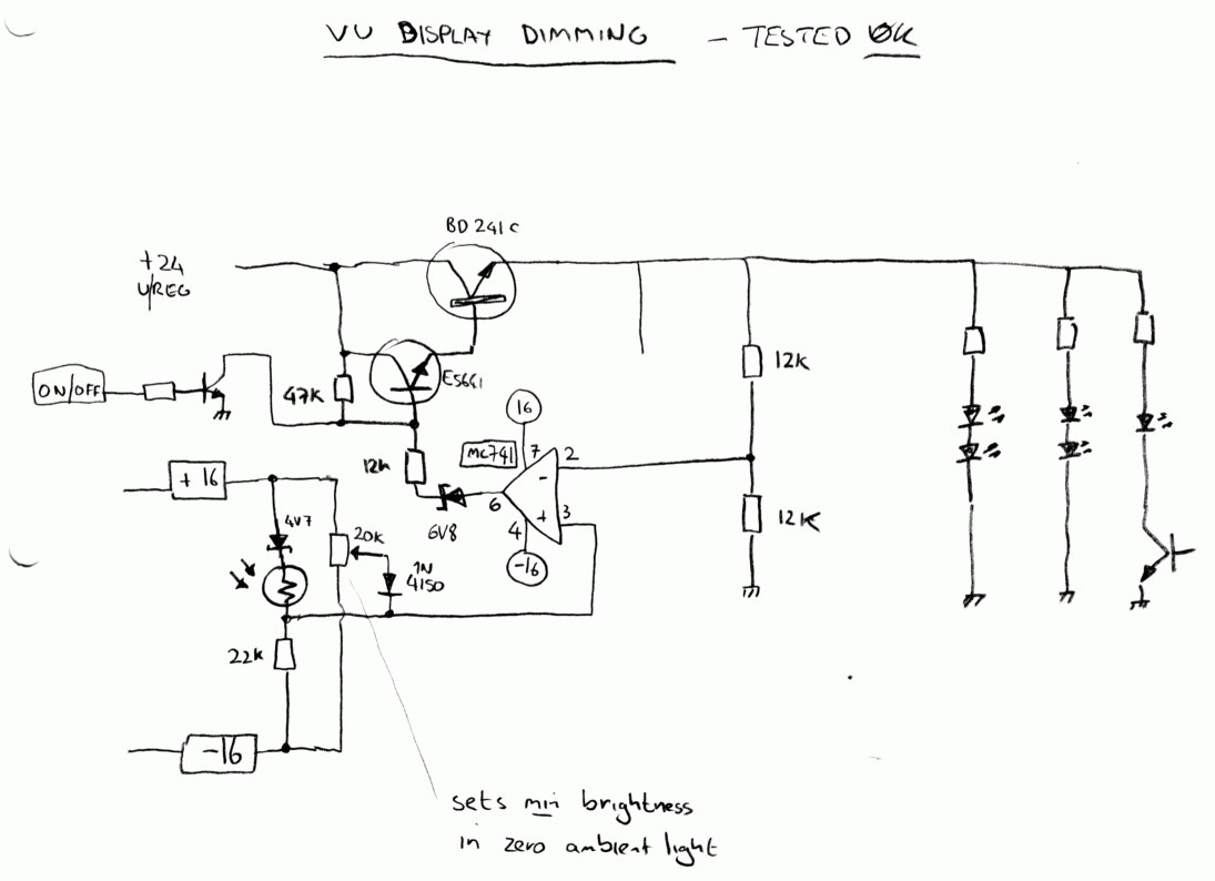

It IS an old thread, but it appeared in my "new posts" list, and coincidentally, I've just been working on a circuit to do this for my own DIY power amp - make the VU meter illumination and mode LEDs track room brightness.
It's slightly more complex that described by the OP, since I need the status LEDs to dim too, but be indepedantly switchable from the VU meter illumination LEDs
Here's the circuit I settled on after testing a few:

Wouldn´t it be nice if it (the led) would change it´s intensity according to the available light?
Does anybody have an idea how this could be done (LDR etc.) in a simple way?
I did that. I made a current source with an intensity regulation pot, and a photo resistor in series with a pot. Very simple. One transistor and few resistors.
