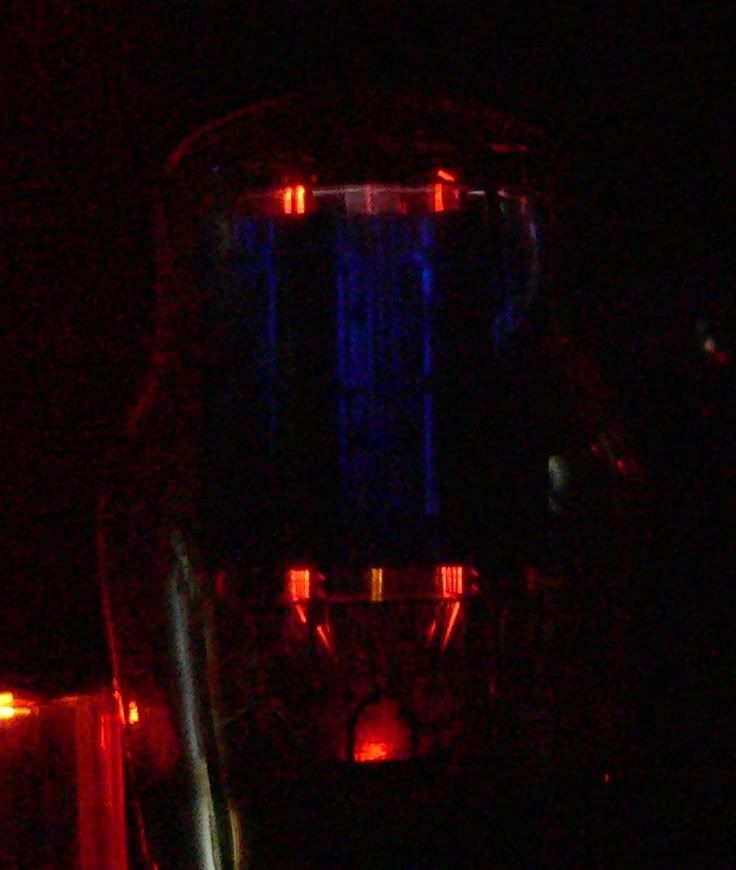

Hi Guys
I just finished off a simple little 6EM5 PP amp from odd bits and bobs I had lying around, and I turned the lights out to show my workmate the tubes in action. I noticed a couple of blue bands in two of the 6EM5 tubes, and I have never seen this type of thing before.It actually looks kind of cool and I gather from the posts I am reading that this is not a problem....?
Cheers

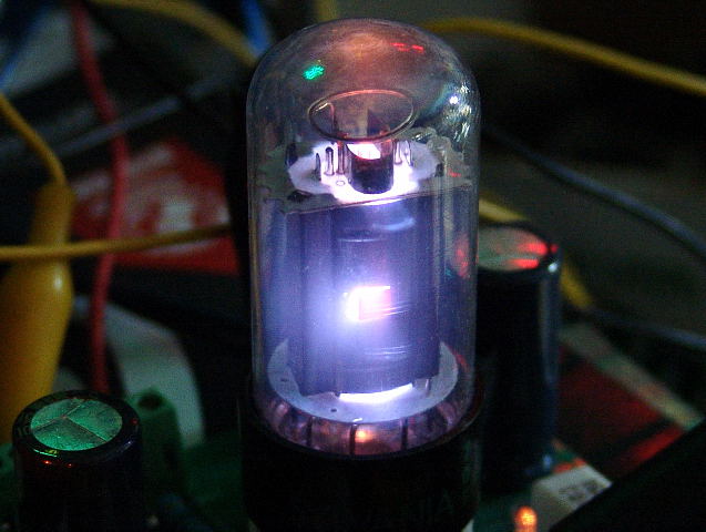

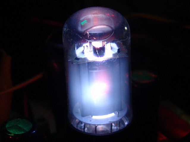

There are two kinds of blue glow that can be emitted from a tube.
A gassy tube can emit light due to ionization of the gas inside the tube. This is actually a small scale plasma. A really gassy tube when excited by way too much electricity will glow rather brightly, especially right before it dies, or takes out amp parts. The 6V6GT shown here is a few seconds from dying.
The deep blue glow seen on the inner surfaces of the glass, and less commonly on the surface of internal components of the tube is from impurities inside the tube being excited by electron bombardment. Cobalt impurities produce the deep blue glow seen on the glass in some power output tubes.

That looks like electrons hitting the glass. Is the blue by holes in the anode?
Yes, it is. There is a small hole at the top and bottom of each anode next to the mica spacers. For what it's worth, the tubes are all nos RCA's, and all tested well in my AVO 163 with no signs of gas. B+ is 290 Volts, self biased at approx 19 Volts and screens regulated at 250 Volts. I was just curious, as I have seen blue glow from tubes before, but never quite like this as distinct bands.
Thank you to those who replied.

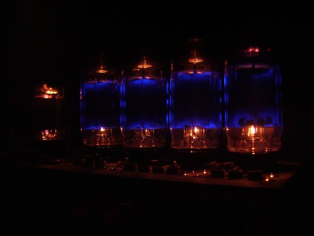

You should try the 5B/254M. I have some here that light up with Sargeant Stripes in the glass 🙂

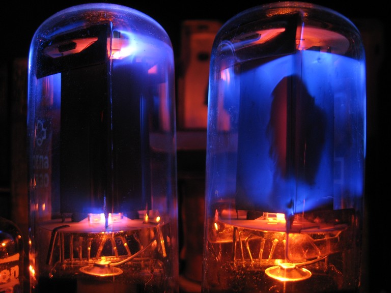

There are three common types of blue glow I believe,
One comes from electrons hitting the glass and causing it to fluoresce, if the glass contains the right elements (presumably harmless?) That's what you see in SpreadSpectrum's photo.
The second comes from a very poor vacuum and the residual gas ionizes like a voltage regulator tube (bad valve!), which is The Gimp's photo I think.
The third is the blue glow you nearly always get between the screen grid and suppressor in pentodes, due to ionized gas being re-neutralized by the slow electrons around the suppressor, also harmless. You can see this is Wavebourn's photo. Sometimes this can reflect off the glass and be mistaken for the first type of glow, which I think is the case in Rznize's photo.
