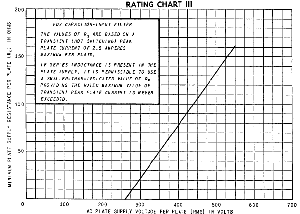

4. In any case, for a rectifier tube you must respect the total minimum series resistance, before and after the tube, and you should respect the total recommended maximum capacitance too. 270µ is quite a lot...
The 5Y3 accepts 2.5A for 0.2 seconds; here, the peak current is closer to 3A.
Let's take a look at the 5Y3GT datasheet. For a plate voltage of 380v (I suspect the voltages are higher than what the schematic says), the minimum plate series R should be 75 ohms, per plate. Here the plates are paralleled, so the datasheet recommends at least 150 ohms between the rectifier and the next capacitor (C9), which should be small. But here they used only 100 ohms and a big capacitor.
Another problem: the total current draw of the amp is around 170mA DC. At the voltages used here, the datasheet recommends less than 120mA through the rectifier.

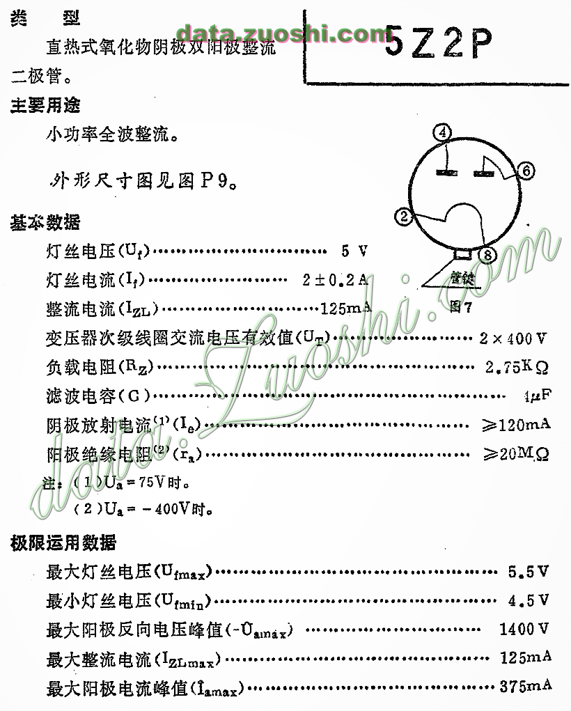

3. Chinese 5Y3 is indirectly heated, while western 5Y3 are directly heated! They are not the same tubes!!
Chinese 5Y3 = 5Z2P, right ? as I can see this is a directly heated tube.
http://data.zuoshi.com/audiodata/cn/5Z2P.png
This amp is wired for 230V primary (line voltage is between 222 and 228V here).

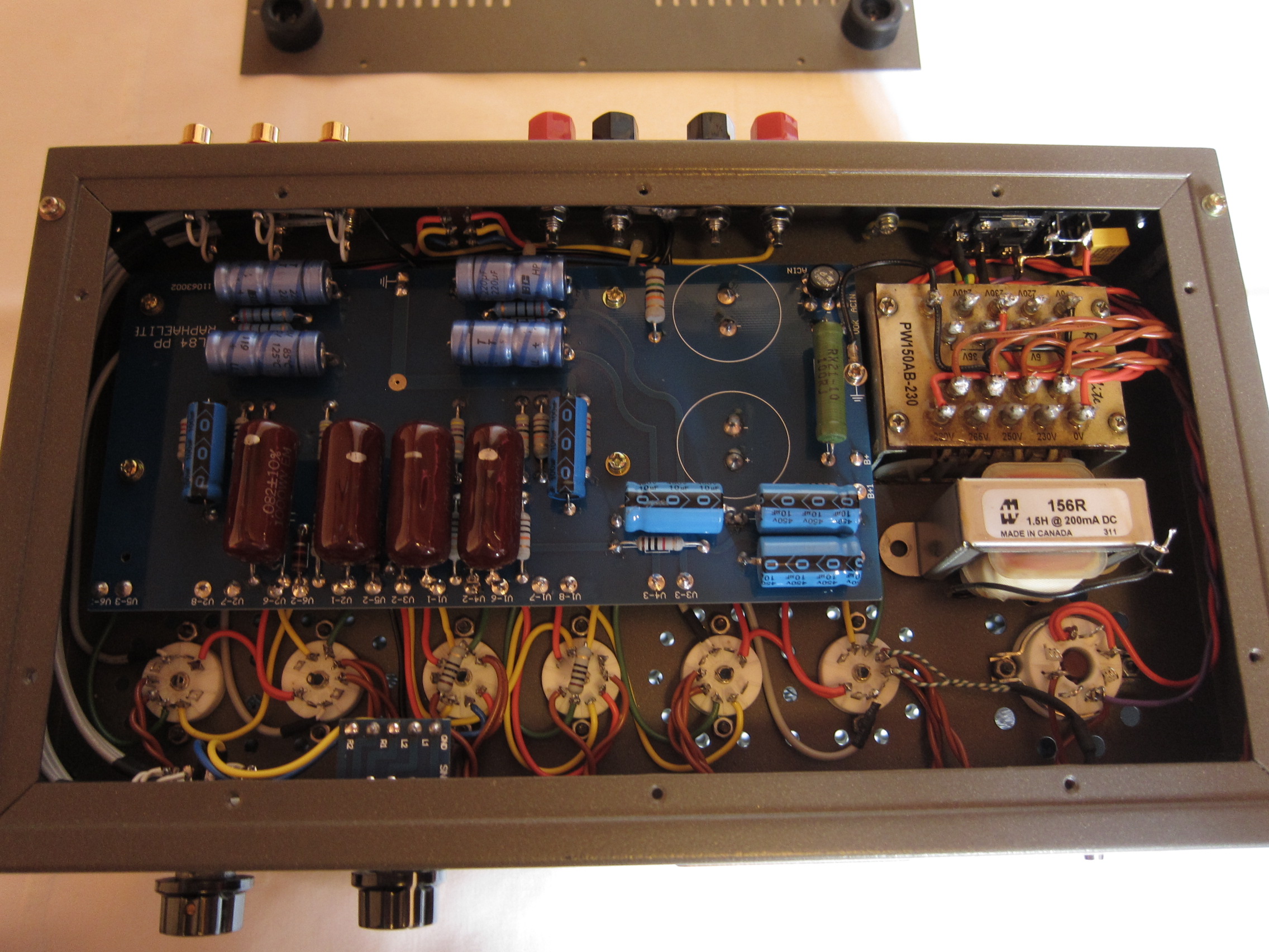

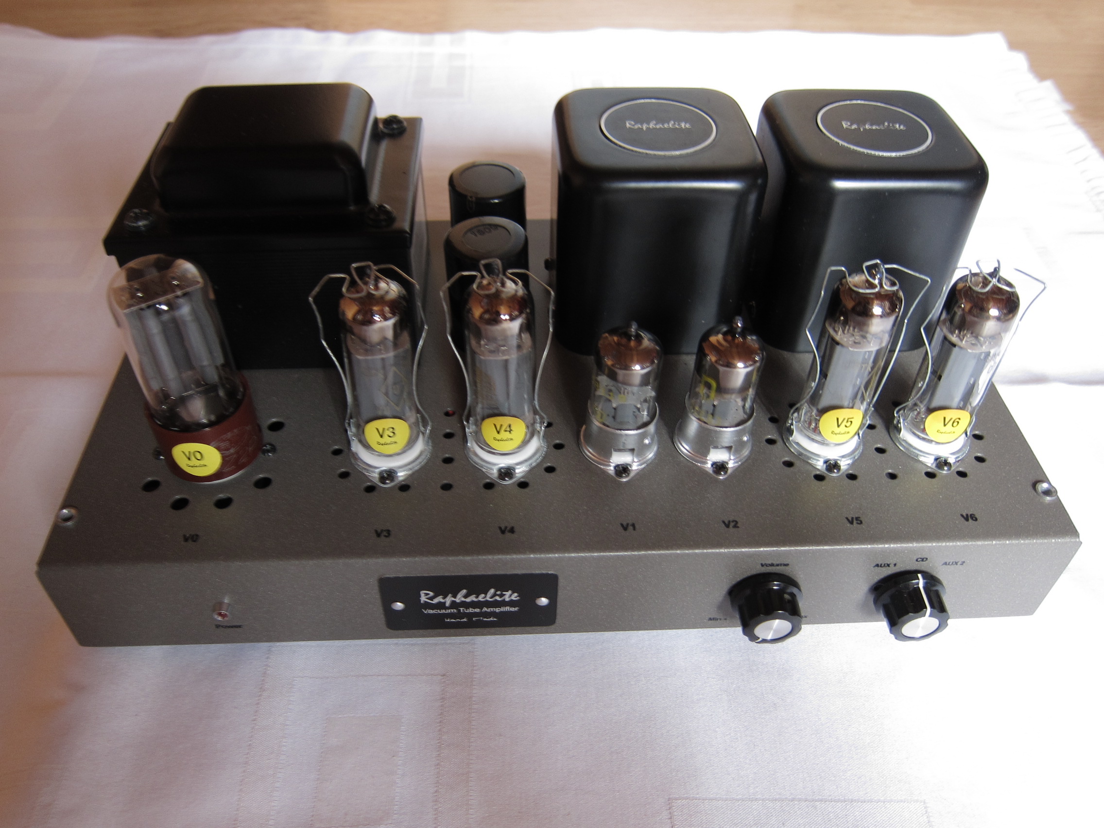

And some pictures now.
eko2, can you please measure the voltage on the rectifier's plates? (where the orange wires are)
Chinese and Russian 5Y3 are indirectly heated, see:

This has nothing to do with whether the tube is directly or indirectly heated; either will work.
Of course they will work, only the directly heated tube will start conducting faster!

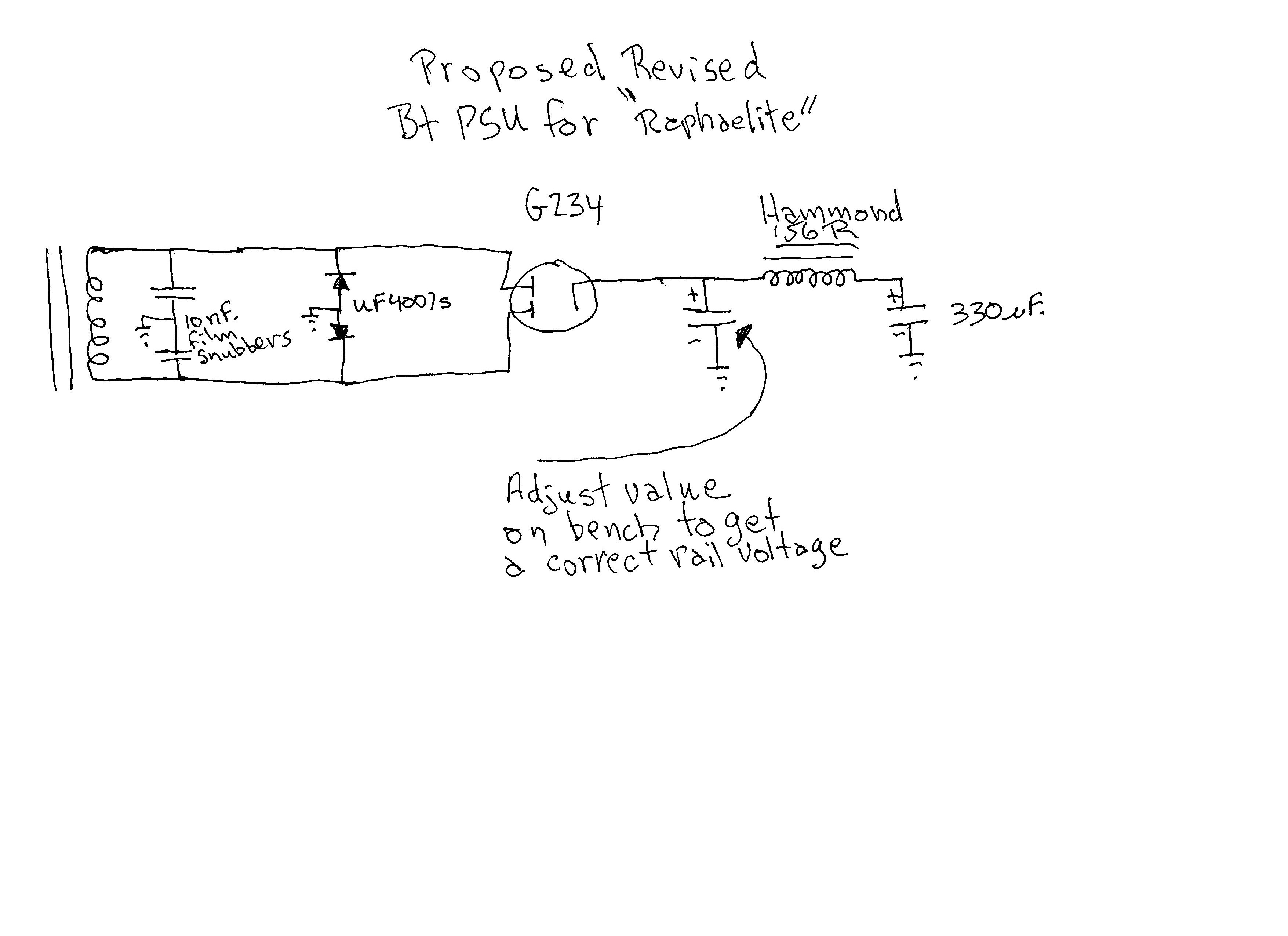

The photos provide some good news. There's room inside the chassis. The tube sockets are not mounted on the PCB. It looks like the PCB is not particularly dense and that allows for "surgery". The OP has found room for a Hammond 156R, but mounting on the side wall might be better. The idea is for the lam stack to be perpendicular to the lam stacks of the other magnetics.
From the size of the solder spots on the PCB, I'm thinking the big 'lytics are of the snap-in variety.
I've uploaded a crude drawing of a revised B+ PSU. Have at it. Forward drop in 5Y3s is large and forward drop in GZ34s is small. My thinking is that a fairly small cap. at the CLC filter's I/P will be enough to keep the rail voltage up.
