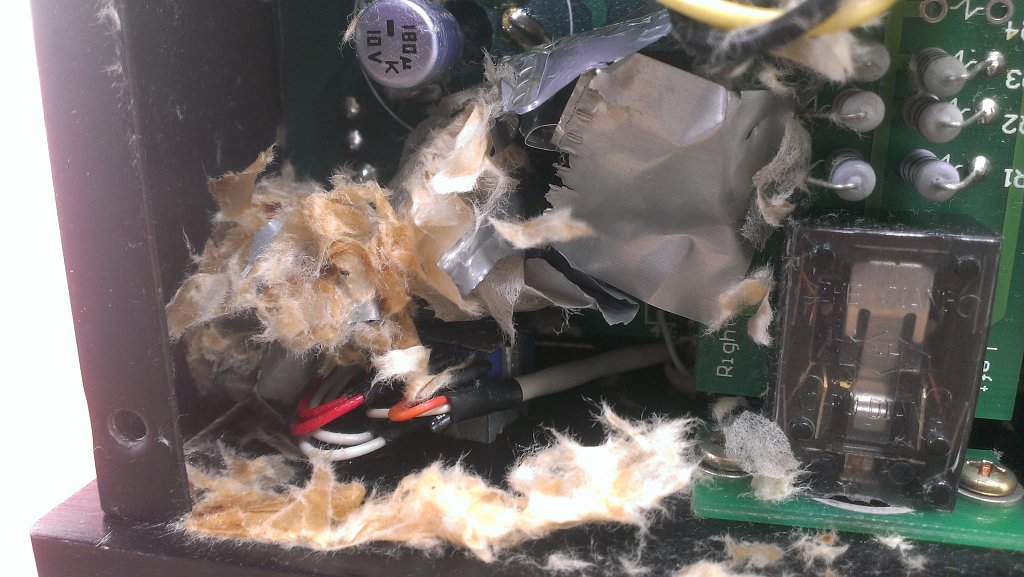

I was moving some equipment home so I could use the EZ10 (6V6 PP) amps that I built and replace them with a Chinese single ended amp. I had pretty good luck with this one but its life came to an abrupt end yesterday. It was buried shortly after with a dignified send off.
It had been in use daily for about 1year, then I built a couple 6V6 monoblock amps (EZ10) to replace the Chinese amp with.
Well after about 3 months of operations I decided I wanted to take my GOOD amps home and put back into service the Chinese single ended amp. This created the Big Bang and some stinky smoke.

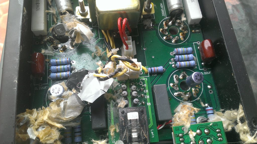

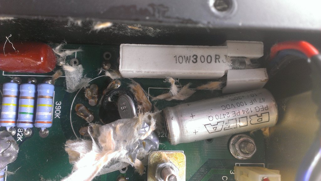

It seems that the amp had no fuses and the one of the PIO caps that blew was placed very close and parallel to a HOT resistor, which also got destroyed by the shock of the explosion (see second pic).

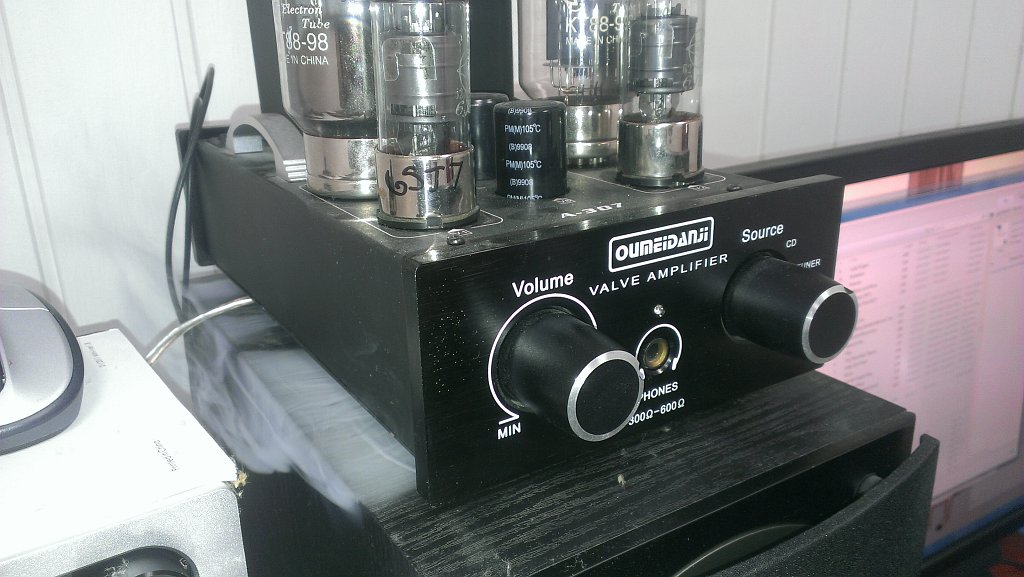

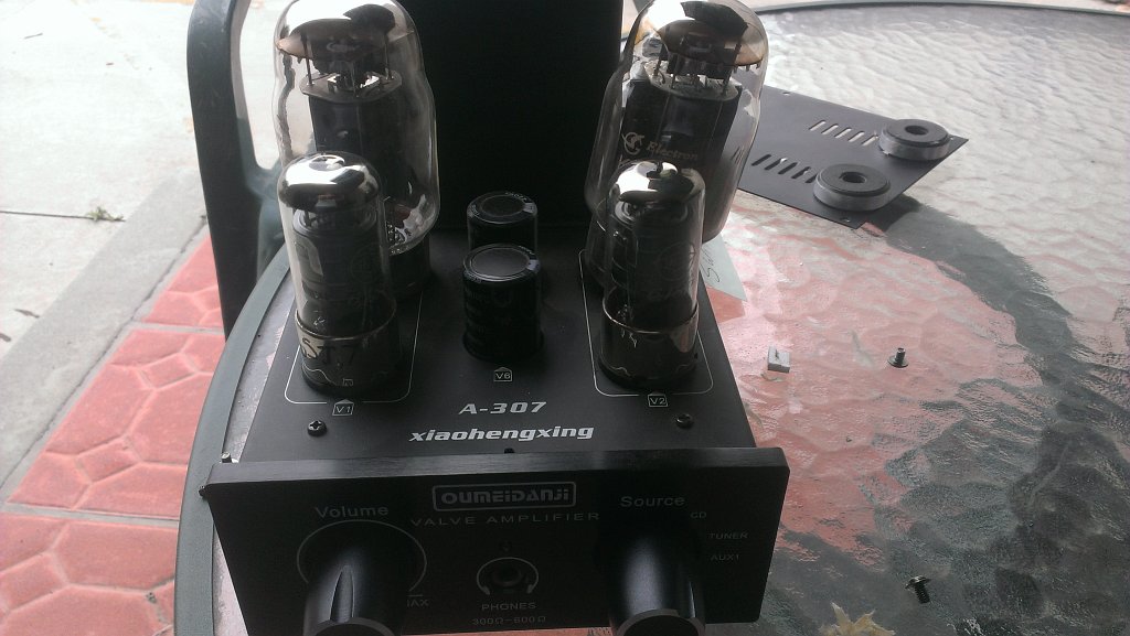

Pictures for your enjoyment, picture 1 is smoke pouring out after the blow up, then the guts and finally a picture of the amp.
Happy Friday, out with a bang 😀
Sandy

Well,
quite a bang, I guess...
But besides the blown stuff, built quality seems quite decent for a chinese amp. And a blown cathode resistor + cap doesn't look like a reason to throw it in the junk.

I agree,,, I learn quickly from vivid mistakes... If you repair it,, maybe move that big resistor up, away from teh PC board, and capacitor,, and get it some ventilation,,, Its got to be hot in that little box...
Well,
tube flash over or cap fail..with the resistor probably tube flash over..
Sometimes the flash over will clear the fault in a tube so just replace the parts..if its mixed bias then check bias supply..use a meter to check for shorts across the tube.
I would change both sides cap and resistor..its cheap to do..

I think heat is your enemy here. Small enclosure...no top vents. Even if there were top vents the PCB's are all tight to the edges which would not allow much air flow. If you are going to fix it replace the 10 watt resistors and solder them in a good height above the boards. I would put them against the sides of the chassis with some heat sink paste. Make absolutely sure to use a 105 degree C cap for any replacements you do.
The amp was poorly made, as mentioned no fuses, and I'm pretty sure the explosion of the cap cracked the resistor. No vents on the top and just poor thought placing the cap next to a really hot resistor. I had a second one of these that had suffered some other electrical fault and it also received the flying dumpster slam dunk just like this one got. I was going to salvage some parts but decided it was all bad.
It's not PIO, just an ordinary electrolytic. The amp could be fixed with a shop vac, maybe an old tooth brush and some solvent, and $5 worth of parts. I have blown up and fixed far worse.
Coincidently, I had the same failure in one of my SSE boards. The output tube was very gassy, glowing blue kind of gassy, and I wanted to watch it melt. The tube current ran away causing the resistor to blow, which then scattered the cap all over the room. I cleaned up te mess, replaced the parts, and it lives on to blow up more stuff!
