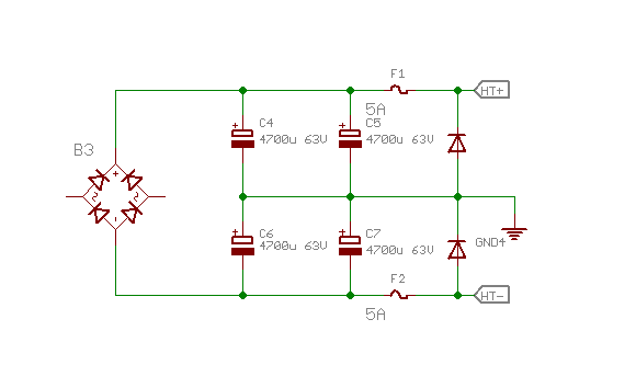

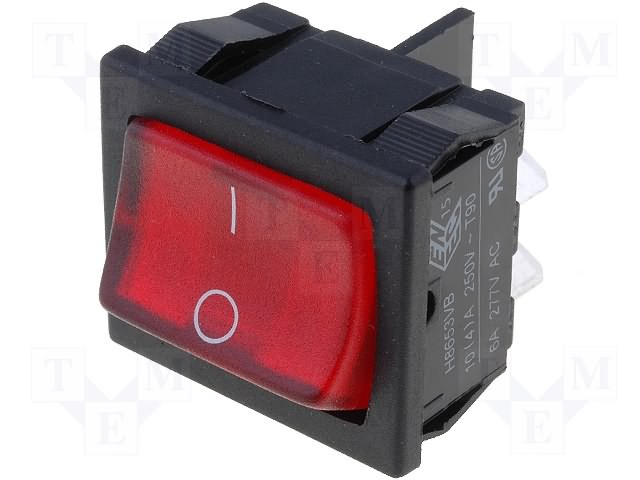

What kind of power switch do you use? Is there possibility of voltage spikes while switching off?
It's a common dpst rocker switch.What kind of power switch do you use? Is there possibility of voltage spikes while switching off?
Ah !
catch diodes from spkr output to both power rails, after the fuses.
catch diodes from power ground to both power rails, after the fuses.

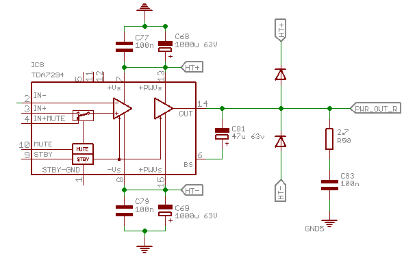

Try adding some catch diodes from the output to the supplies
Something like this (see attached images)?Ah !
Could you explain me their function?
Do you think their absence could cause the chip explosion?
Thank you very much.

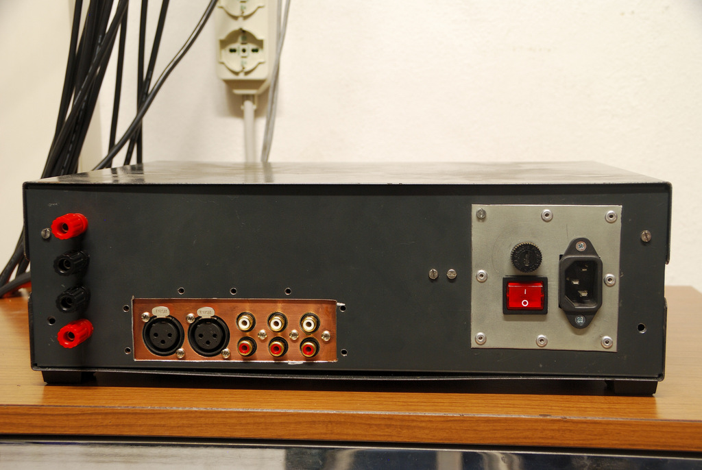

In contrast with my suppositions, the real cause seems to be the switch.
I've made a lot of empiric tests roughly disconnecting power cord, and there's no problem at all. The amp shut down quietly like it's supposed to do.
I forgot to say that the switch is the illuminated type (neon bulb); could it be the cause of my troubles?
Now, what do you think should be the solution?
1: Get rid of the switch and smash it with a big hammer;
2: Use a different switch;
3: Put some protection on the switch to avoid it causing problems;
4: Protect the amplifier from troubles caused by the switch (catch diodes as Jaycee and Andrew suggested);

Add the output catch diodes, and put an X2 rated capacitor across the switch as a "spark killer". If you really want to go the whole hog, fit a MOV across the mains input, after the mains-side fuse.

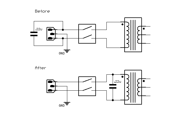

Solved 2
Finally I found the solution.
In contrast with my last supposition, the switch is not guilty (or maybe not too much).
Most of the times this kind of problems are caused by the transformer generated EMF when the power is disconnected. One solution seems to be (lots of different ideas on this topic, see other threads) an X2-rated capacitor across the primary winding.
But... why the problem did show up only using the switch and not unplugging the power cord?
Here's the answer: for the power cord I used a mains inlet connector scavenged from an old computer PSU. This inlet had a .22u cap across mains (plus other two caps from mains to ground). This cap protected my circuit when I disconnected the plug, but not when I turned of the switch. I've moved it after the switch and voila', now I can turn the amplifier on and off and it's all right.
Thanks again to all.

replace that 0.22uF cap with a snubber.
This "problem" points to instability in the amplifier that results in destructive oscillation when the supply rails have some HF on them.
Removing the Rail HF helps avoid the destruction.
But does nothing to cure the instability.

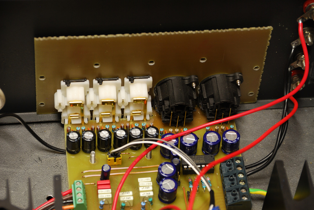

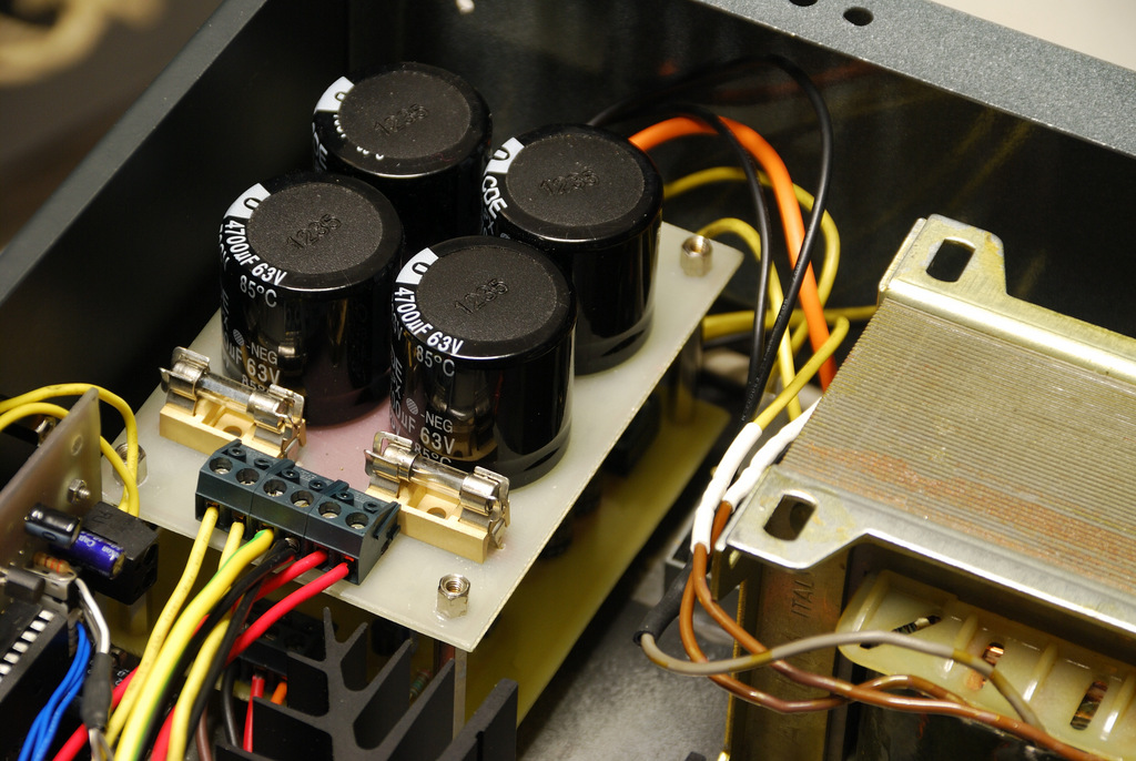

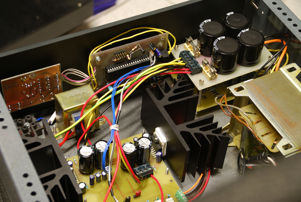

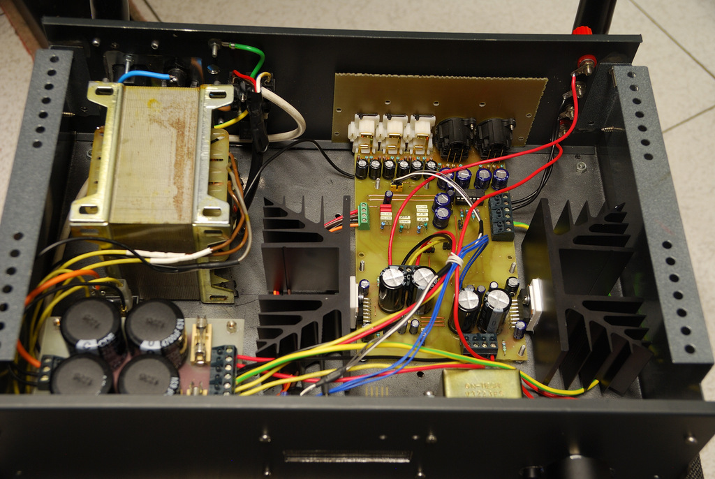

For who's interested, here are some pics of the amp.
Surely not a beauty queen, but it sounds really good in my opinion.
