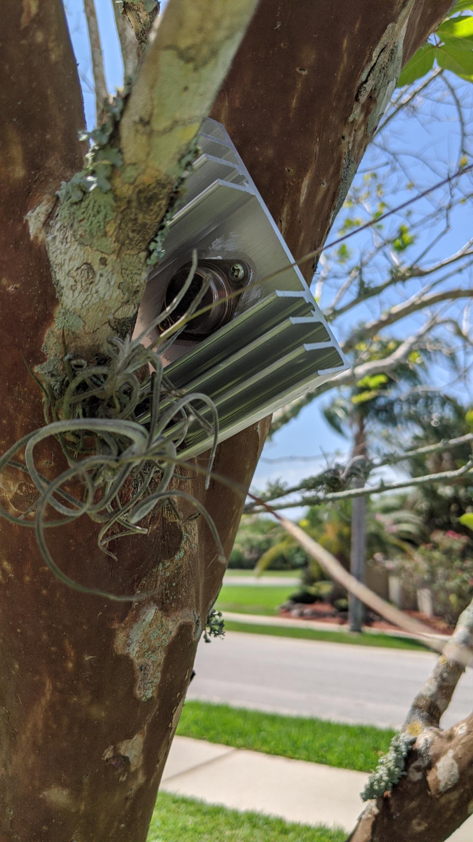

Please show us picture and we can try to estimate the damage.
Here it is. The transistor was blown out of the amplifier, broke a window and landed in a tree in my yard.
A blown transistor can blow in a few ways.
CE, BC or CB or BCE shorted. Or something open circuit.
If both go shorted the fuses should blow.
If one blows open you can sometimes still get an output but distorted.
Just test outputs in circuit and see what you find, that will give a big clue as to what is going on.
You need to work out why it blew as sometimes just replacing it results in another blown transistor.
Could be a bias or DC offset circuit fault.
Or could be a driver transistor gone taking output with it.
So i guess the strategy is to look around and see what has failed and judge what to do from there.
