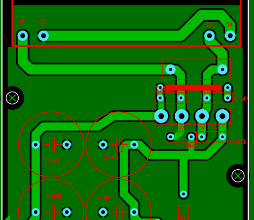

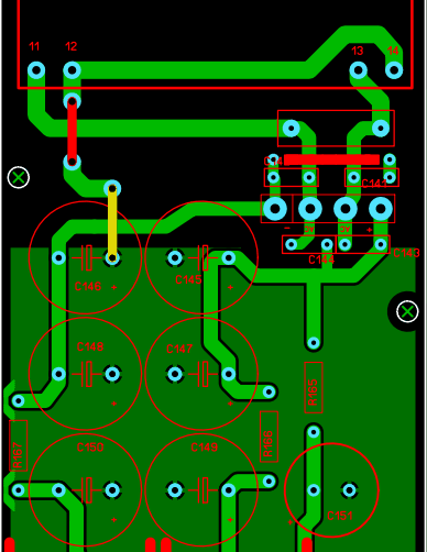

Attached are two pictures that show part of a new psu layout. A one layer board. it shows transformer secondary conection to gnd. two versions of it.
The diode bridge shows a snubber with 4 47nf caps. and a 10nf cap entering the two AC pads.
On the picture V1(left picture) the secondary gnd conection depends on thermal pads near the area of the first filter caps
On the picture V2 (right picture) the secondary gnd connection is taken with traces to the first negative rail capacitor.( Red and yellow traces)
Another point to comment, is the unregulated rail for relays, in the v2 picture. (10R and 1000uf). As the gnd of this capacitor is connected to the plane, and consequently also to the output gnd....¿wouldn't it be responsible in part of the injected pulses into the output?....hmmm
Any comment is wellcome.
¡Thanks a lot!

your ground should be pin 12 and 13, not 12 and 14.

Jay is right.
Your link 12 to 14 is connecting the secondaries out of phase.
You need to swap the two traces that connect to 13 & 14.
Remove the capacitors from your secondaries. Capacitors are not snubbers.
Resistors are snubbers !!!!!
You need resistors across the pins 11 &12 and also aceoss 13 & 14.
To prevent the resistors blowing up, you then add a series capacitor to each resistor.
The combined R+C then acts as a snubber that does not blow up.

Ok!.no caps for snubbers!
With the secondaries wired like the pictures...i got -17,3v and 17,5v at output. But yes, it needs to be corrected. I will post new pictures today if possible.

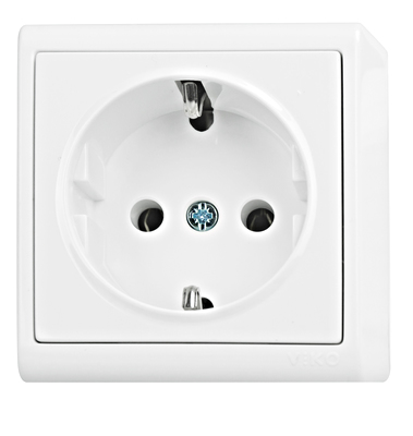

GB/US mains plugs differ from those on the european continent. Schuko plugs (so called in Germany, I think in Spain the same plugs are used) can be connected in 2 directions to the wall socket, so you never know which is neutral and live at your AC inlet.

Nope, at least not here in Croatia.
Do the pins at top and bottom have different projections?
They should prevent a polarised plug being inserted upside down.

They have the same projection, so you can put cable in two ways. You can even
mount the inlet upside down on the wall, so you never know which hole is hot and which hole is neutral.
Only those pins you asked about are always for protective earth. (well not quite so, in some old buildings, those PE pins are jumpered to neutral)
Yes, you are right, there is not only one standard on the continent, but many countries use Schuko as standard. For more information: https://en.wikipedia.org/wiki/SchukoI have not travelled much on the continent, but the few countries I have visited do have polarised sockets.
Schuko sockets are unpolarised, there is no way of differentiating between the two live contacts (line which is approximately 230 V to earth and neutral which is approximately 0 V to earth) unless the voltage to earth is measured prior to use.

The result of your secundary configuration (12, 14 to GND) is a half wave rectifier ( with two diodes working in parallel!), that means the caps get charged only every 20ms instead of 10ms. So you get a doubled ripple voltage and therefore a lower average value at the reg. inputs. This was the reason why I asked for the measured output voltages.Hi!

The voltages, -17,3v and 17,5v are as expected. The 0,2 volts difference in the negative rail...not much problem. thats ok.
Finally for the psu boards i already have made, i found a solution. Cut the part where the trafo sits, so i can place it in a separated board and wire it correctly.

Yes, with 1% tol. resistors for the voltage adjustment at 317/337 this difference is perfectly normal.The voltages, -17,3v and 17,5v are as expected. The 0,2 volts difference in the negative rail...not much problem. thats ok.
You need not to separate the trafo, just interrupt the traces 13/14 and connect it correctly with short pieces of wire.Finally for the psu boards i already have made, i found a solution. Cut the part where the trafo sits, so i can place it in a separated board and wire it correctly.
