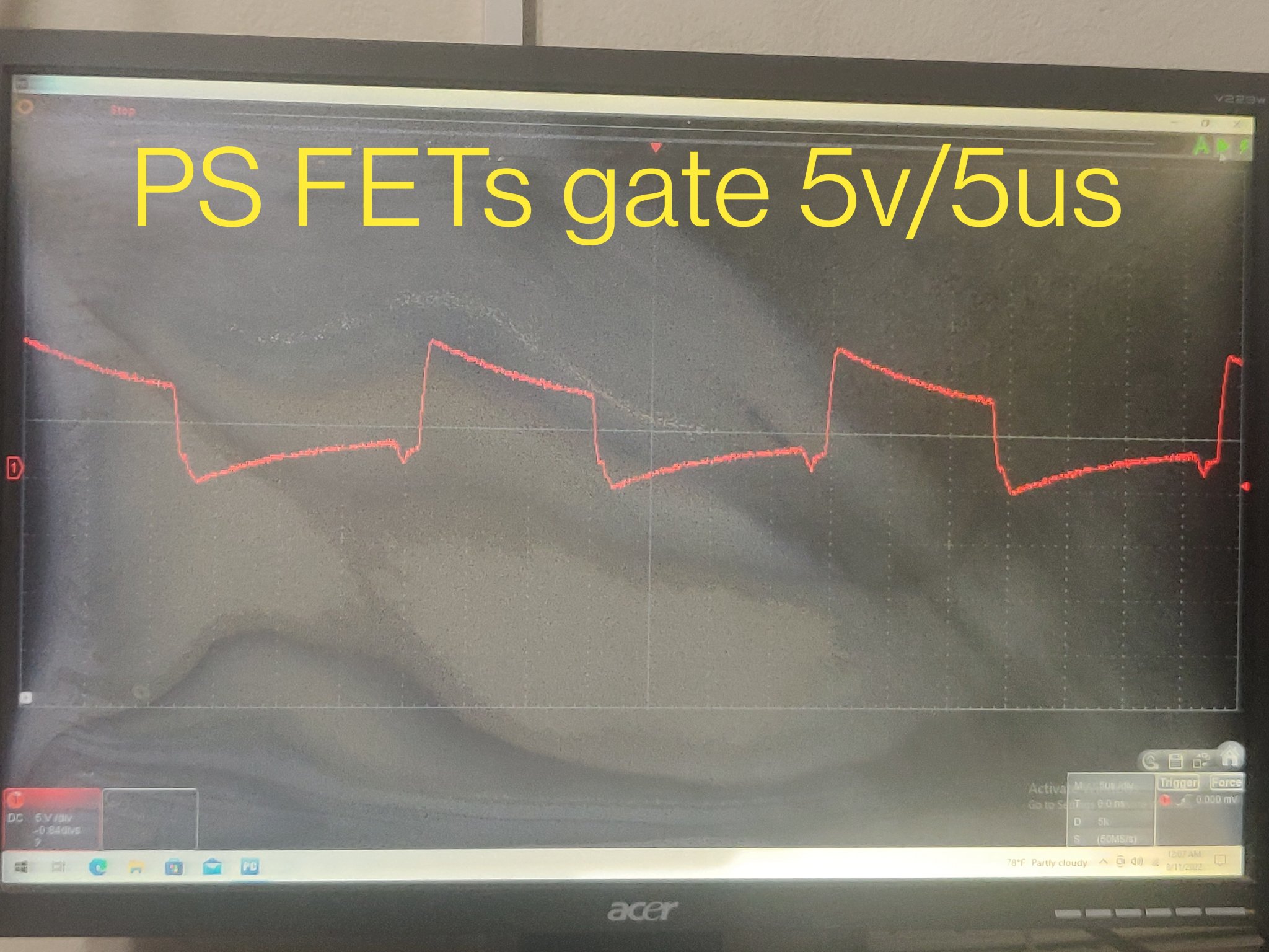

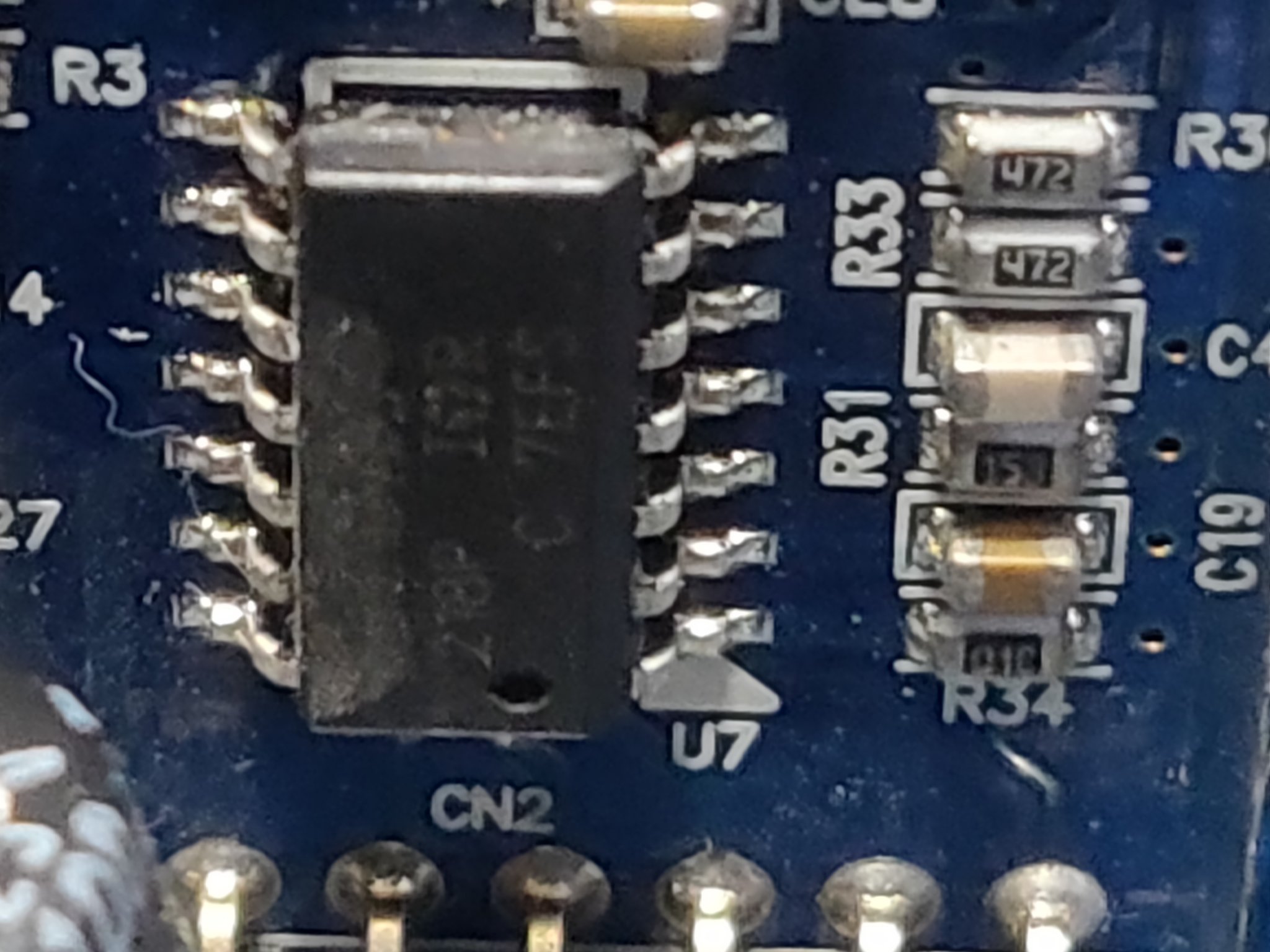

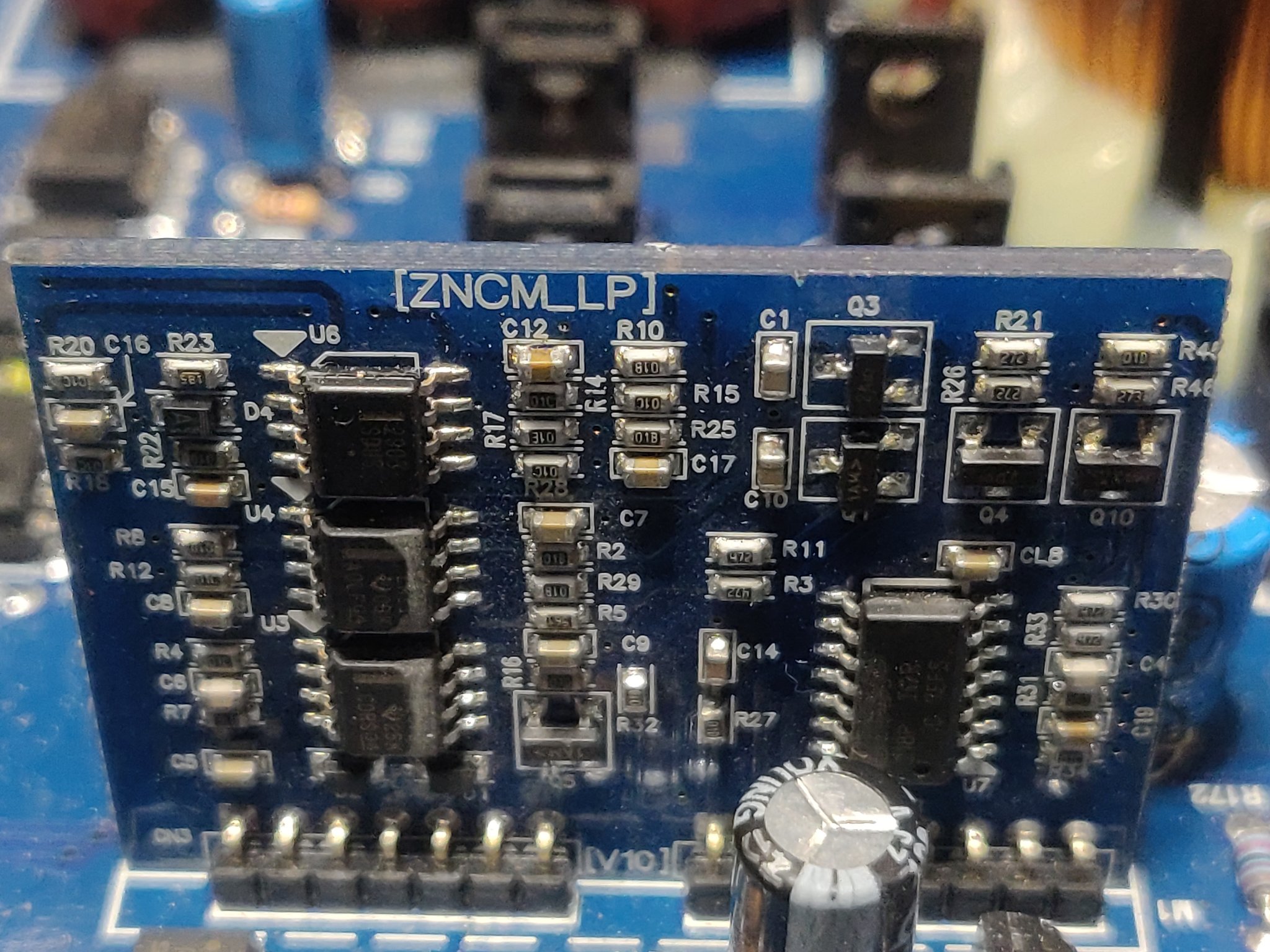

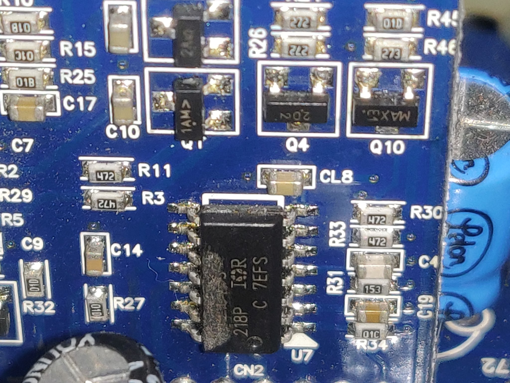

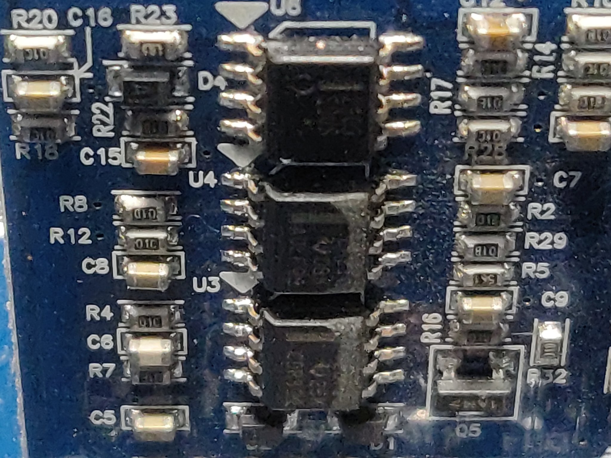

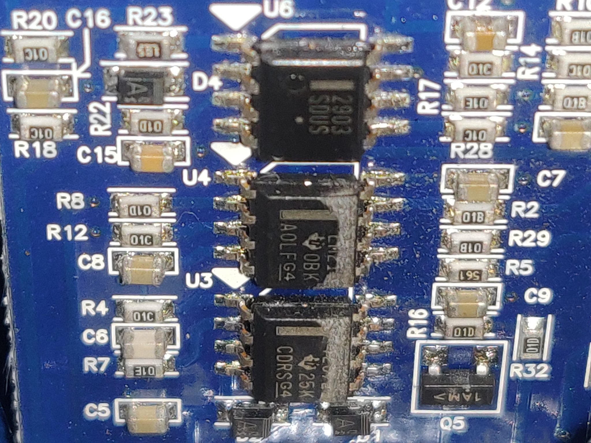

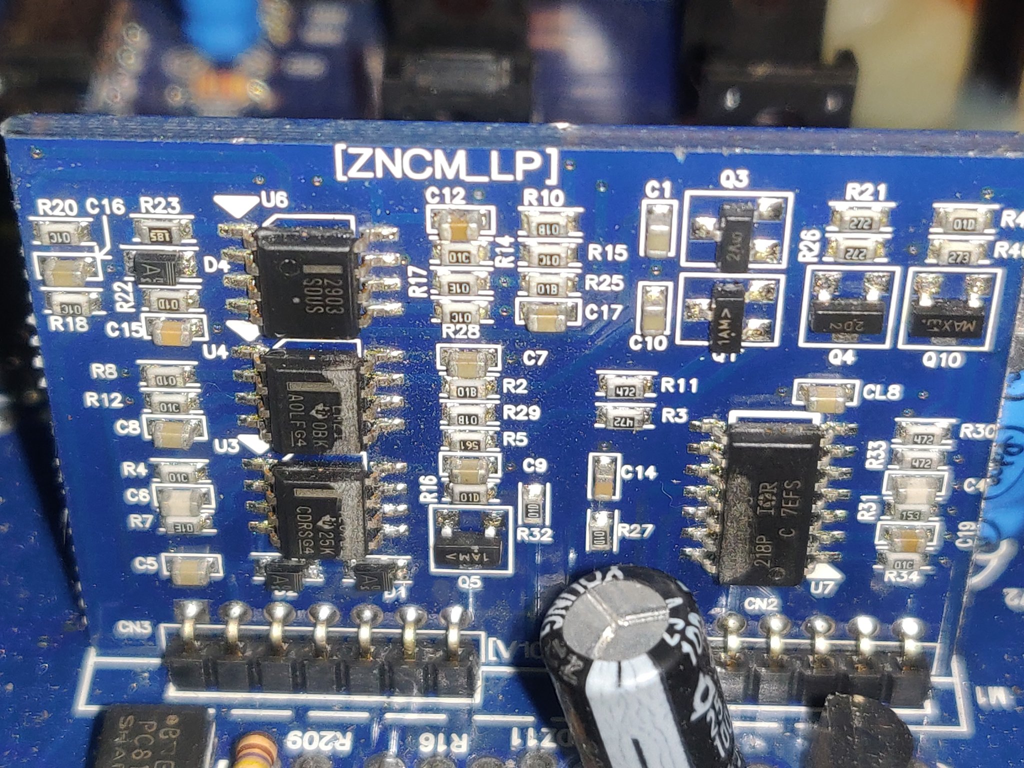

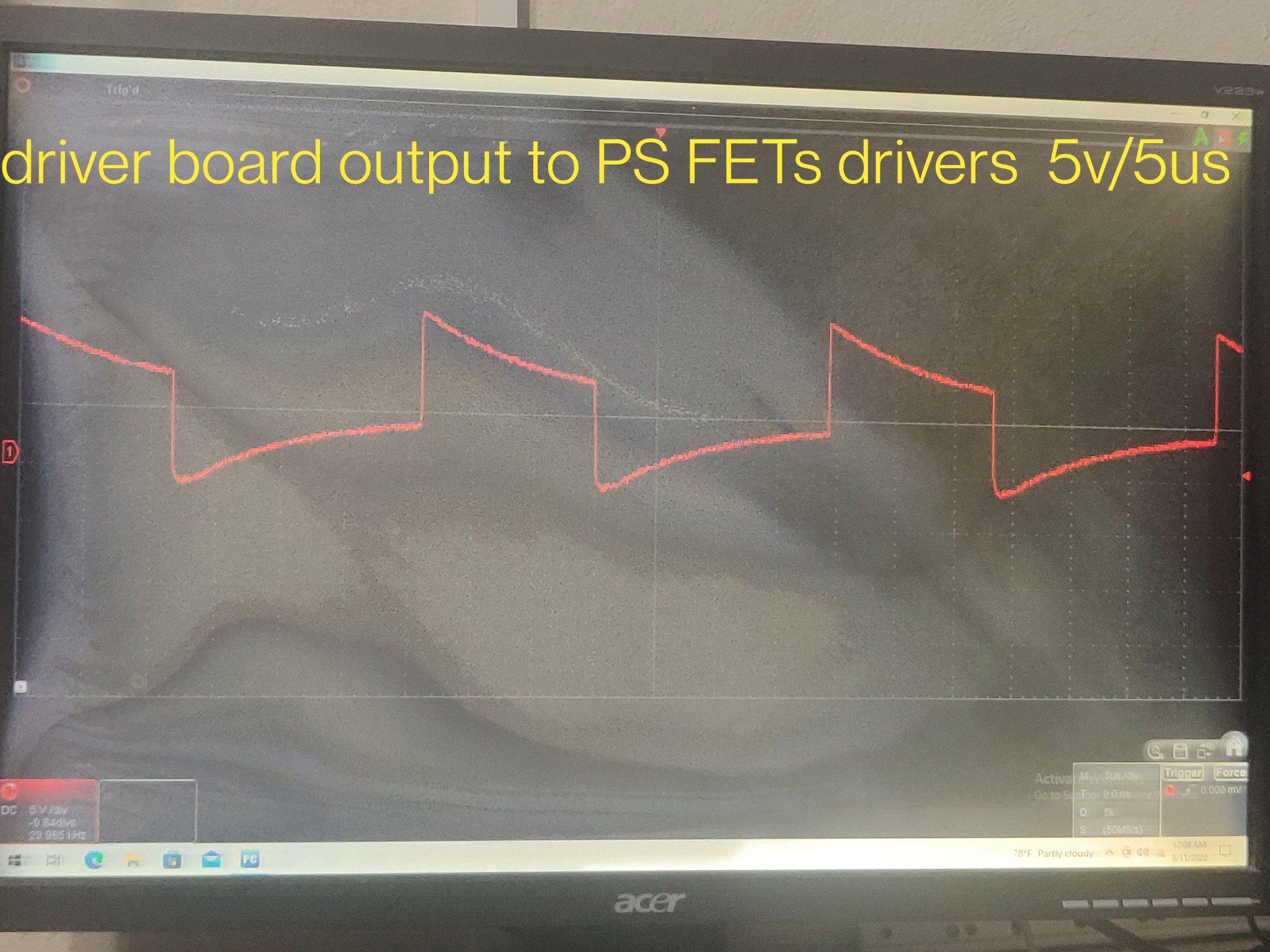

There was some burnt/damaged areas of the circuit board at the gate leg of one PS FET and at the legs of two PS driver ICs, but substitute connections were made and I don't believe there is any conduction from those areas. I was thinking that PS issue was a non-issue due to the stable ±rail voltage, the amp operating without protection and that the heat is from the output section.
Do you have a FLIR imager?
Does it heat up at idle?

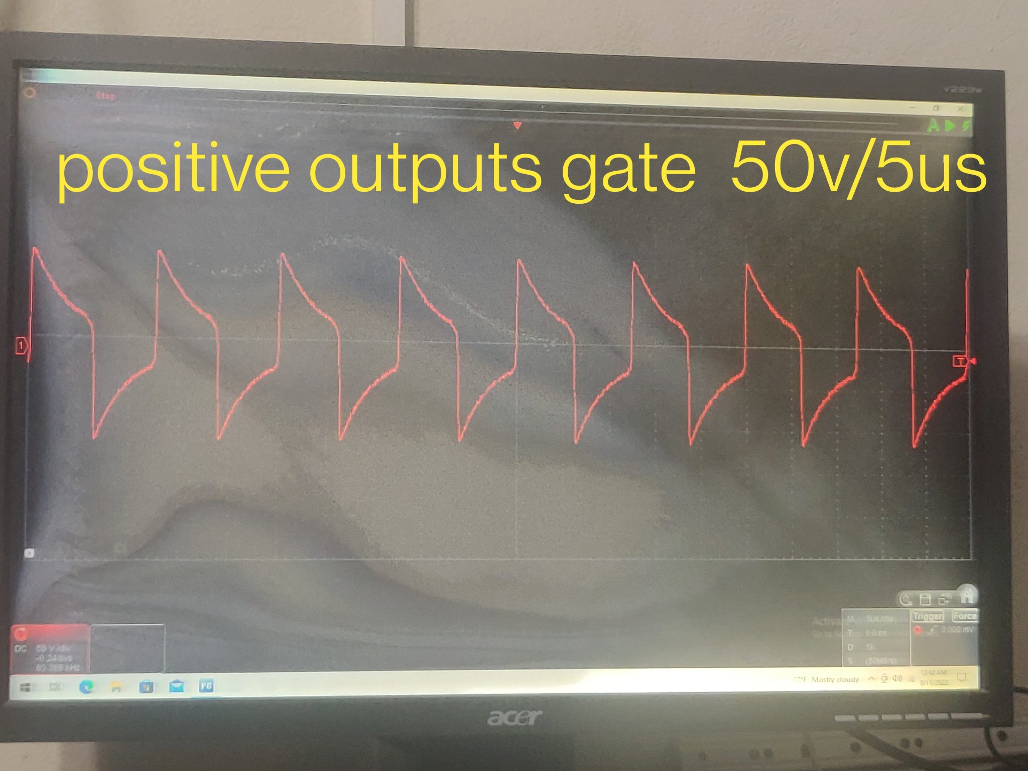

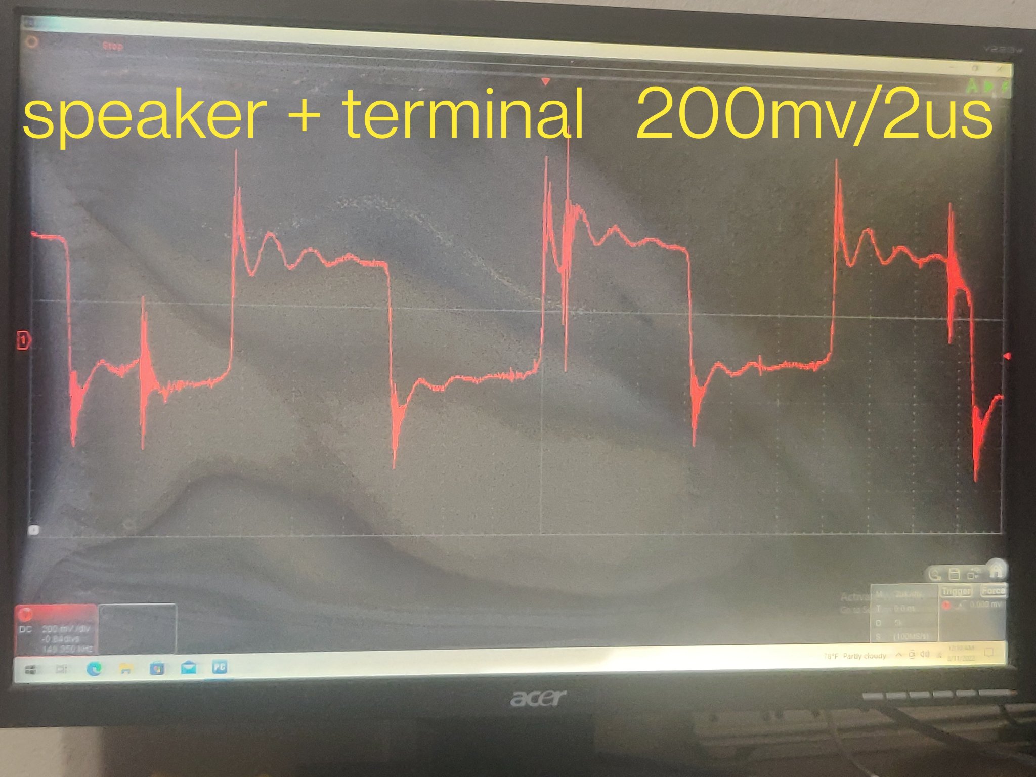

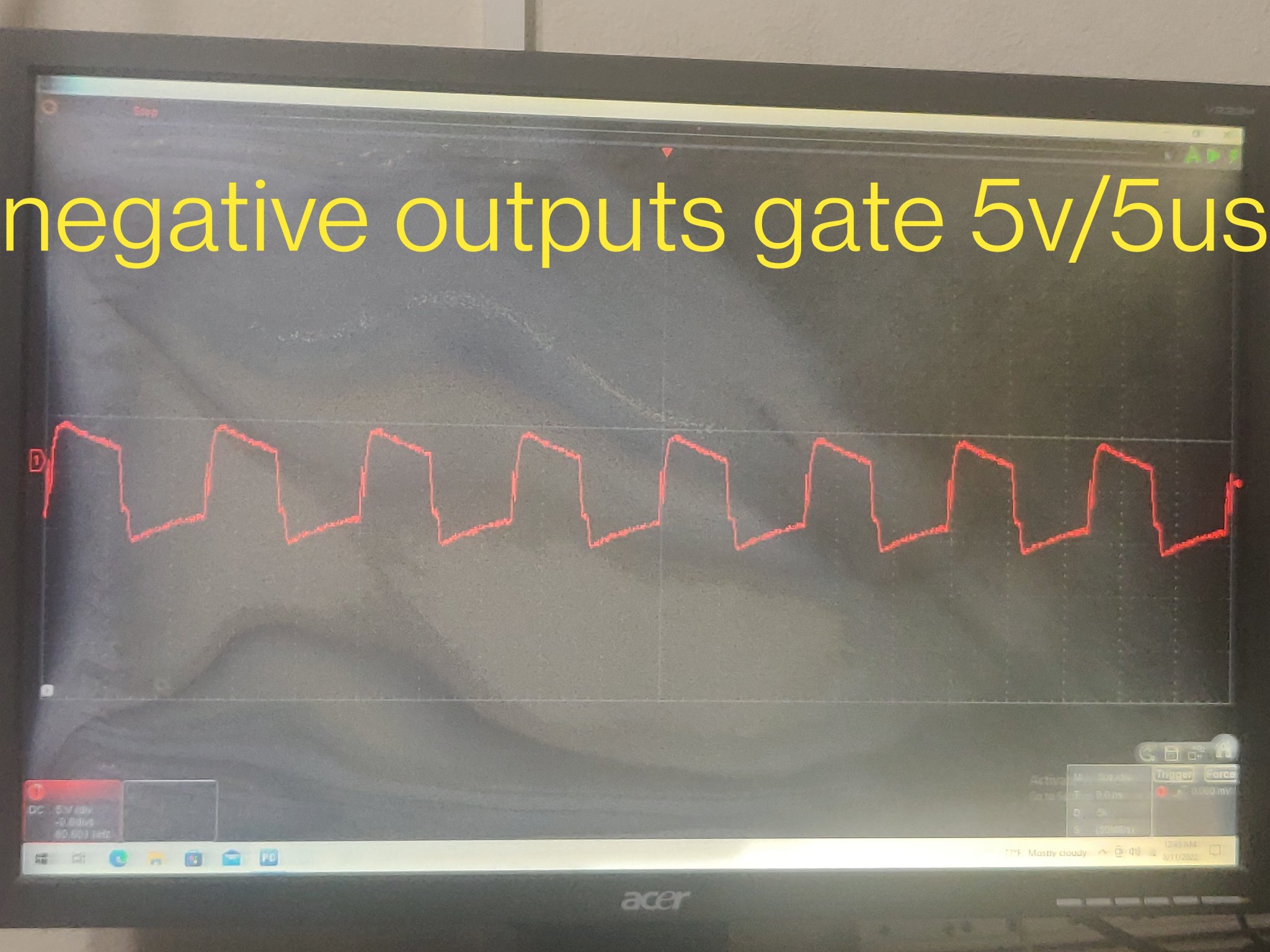

Did you look at the individual gate signals on the outputs to confirm that all were good?
