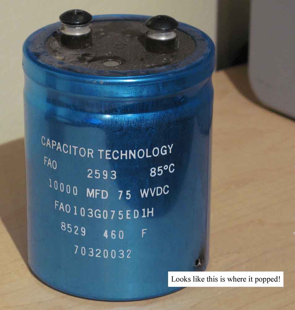

Blown Capacitor in Peavey CS-400
I have emailed parts@peavey.com for help getting a replacement capacitor, but no response. Does anyone know what kind of capacitor I need and where I can buy one, either locally in Metro Detroit, MI or online.
Details:
CAPACITOR TECHNOLOGY
FAO 2593 85 Deg C
10000 MFD 75 WVDC
FAO103G075ED1H
8529 460 F
70320032
Thanks,
Martin

I would suggest either calling Peavey and getting a hold of their service department or contacting someone like Mouser and giving them the PN off the cap so it can be crossed to another brand.
It would be very easy to go on line punch in the cap size, pick one of the same rating and puchase it. It sounds like you are talking about a power supply cap and therefore I would advise in changing both of them. I am assuming there is only 2 and not a bank of them.

You will need to know the cap diameter,height, working voltage, how many mfd, and mounting type. Example of mounting type is it soldered to the PC board or is it a screw terminal? When you know the answer to these questions you can call Mouser and talk to a sales person or go on line and find a suitable replacement pair.
Post a picture please
Does this help?
Is Mouser a store? Do you have a number?

As for the capacitor, what makes you think it's blown?

Has a hole in it! An oily residue has also leaked out.
Is the fuse blown?
No... I opened the cover and turned it on. Every 10 seconds or so there was an electrical arcing from the capacitor.
The pic should be attached correctly this time!

OK, then that CDE cap suggested by me would fit. I hope that the + 1/2" in the diameter won't be a problem. Height is just the same - what a luck!
Other parameters are the same too: 10.000uF, 75WVDC, 85°, screw terminals.

Thanks for this link: Do you think they would work for my Amp?
Your welcome
Measure and see. Sorry I can't be of more help. To be honest I don't remember the layout of this particular amp. Are the caps around anything else that would cause a problem? I would assume that they are by themselves and you would only have to worry about being able to make a slight movement in the brackets. I would guess it is do able. You may have to change the brackets. In the past I have been able to squeeze a larger cap into that size bracket. You may have to play with the mounting tabs.
