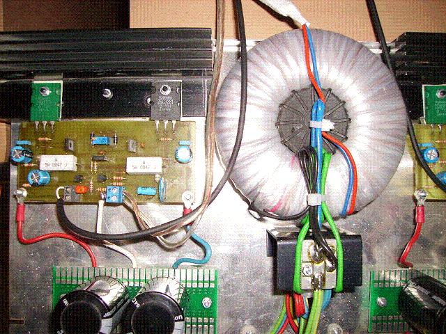

it worked great for about 3 hours with perfect sound, low distortion, great response and then I heard a fizzle sound and the bd139 and bd140 transistors blew. I replaced them and they blow again as soon as I turn the amp on.

Inspect the 220 Ohms resistors and if the output transistors 3055/2955 are not burned.
If they are burned, when you put new drivers BD139/140, they immediately burn...
PS: Inspect also the 0,22 Ohms resistors

is almost impossible to fail ..... whats the rail voltage ???
and also have you got original pcb or home made ???? is the caps values correct or you made something that creates some ocilation together with a bad pcb ????
this is made it hink for rails 30+30 volts max ...higher rail voltage will not possible for this amp

34.5 is not much but cooler of a procesor from a pc might not be enough ....
meaning that if you have just a bit toomuch idle .....then all thing gets too warm and then boom .... put a decent heatsink allow proper insulation be tween transistors and then all will be fine ....
you might consider going to project 3 a that has ajustable idle
will work like hell and also plays very fine

on vas amplifier bd139 there is capacitor that should remain 100 pf ..... 150pf will have alot of effect in the quality of sound .....
about the second driver bd140 this change of 50pf more i dont know what really effects
also in a version i made 100mf decoupling caps are located very next to the power transistors conected to rails and ground ..... very nice improovement also

An obvious question, and one that no one has posed so far, is: Where did you buy the output transistors, and is there a possibility that they are counterfeit?
'Work for a while and suddenly go "BOOM"' is a common symptom of getting bitten by counterfeit devices.

From my experience and after a looking in the amp. schematic, i have two remarks. The first it is that, this amp. has a CFP type output stage. The other type - and most commonly used - it is the EF output. In comparisson between them, the CFP appeared as some better in frequency response but it is also most delicate from the EF which is by far most rugged. Also in class AB the CFP output produces more heat than EF in iddle state thus it needs bigger heatsinks. A concrect drawback of CFP it is that, if the output transistor blocked i.e. under a saturation condition, then all the output current pass through the smallest driver to the load and then it destroyed. You can make as i think an easy experiment to convert the output in EF. Leave as they are the drivers, move the 220Ù resistors between the emitters of BDs and the output rail, connect the collectors of BDs in supply rails, interchange the output transistors between them (3055 in +supply rail and 2955 in -rail) disconnect the base of each output transistor from the collector of each driver and reconnect it in the emiter of the driver. Leave the collector of each output transistor connected in supply rails directly. Thus you can obtain a EF arrangement in output. Try it and make a comparison in ruggedness and the sound quality. One more remark, it is the absence at least of the output clamping diodes which protect the output devices from the unwanted returned currents from the load to the output transistors during the opposite cycle of output swing, which can apply a peak voltage of 70V (in your case with the +/-35V supply level) accross the c-e contacts of the inactive transistor during this momment and don't forget that although 3055-2955 has a Ic=16A their Vce it is only 60V. Place two 1N4004 (for certainity) each one accross the output rail and each one of the supply rails in a reverse connection. Be carefull to include also the emitter resistors into!
I think you resolve your problem with this modification.

this amplifier i constructed for fun bud not exactly the 03 but the 03a..... including a vbem with the transistor bc 549....
created a nice pcb added 0.1mf +100mf very next to output transistors also used 42+42 rails idle about 120ma and banks of 2*10.000 mfd per amplifier board .....outputs with the very original 2SA1302+2SC3281
