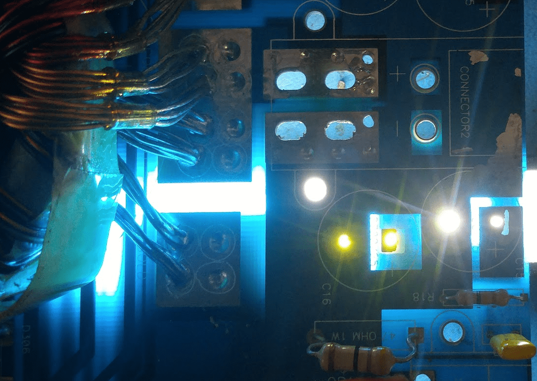

Shone the light from the back of the board. Do you see any 'shadows' in the fiberglass around any of the pads, in that area?
If the light won't shine through metal, it's not 'bright'.
I'm looking for contamination of the board. When there is electrolyte that has saturated the board, there is usually a sort of shadow. I don't see it in your boards.

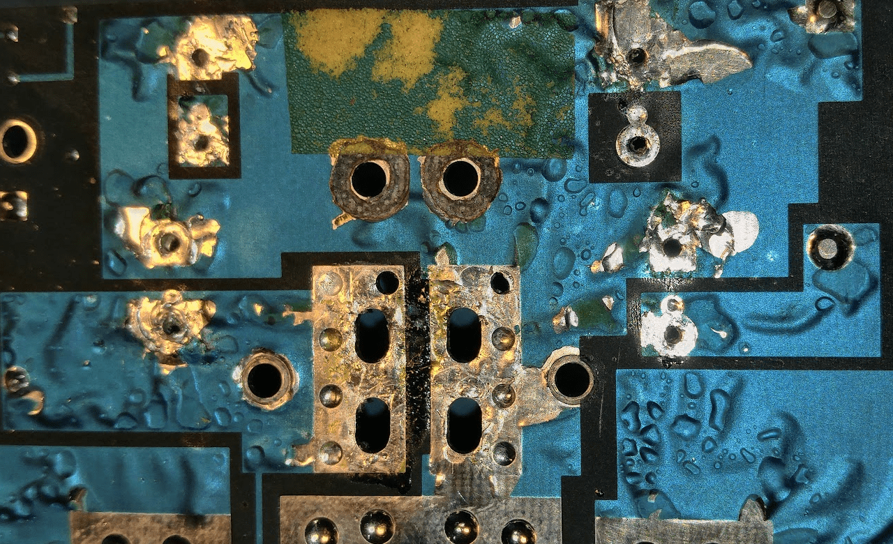

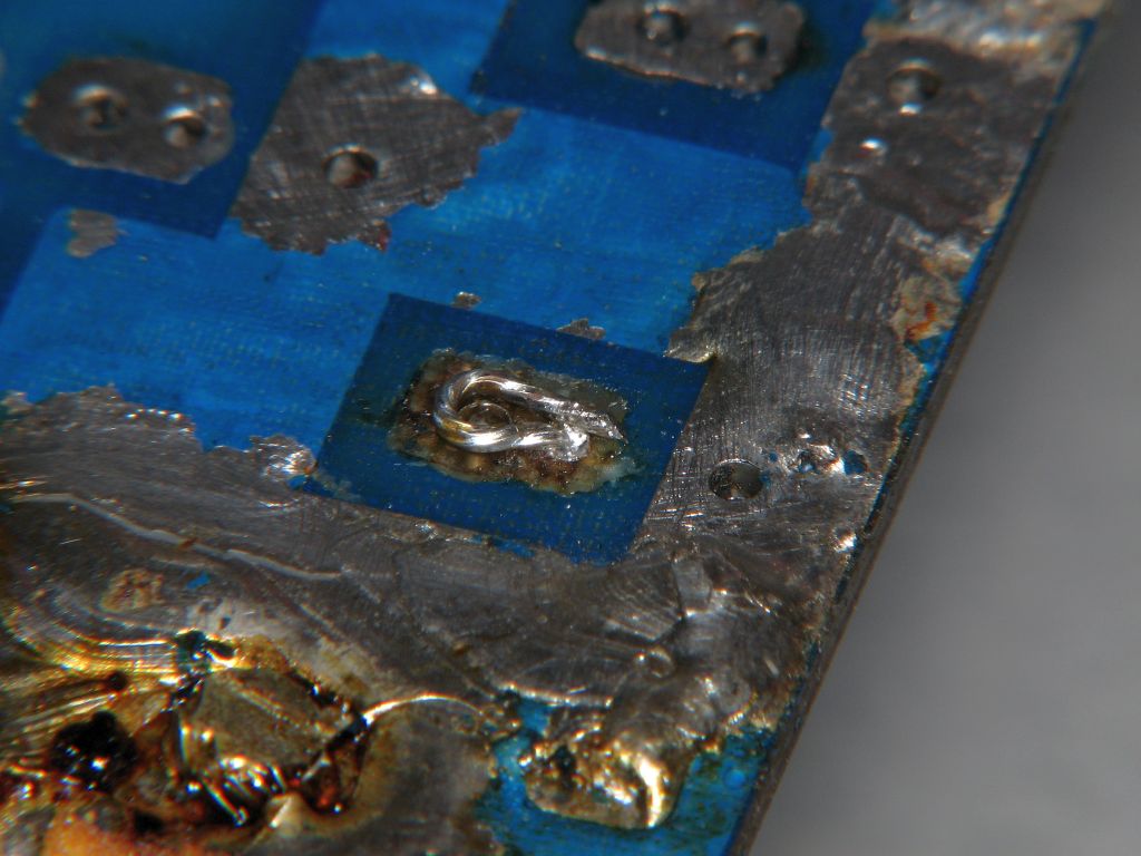

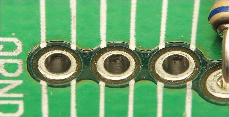

I am, however, concerned that the vias are damaged. The top solder pads have an adjacent hole (via) on top of the board, clean that out and insert a piece of wire that will solder onto the top and bottom of the board to ensure that there is a solid electrical connection between the solder on the lead on the bottom of the board and the top pad on the board.
It will look something like the attached image on the top and bottom of the board.
The only vias that would have been impacted are the holes for the component itself. When I solder the new one in, that should connect the two layers.
OK, thanks for the tip. I will make sure they are electrically connected when I install the new parts.
