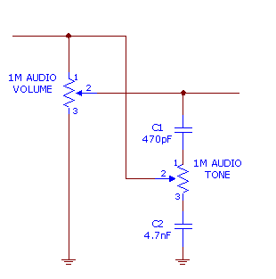

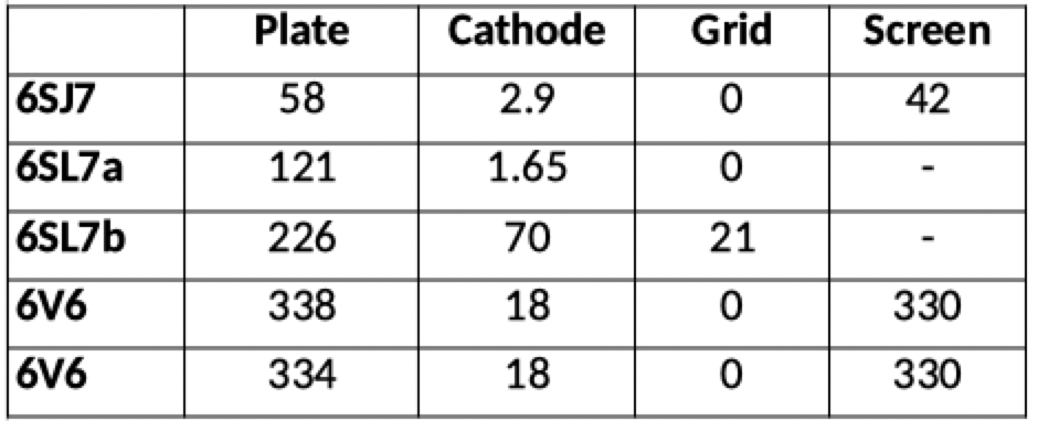

I could use some help figuring this out. My first build is a Bell & Howell projector amp converted to a guitar amp. It's a 6V6 push-pull with a 5Y3 rectifier, 6SJ7 pentode first stage and a 6SL7 dual triode driver/PI stage. I was shooting for something like a Fender Deluxe and used the original Deluxe tone circuit. The fuse is a 2A 5mm x 20mm slo-bio. The schematic is attached. Also a table of the measured voltages.

I se at least one error on the diagram, you have no CT on the PT secondary. And for that matter no heater wiring. But it leads me to wonder if your mains side wiring is accurate or if you just drew a generic mains circuit. perhaps your mains plug is mis=wired so the fuse winds up across the neutral and hot. On teh variac, the wiring may be reversed.

@Enzo:Yes, it's a simplified schematic, sorry for the confusion I caused. There is a CT off the HT secondary and it's grounded to chassis with the mains ground/earth. However it does show the actual wiring: mains "Hot" through the fuse and then to the switch and then into the PT primary. I thought that was best practice. Is it actually the problem?
