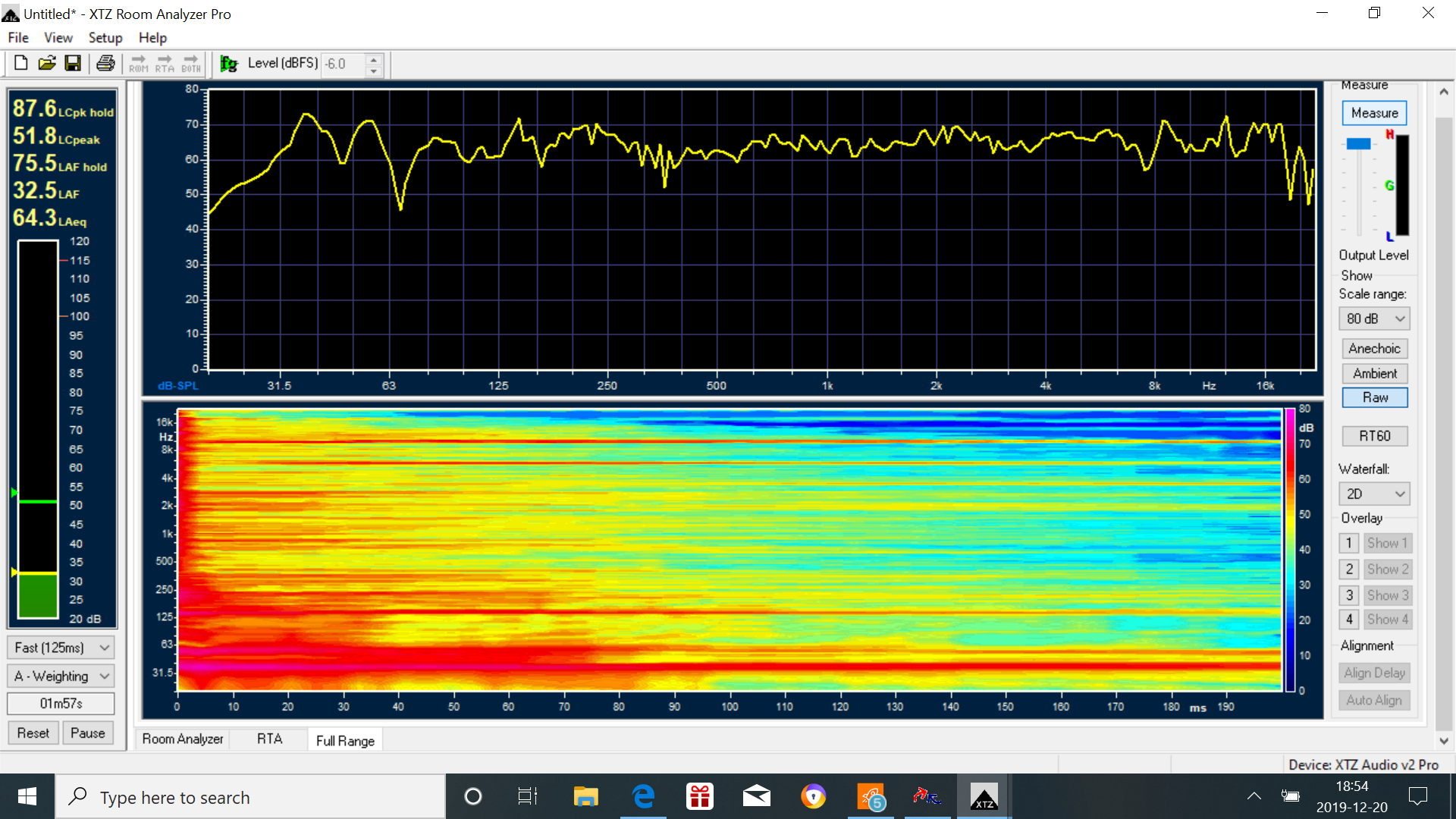

Measurement distance at 60cm
Hey Jon, please accept my apology for my previous BS call...
That call was predicated solely on the well known difficulty of getting a CD down to 320 Hz, and a prosound 10" up to 7200Hz.
Your radian CD and kappalite 10", at moderate SPL's sufficient for your tests, meet that difficulty, ime/imo.
I've run bms coax CD's and the new b&c coaxial ring radiator down to 300Hz, at indoor SPL levels. And the kappalite 10" is a driver I'm familar with, as a candidate in synergies I'm building.
I have no experience with any of the other drivers, but they caused me no concern at all.
Because I do agree that you can equalize drivers with sufficient bandwidth and adequate SPL, to most likely sound similar enough to make ABX identification nearly impossible. Especially in a closely held, fairly tight on-axis, listening position.
Further information in this thread makes me tip my hat to the work you've done. 🙂
