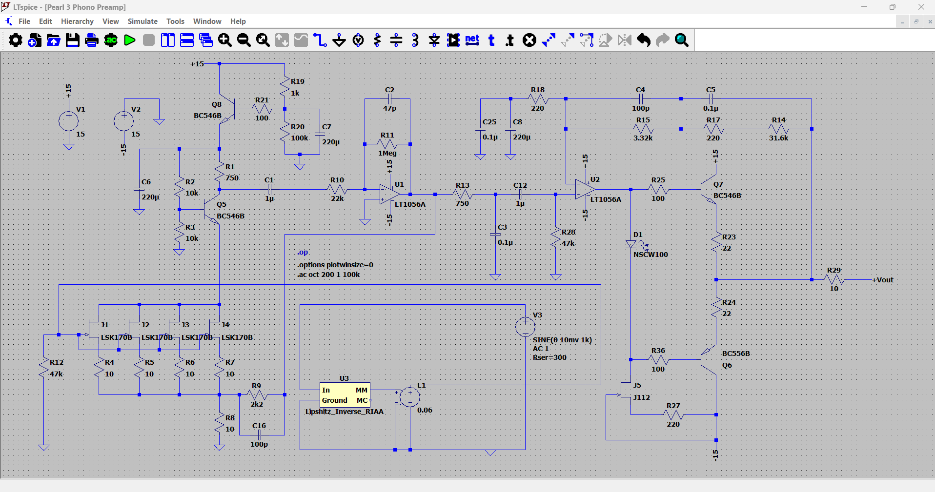

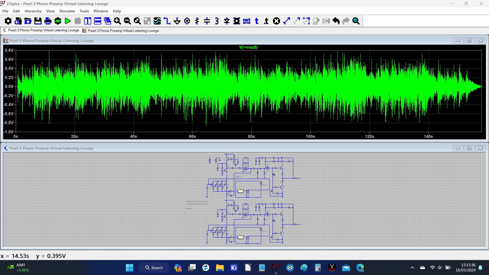

Getting mildly interested for a rainy Saturday afternoon I simulated the Pearl and created an inverse RIAA using component values from Stanley Lipshitz and Walt Jung taken from an old Wireless World magazine. Now the fun starts, recording the output of the Pearl (the simulation). With hindsight I should have fed more signal in and attenuated the main output but as it is the output levels were just within the -/+1 volt pk/pk output .wav limit of LTspice. The circuit was duplicated and ran in 'stereo'. E1 is set at just 0.06 meaning the output is attenuated by that factor.
For anyone interested here is the result and a 320kbps MP3 file is attached at the end. One channel output shown here.
There is an educational 741 model in LTspice that uses all discrete transistors based on the actual 741 topology, now that could be a challenge to use that but I suspect the sim would take forever to run. The standard opamp models work totally differently.
Anyhoo... this took about 25 minutes to run and complete.
One channel before duplication.

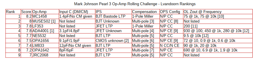

Thanks for all that work @Mooly! I'm in a similar situation, interested but not a vinyl listener. I put together a spreadsheet with some specs different from those in @Mark Johnson's spreadsheet. There's a correlation between input capacitance and preference but with only 5 of 9 op-amps having input capacitance specs, 2 of which only provide differential mode, I'm not drawing any firm conclusions. It would be nice if JRC put a little more data in the datasheet but so it goes...

1458 is completely stable and can hit 20k at a few volts before slew distortion hits. It is also fairly low noise. Not completely shocked here.
LF353 is an excellent op amp I have used for 30 years that is virtually impossible to beat.
Thanks Monk55, doctor visit went beautifully and I'm back at full strength. You'll notice that for this experiment, I chose not to include duplicate opamp-pairs in the blind listening test. If the first pair of WXYZ opamps sounded much much better than the second pair of identical WXYZ opamps, that might be noteworthy (so said a few armchair quarterbacks). But I ran out of patience after sourcing, assembling, and anonymizing fourteen SOIC opamps on DIP adapters. Seven unique pairs of jolly interesting opamp chips was about my limit.

What a revelation...... The oldest and slowest get´s the best subjective review.
