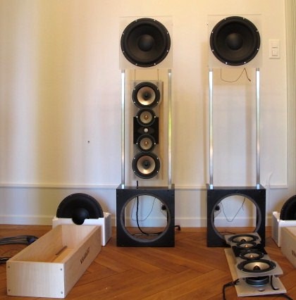

Needless to say, I won't be installing this tweeter without having its own dedicated sub-compartment in the enclosure. I dont trust any adhesive sticking to that slick surface over the long haul. I'll be using a RTV based sealant made for glass surfaces to reattach the chamber.

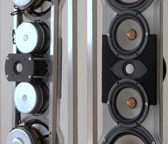

I have a pair of T34B working perfectly since 2020, never experienced high frequency performance of this level other than with my old Apogee FR.
I will replace the T34B with quadruple T25B, similar method to the LX-521. I have already the T25B.

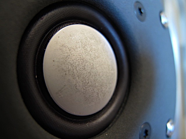

Well, I'm not here to bash Bliesma. I just wanted to show what the driver looked like inside, as most people will never see this given the circumstances.
