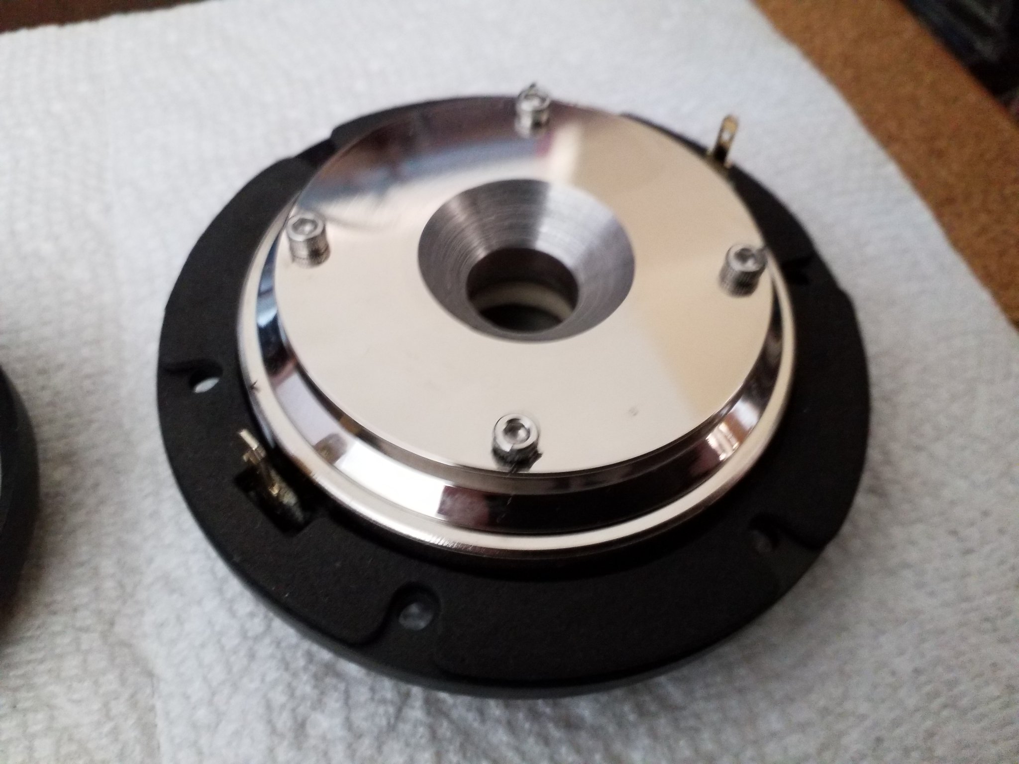

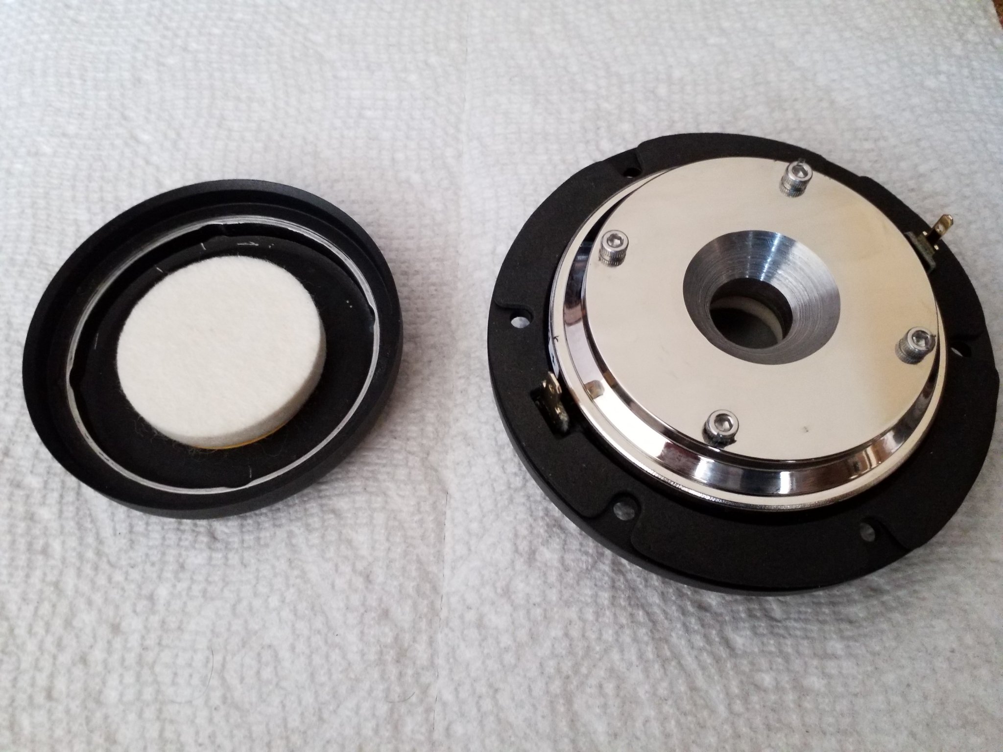

I just received my T34B tweeters today and got all excited to open them up and admire the fine European craftsmanship, but what i found instead was a back chamber of a driver had come off in transit. The other one still was intact but I only needed to pry very lightly and it came off as well.
The problem is they glued the chamber onto the polished and plated surface of the magnet asy. The magnet surface isn't rough enough to adhere to the adhesive they used so it can get a good bite on it. Needless to say I'm not impressed. At least you guys can see what these things look like inside. There is a 35mm disc of wool felt for dampening inside the chamber. Nothing fancy. I swept both drivers without chambers and they both sound fine, so I'll glue to chambers back on again.

Needless to say, I won't be installing this tweeter without having its own dedicated sub-compartment in the enclosure. I dont trust any adhesive sticking to that slick surface over the long haul. I'll be using a RTV based sealant made for glass surfaces to reattach the chamber.
My only other guess is US customs opened them up and poked inside, but ithey usually post a note they did that.
I'm pretty sure it's an adhesive issue, due to how easy the other one came apart. That slick surface on the magnet won't hold onto adhesive well and it appears they used some sort of thermo-adhesive ie. hot melt glue. There was zero adhesive residue on the magnet, which tells me it wasn't a good bond to start with.
Well at least everyone can see how these are made. Compared to other brands of Be tweeters, these are actually relatively inexpensive. Just one of the new Seas Be domes will cost the same as what a pair of these T34Bs cost me.
Two adhesion failures out of two samples... that is statistically significant. If it is a bad batch of adhesive, then you plan to use an RTV glass window sealant is a good plan. However, it could also be a broken process for surface preparation, in which case the surface could still be unready for adhesive. It may be contaminated with a release agent, a lubricant, or silicone residue. If the surface is not cleaned and prepped, the new adhesive may fail also.

The lighting from the camera doesn't show the accurate picture. It's showing alot of surface texture rather than the actual color / hue of the finish itself. It's a chrome or nickel plating, likely to protect the neo magnet material. I'll try to get better pictures in daylight.
I agree about the surface prep issue. The powder coating on the back chamber was clearly not fully cured, as some of it was left behind on the adhesive. The type of adhesive matters too. It was some sort of thermoset adhesive aka hot melt glue. The box was very warm when I got it from delivery, which could have weakened the glue, likely from the 115 degree weather we're having here in AZ.
Either way, I'm going to re-attach the chambers after careful surface prep and go from there. If it's all ok after that, I'll just chalk it up as human error and deal with it. Stuff happens and its a hand made, small batch product. Hopefully the only issue is whats in front of me and life goes on.

Having a materials engineering background, I can clearly see its a surface prep and adhesive application issue. They should have used some form of bolt on /screw on attachment to secure the chambers. Just adhesive alone is not enough for something like a high vibration area prone to weakening by heat and vibration in transport and use. I could have planned to use a more permanent type of adhesive, but that will hinder serviceability of the driver in thr future, which Is important to retain.
