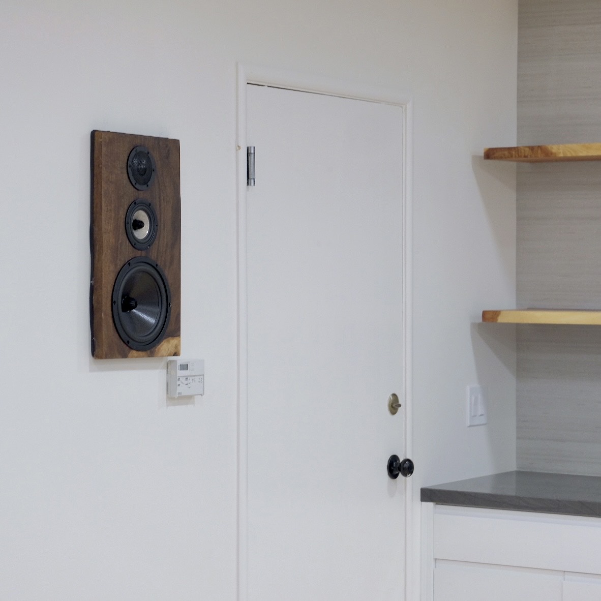

I have the T34A in some in-wall speakers that I built. They are very nice tweeters. The large dome size has an effortlessness that is reminiscent of AMT tweeters when playing cymbals. It also allows me to use first-order filter, which I prefer. I've been happy with them. I have not heard the T34B. I avoid Beryllium because the toxicity is a turn-off for me. But toxicity aside, I think the T34A is already beyond the point of diminishing returns and I doubt you'd do much better with the T34B.
The biggest downside to all of the Bliesma drivers is the cost. Lately I've been experimenting with using a MarkAudio Alpair 7ms as a tweeter, and find that it is nearly as good as the Bliesmas in that role and significantly less expensive. But if you have the budget, the Bliesmas are great.

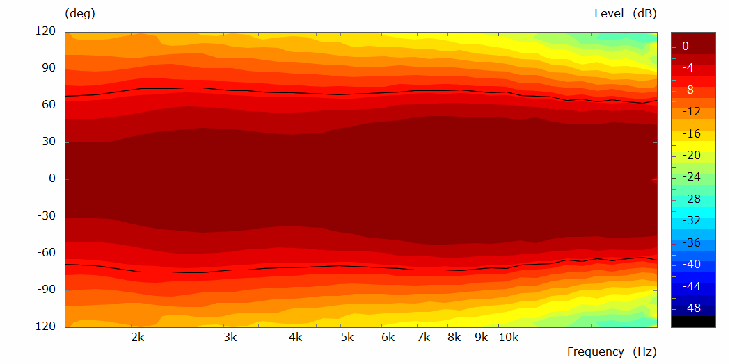

Do you have any measurements or comparison of this WG with the T34B and A? With the deeper wavegudies the A version is pretty bad ...(the deeper the dome, the better
This all stems from comparative simulations (which, for rigid domes, match the reality very well):

Deeper waveguides can behave differently. Only beware that for such wide-radiating sources, the shape of the enclosure around the waveguide becomes as important.

And this is what a good waveguide can do for you, which is just amazing -
1) in a waveguide:

It has been some time since I played with this, but I wouldn't expect T34A to work optimally in that waveguide, which was really optimized for the T34B.
T34B has a 7mm deep dome, while T34A is 10.5 mm, allowing for even a wider coverage, so the waveguide should also be a bit different (shallower, basically).
- It's possbile to simulate this easily (including an enclosure) with the tools I've been working on: https://www.diyaudio.com/community/...-design-the-easy-way-ath4.338806/post-7353694 and either ABEC or AKABAK.
Interestingly, the smaller domes don't seem to have any advantage here.
T34A prefers to be more like +/- 70 degrees in the waveguide, overall box size, shape and edge rounding changes thigs quite a lot with such a wide radiation. With a little bit of trial error in Ath it is possible to get something that looks like this.
