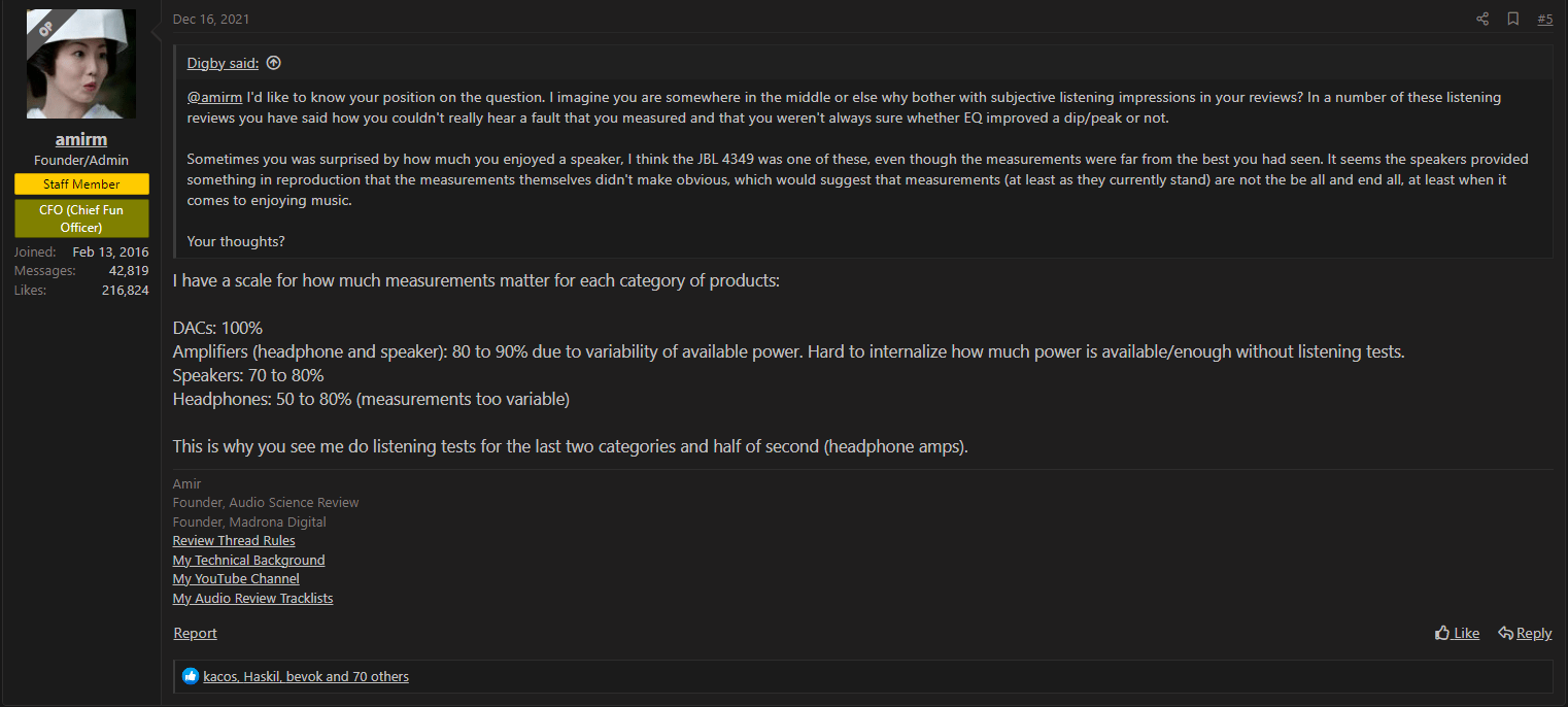

On the other hand, even Amir from ASR admits that his speaker measurements only correlate about 80% to perceived sound (can't find those posts now) and often says that distortion is relative
Edit: Found the post

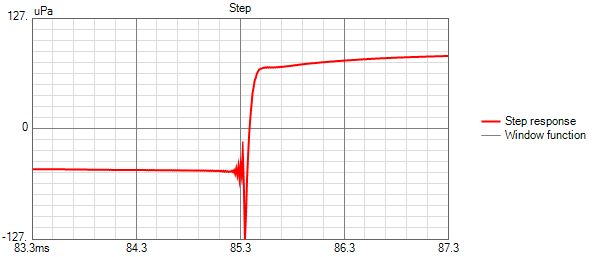

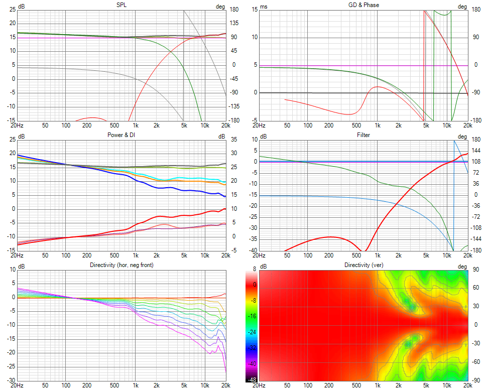

I also tried a crossover variation using the technique Joe Rassmussen employs in the Elsinore, a very low order blend, steepening up an octave below the crossover point with tweeter inverted so that as the tweeters impulse rises back up it meets the woofer. The M74P's twin resonant peaks might make this difficult in real life, or maybe not. I am interested in testing differences in vertical directivity in the next few designs I make. The six pack image also has the Horizontal ERDI, to show that it is the vertical response that causes the DI to vary.
