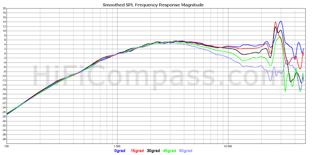

Bliesma 34 Berilyum, somebody compare with another berylium tweeter?
Bliesma 34 Berylium.
Somebody compare with another berylium tweeter?
Is really so good?

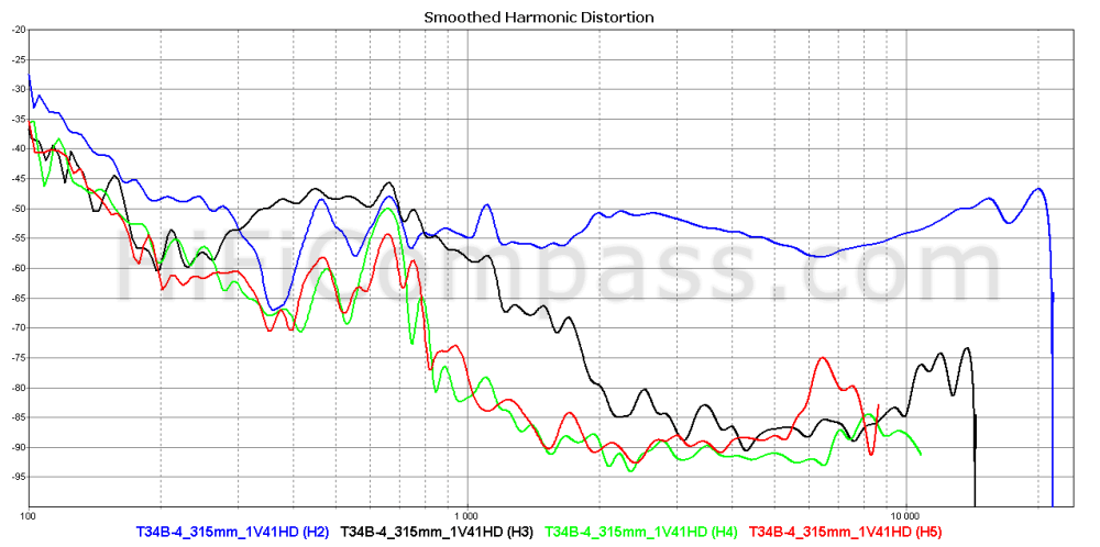

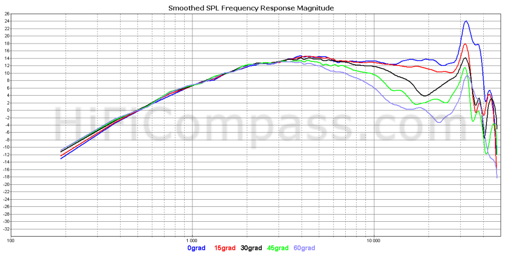

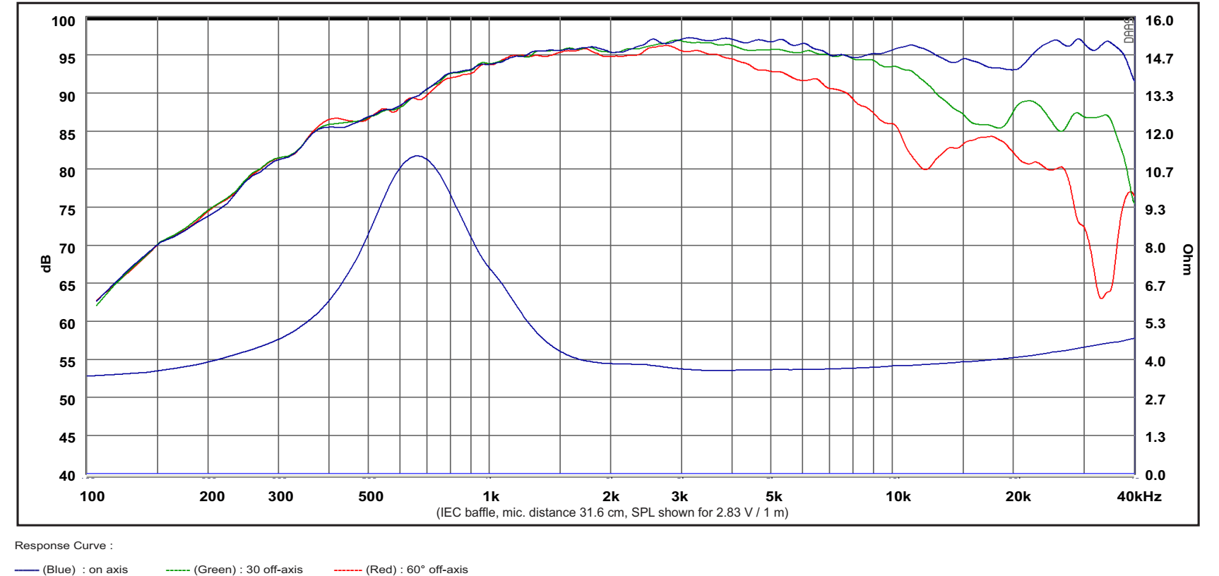

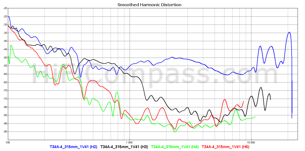

Where it wins out over the other options in general is the ability to cross low/ or use lower slope filters due to it's high xmax. And it's ability to play at really high spls without loosing it's composure.
Clearly one needs to make a choice of whats the best compromise there as those works against eachother.
Look at the distortion figures at hifi compass etc down low and compare it to the other options.
It has the higest rated sensitivity of the available non wg choices.
And it has a lighter diaphgram then them.
With a rated field strength that is unusually high, and lower inductance than the competition, which are both signs og a very good motor design.
The Impedance is nice, clean and very linear through its range.
Just be aware that with the fairly small back chamber and no ferrofluid etc, the FS is fairly high. If you want to take advantage of the ability to cross it low.
And you are using passive XO's, it will require a impedance correction to sound it's best in my experience.
It is a larger dome then the competitors so it's off axis dispersion is of course slightly worse in some cases, which is the tradeoff for a 34 mm dome tweeter.(The T34A aluminum diapgram with it's shape does as well here as most 1" domes though)
The diaphgram is also using a very minimal surround in comparsion to the competition.
As for subjective sound quality vs other BE dome tweeters i can't help as i only have the T34 B. And it would anyways be a personal opinion.
