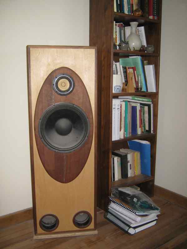

Joseph, i bet that speaker sounds excellent. It's a fostex 168 plus what? a dayton 12"... is the woofer powered by another amp? It must throw a great big soundstage. Love it!
Thanks I'm glad you like them! It's a fostex 108 with an Eminence Delta 12lf in an MLTL. They are run off of one amp right now with a passive crossover. My most recent project was a four channel amp though. I'm saving my pennies now for a MiniDSP.
