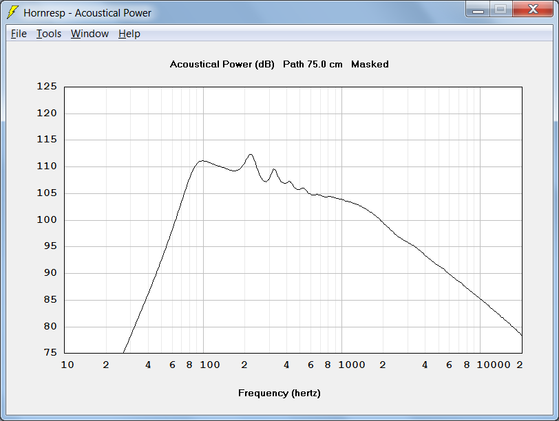

You are using an old version of Hornresp. The latest release will give you a more accurate prediction of the combined power response - see attachment.
Kind regards,
David

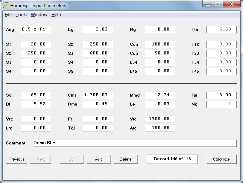

what is CC size ?
The throat chamber volume Vtc expressed in cubic centimetres (cc).
The Vtc value used in the example is 1300 cc.
The Atc value used in the example is 100 sq cm.

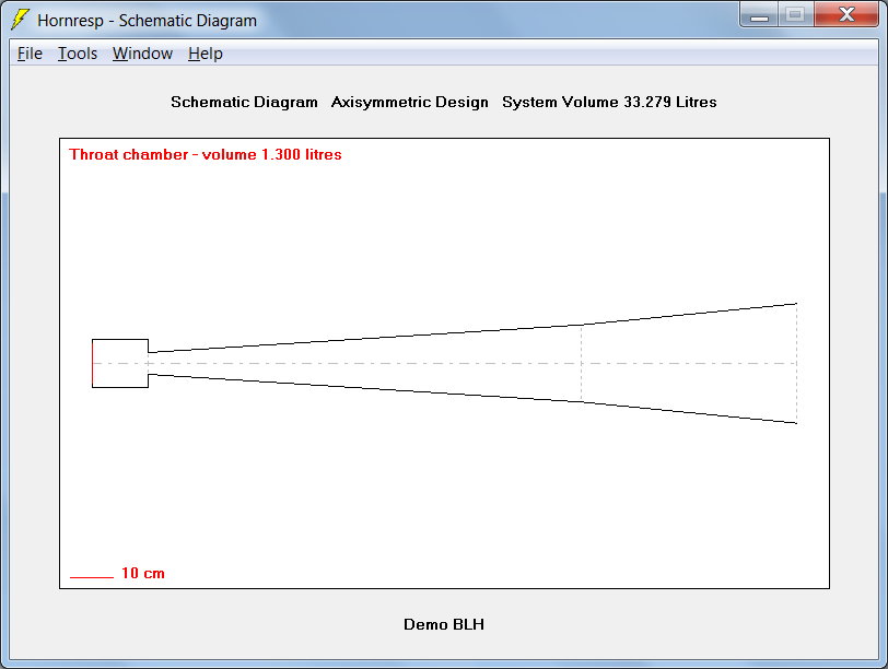

When I also got the schematic diagram it shows a rear enclosure volume of 0.9l can you confirm this with yours?
The schematic diagram should look like attachment 1 and the input parameter values should look like attachment 2.
David

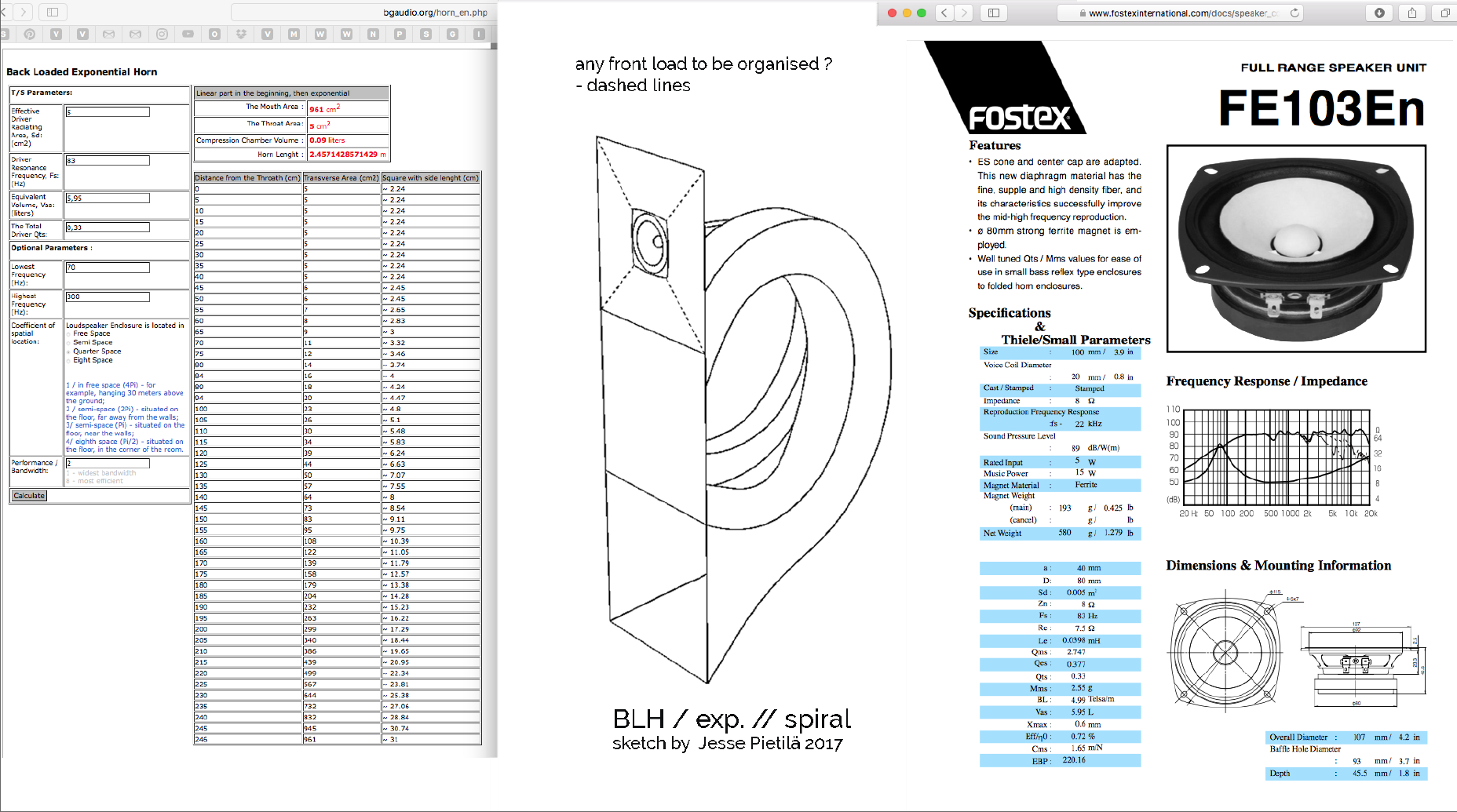

My question: how to define the sizes for the horn ?
( I have an intention for the size but how to know which is good size for certain driver ? )
Jesse
