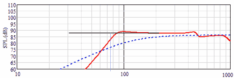

Measuring the response of a back-loaded horn in a room is a can of worms because the room dominates. Move the mic a couple inches and you can have something that looks quite different.
The sim with the FF85wk shows an F10<75Hz. How low it goes in a real room is dependent on the room and the placement in it.

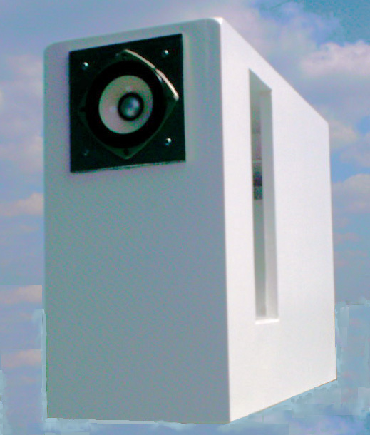

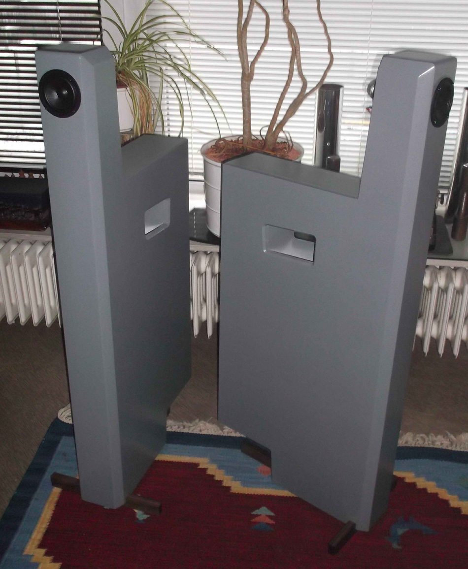

i made a few BLH for 3", i will test the 16 Ohm in a double horn with 2+2 driver.
Flute sat down to 100 Hz
or the double horns Mini-Posaune, Trombone, Kornett for 2+2 16 Ohm.
Flute
MiniPO
trombone
and new the double horn sat down to 100 Hz, driven with only 110 µF
gets a low membran movement and a superb soundstage near a wall 10-20 cm
http://www.hm-moreart.de/136.htm

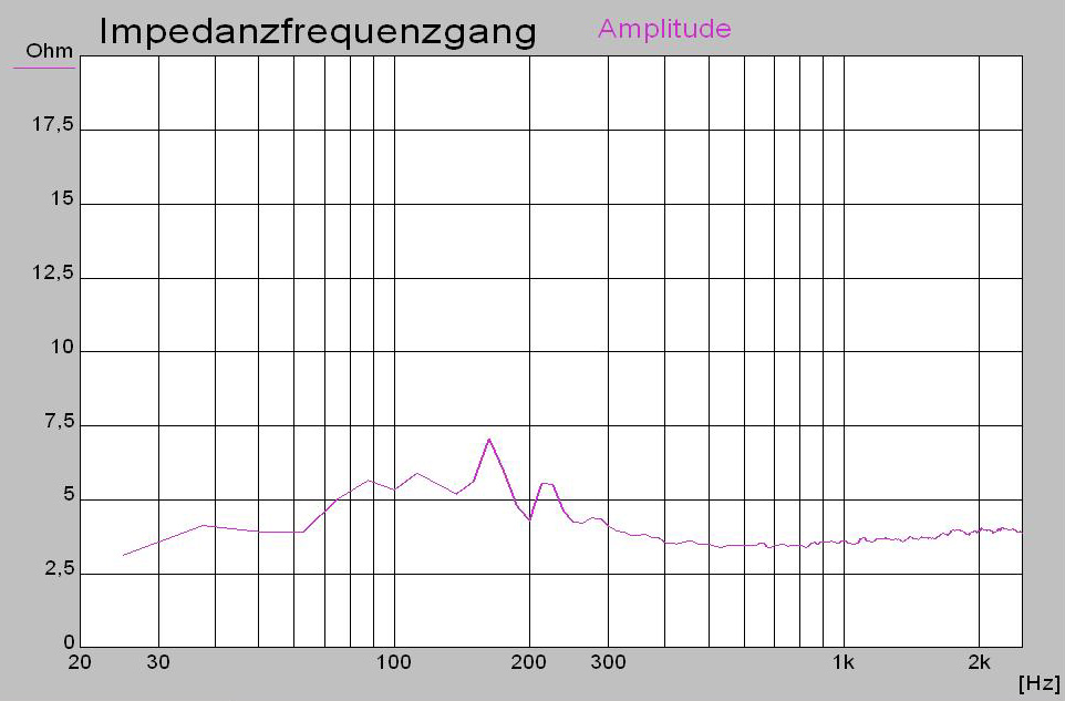

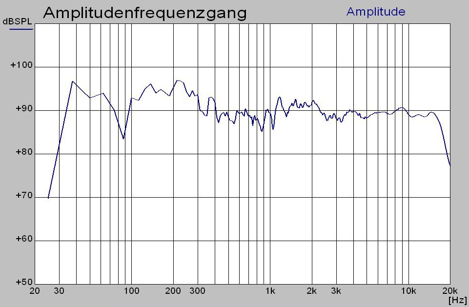

Mini Posaune mit 2 x scan speak bass down 35 Hz in my 22 qsm room,
sensational IMP, compair it with any other construction!
real measurements look for example the single simulations below the Kornett measurements

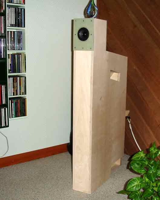

I made a BiB (Bigger is Better) pipehorn design for a small array for even smaller driver. I get bass extension to about 60 Hz with those. Due to room modes, I get better results crossing over to a multisub solution around 100Hz, but the drivers in the arrays don't mind playing to 60 Hz in this design.
7 of these Faital drivers gives a cone area of about a 8" driver, 2 mm linear x-max (did I read that right?) is a lot more than say a Lowther or a Fostex 8" drivers. Based on Fs and with some BiB rules-of-thumb, bass extension to about 40 Hz could be feasible at pretty good max-SPL.
Would not be very small, really not as small as the FH-Lite. But my BiB really surprised me. Bitter negotiations are underway with SWMBO about bigger BiB's! 😛
