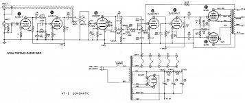

I'm currently restoring an old tube amplifier and I would like to add a bleeder resistor to the PSU for safety reasons.
I was wondering where specifically one have to insert the bleeder resistor (R3) in the PSU circuit pursuing efficiency and effectiveness (please consider the attached design). Is across the last capacitor right? Or should it be across one of the previous capacitors?
Moreover is the following procedure (posted in another thread) correct in order to define wattage and resistance needed?
T=RC , T= 5 minutes * 60 seconds = 300 seconds, C= 40000uF = .04F.
300/.04 = R = 7500 ohms. Power dissipation = E^2/R = 30^2/7500 = .12W
If you use a 7.5K ½ W resistor it will discharge your 40000uF of capacitors in 5 minutes.
Yes, just one resistor across the leads going to the amp.

Is R2 really 100K? Seems quite high but if it is 100K then R3 placed as in your diagram cuts the voltage across C3 in half. Place the bleeder in parallel with C1. You didn't specify a discharge time but I would just use 1 megOhm to get a discharge time of a minute or two. A 1 Watt resistor will do.

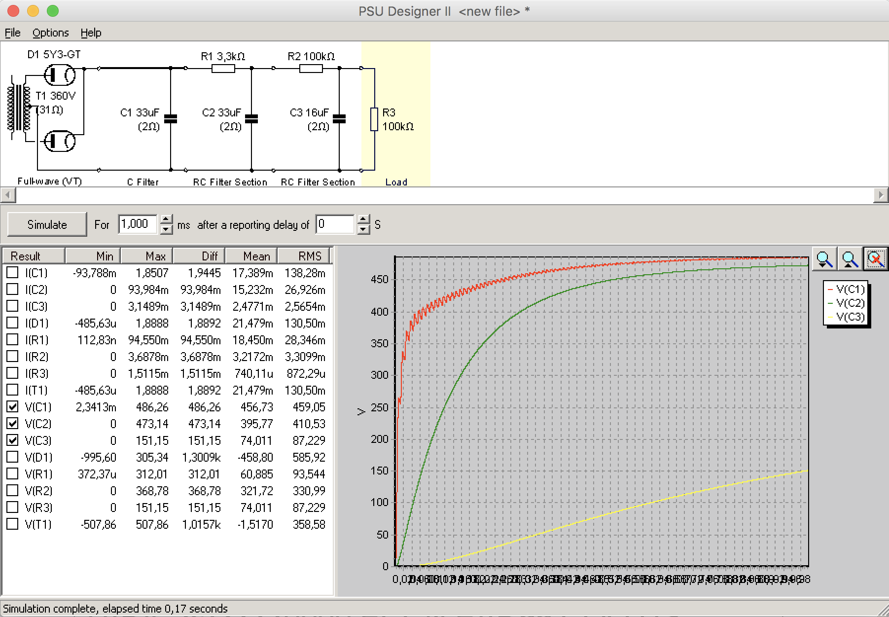

In the OP's PSUD example, the supply B+ is over 450V, and may well be made from a series connection of caps, each with its own balancing resistor - that also acts as a bleed resistor for all the amp.
You can use PSUD2 to identify the power dissipation in a bleed resistor - it can be derived from the PSUD2 rms current data column through the resistor (but based on a steady state region of PSUD2 - eg. use 1-2 seconds of reporting delay.

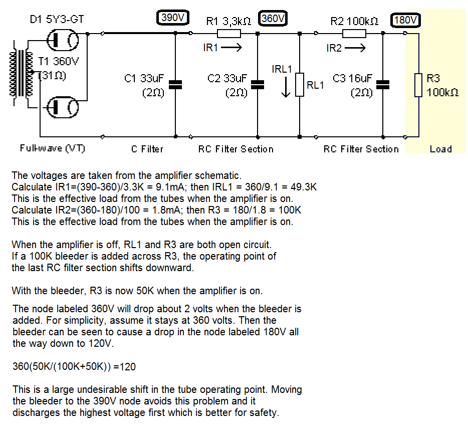

Placing the bleeder at the end is ok if the amplifier was designed for it. In this case there is no bleeder so adding one at the end greatly shifts the first tube operating point.

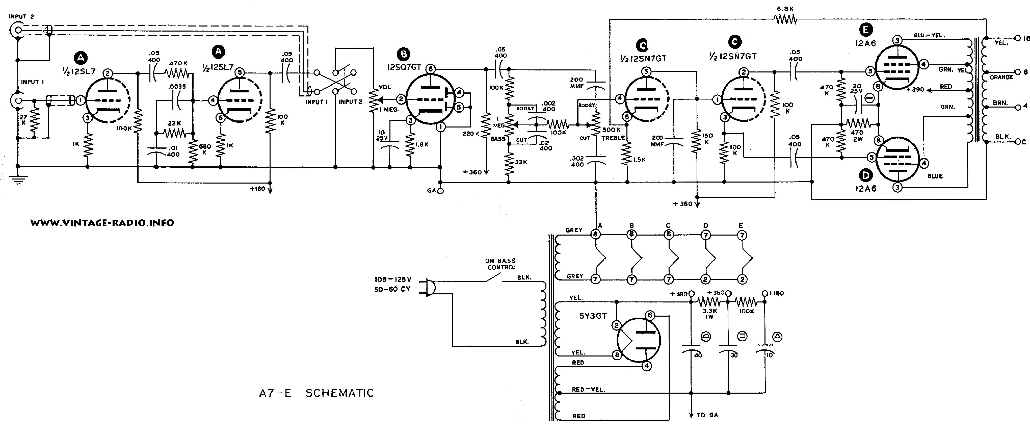

The PSUD example is inaccurate since it does not model the power supply loading from the tubes. The schematic shows 390V as the output stage B+.
Bleed resistor power is primarily a DC issue and can be calculated from Ohm's Law. High precision is not needed.
I would put 1 meg across C1 as stated in my previous message. Mouser part number 279-ROX1SJ1M0 would be suitable.

Regarding the answer to your first question that's because I recalled wrong when I written 455V (435V, 431V, 264V is most probably what I measured the first time too). Secondly, the uploaded schematic is the original one and being so it does not illustrate completely the components in the amplifier I'm working on (I already checked each component and regarding the PSU and tubes they are completely different from the schematic).
