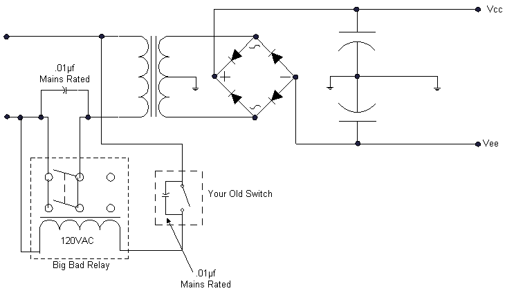

I've worked on a lot of amps with 'frozen' power switches, and these with 'stock' values of PS caps. The current surge is huge with the values of caps you are describing. Expect failure of the switch regardless of if you add a cap (mains rated!!) to the switch or not.
Since you are in there digging around anyway, perhaps consider using the power switch to operate a relay (nice, hefty one)...let the relay carry the current, not the switch. This is how it is done on a lot of high-end amps with tons of µf capacitence.

I will do some research on how to install a relay into my amplifier to 'carry the current' as you described.

I checked the schematic and the switch in the amplifier has a 'spark arrestor' installed across the switch. Is this the same as the cap you were talking about?
Would you be able to suggest what kind of relay to use and how to hook it up? Any help would be appreciated.

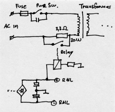

Like this:

While at it, why not bypass the relay contacts with a nice 20W resistor, put the power switch back in series with the relay contacts and use a secondary rail to power the relay. This will make a nice "soft start" circuit - your caps and rectifiers will live longer.
To cure the popping sounds during power up and shutting down, you can add a speaker protection circuit with a second relay.

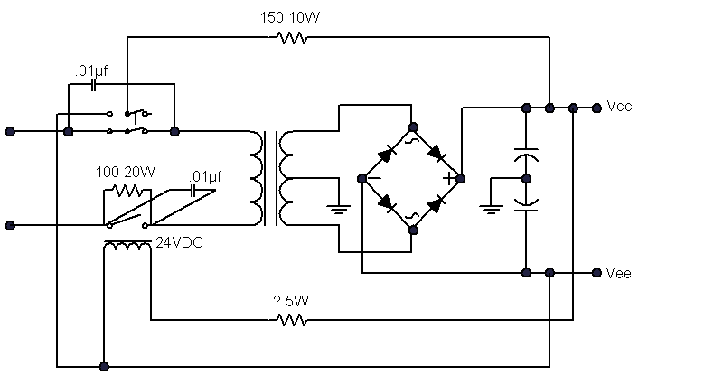

This circuit does as you described AMT, but adds a capacitor discharging resistor (the 150-ohm 10W at top) for when power is removed (as long as the power switch is at least a DPDT, this can be used).
All Elecronics has a 70-amp 24VDC relay here. It draws around 80mA, so I thought it wise to steal the voltage from both the pos and neg rails, as well as increasing the series resistor to 100 ohms since taking voltage from both rails means that the relay will turn on too fast with a 3-ohm resistor. The unknown resistor value of course will be determined by the rail voltages.
The 100-ohm 20W and 150-ohm 10W can both be had very cheaply from Parts Express. If I was going to do this, I might even try a 680-ohm 20W resistor and see what kind of delay it gives me. Probably too much, but PE selection of 20W resistors is kinda lean. Other values would have to be sourced elsewhere (Digikey).

Sounds good, although a longer delay is not necessarily better - the series resistor might easily be overloaded, even if its rated for 20W. The circuit above or varations thereof is used in many commercial amps with toroids (Accuphase and others).
Btw, we both forgot about the flyback diode across the relay coil.
