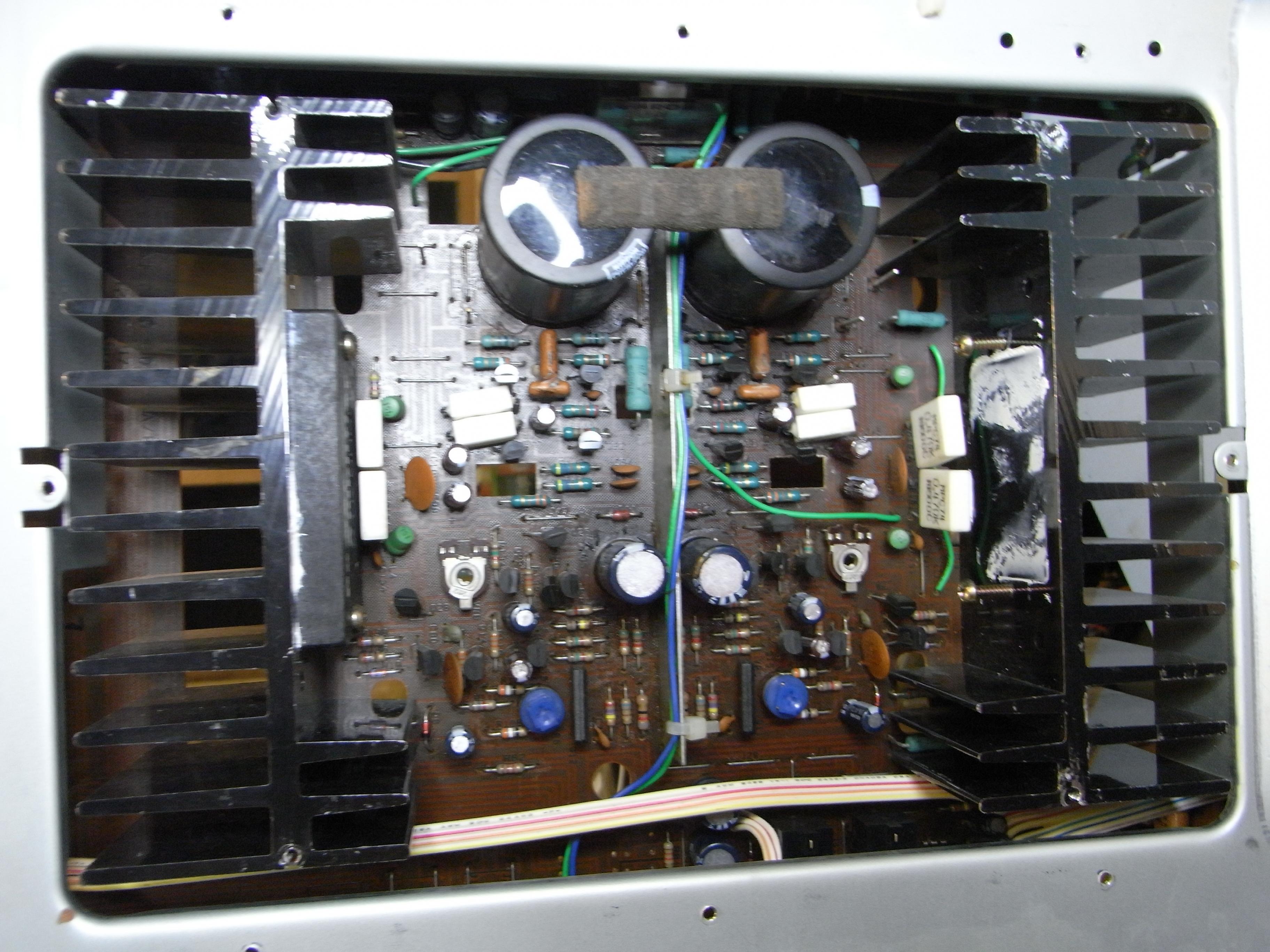

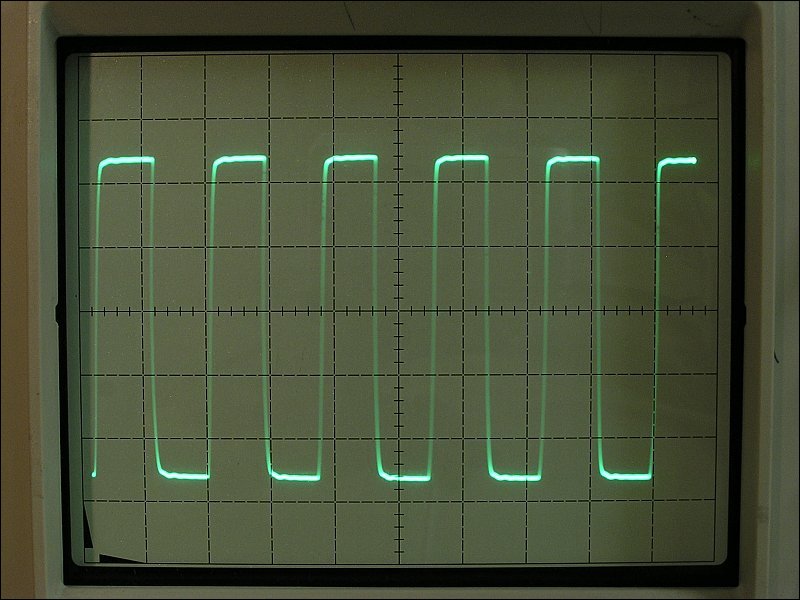

On the attached pictures you can see, that they did their homework on output stage design.... Split feedback for the VAS and current amp stage, critically applied phase correction and speed-up components at all place.
Even that old Darlington power pack does its job in an excellent way, this thing reproduces 40 kHz square waves perfectly, without overshot and ringing.
After all, I am curious about some expert opinions from you, any comments advices, criticism concerning the design?

"this thing reproduces 40 kHz square waves perfectly, without overshot and ringing".
A square wave has all harmonics of the frequency produced and they are present on the top leading edge of your wave form and presents itself as ringing. I suspect you are hearing harmonics, which sound satisfying to the human ear. How fast is your oscilloscope?

You forgot to say: two transfomers, one for each rail ( for keeping the height of the case low ) ; The two caps after the rectifier, I'm still keeping them in another amplifier and they're still fine.

The scope is a Leader 1041 dual channel 40MHz scope. Well, the load is an 8 Ohm power resistor, the amplitude is 10v p-p. With a speaker it could be different, but I am not risking feeding my speaker with such a signal.....
The power pack is a STK 0060 II 8A Darlington array, the tone stage is defeatable, (replaced with LM4562 just in case) the input RCA-s feed the power stage through the selector and the defeat switch, with nothing else in the signal path

Do I see a common-mode bootstrap in the input stage there? Cool.
Unfortunately these amps enjoy a reputation of being notoriously unreliable, mostly due to running hot. Apparently they often had to be run at reduced bias to avoid blowing up (again).

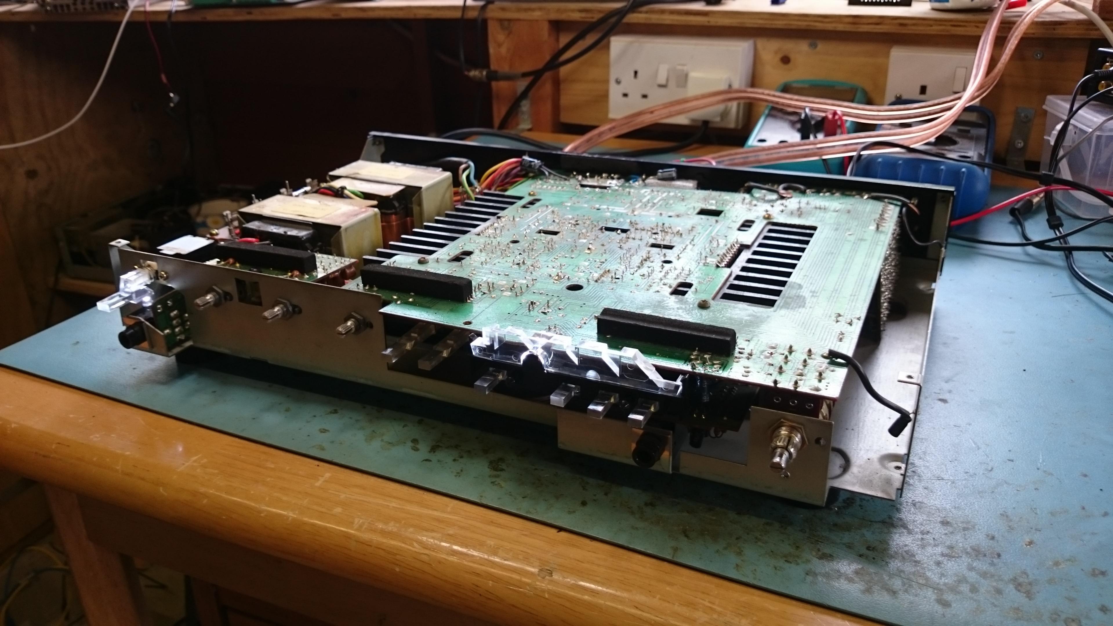

Going through a bit of a TRIO phase at the moment and picked up a spares or repair KA-80 off the bay. It was a bit of a pig to fix, usual blown Darlington power pack but someone had tried to repair before and introduced a solder short elsewhere in the circuit. It was so nice to hear the speaker protection relay kick-in when I finally sussed that one out. As mentioned, these amps run hot because of the high bias and the inverted PCB design so I replaced all the low value caps with high temp versions. While I was at it, I replaced the unreliable filament display bulbs with white LED's - this also helps to reduce the internal heating because you get rid of the high wattage voltage dropper resistors and give more power to the amplifier.
I completely agree. This is a very good amplifier, great bass, very detailed with spine-tingling dynamics. Its just a shame that there are probably so few of them running now that not too many people will get the opportunity to experience.

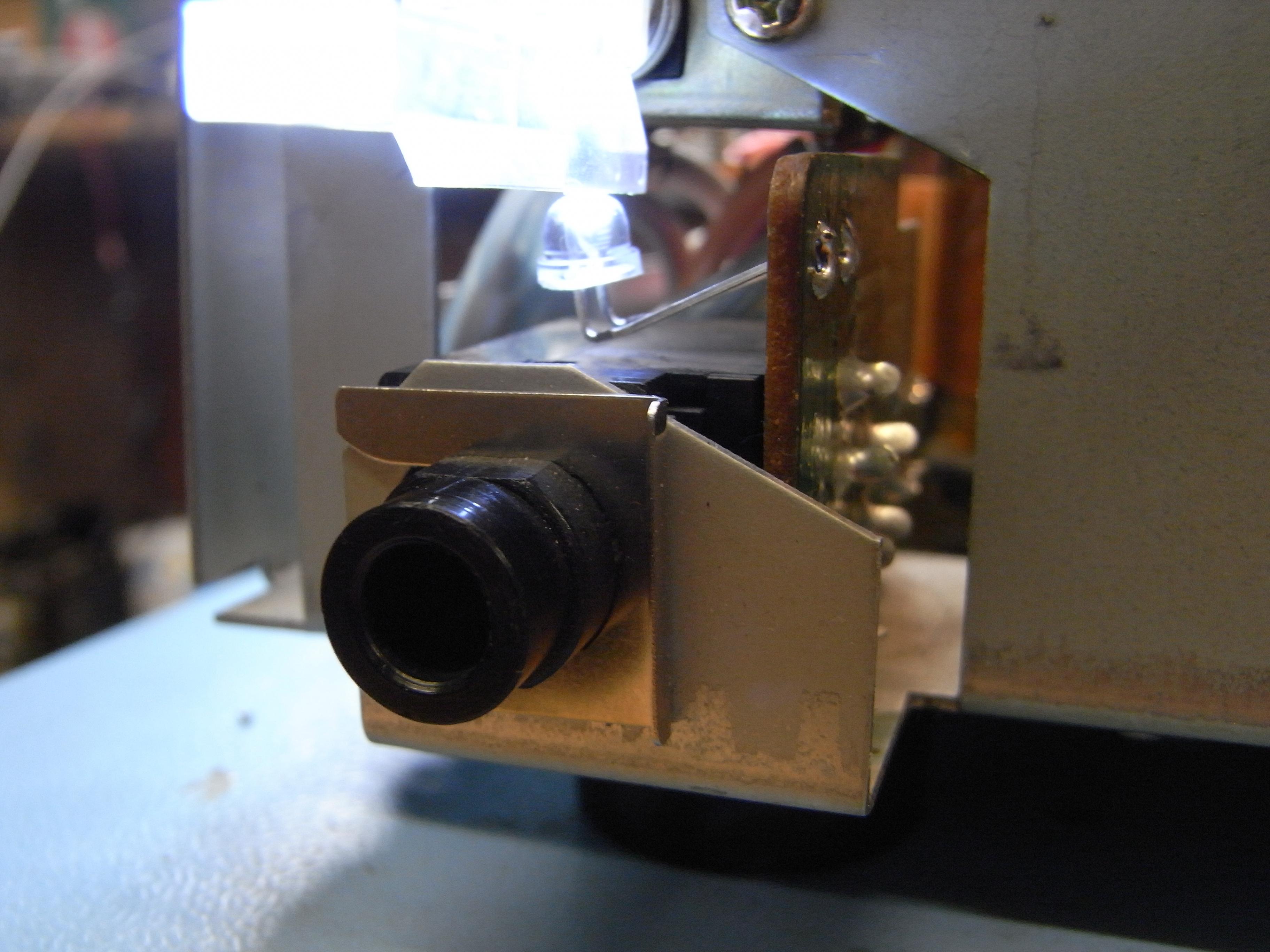

Great idea about replacing the light bulbs with white LED-s! Now the power transformer gets definitely less warm after a few hours of use. If you have the patience and the necessary parts, it is definitely worth to do the fast rectifier and supply cap replacement mod mentioned in the starting post.. The sound gets even better, cleaner than before.

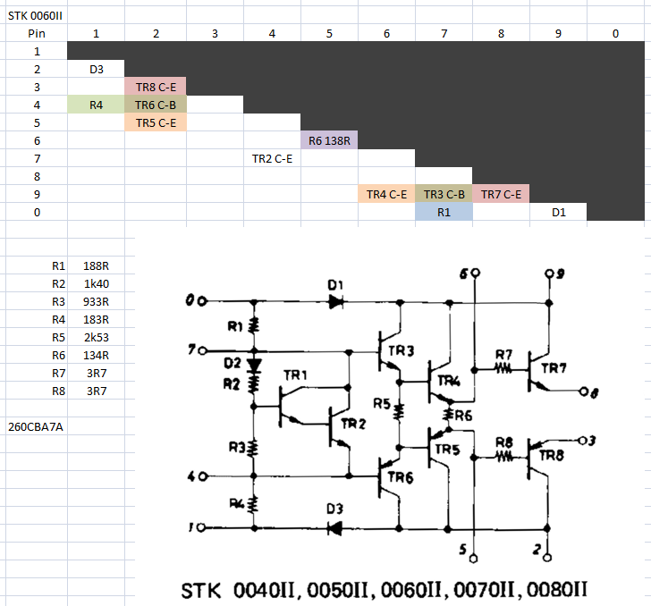

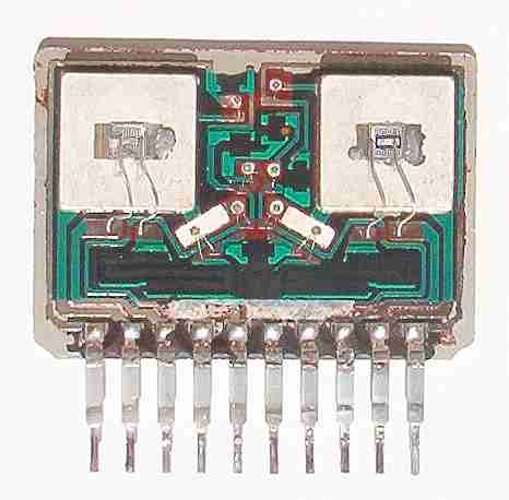

STK0060 II family internal schematic and pic of one I took apart.
I have datasheets and app notes for them. Usually their bonding wires open-circuit (tap it with a plastic pen) or the transistors short.

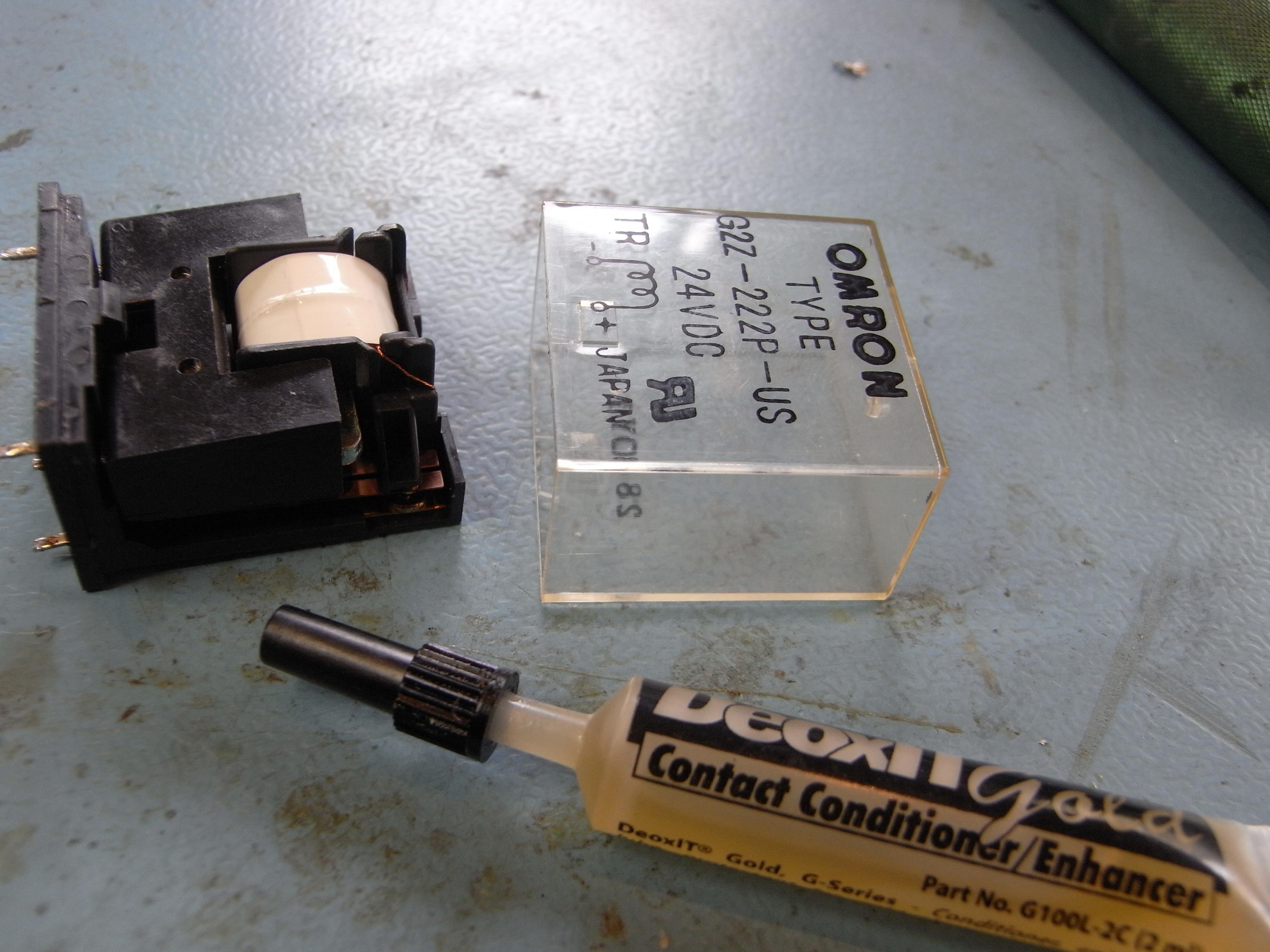

For the output relay, I use a piece of paper to scrub off oxide on the contacts.

Since you've one already dissected, is there any chance that you could measure the resistance values? That way it could be rebuilt on a similar size PCB.....
Prairiemystic, interesting to find out the design difference between the STK0060 and STK0060 II, quite significant by the look of it. I guess, the unused pins on the STK0060 are not connected so in the KA-80 design, you wont get the benefit of the circuit design. Have you been able to fix faulty modules? How easy is it to remove the cover?
